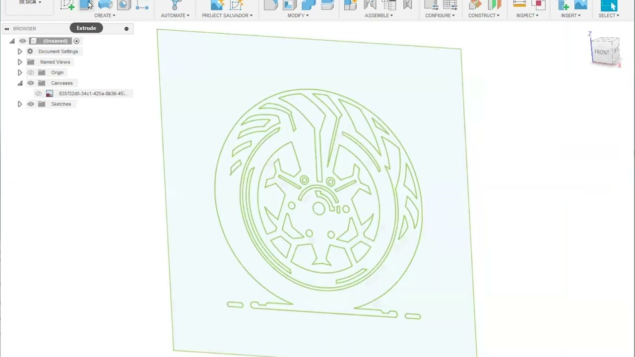

I just tried the Canvas to Sketch and it worked great.

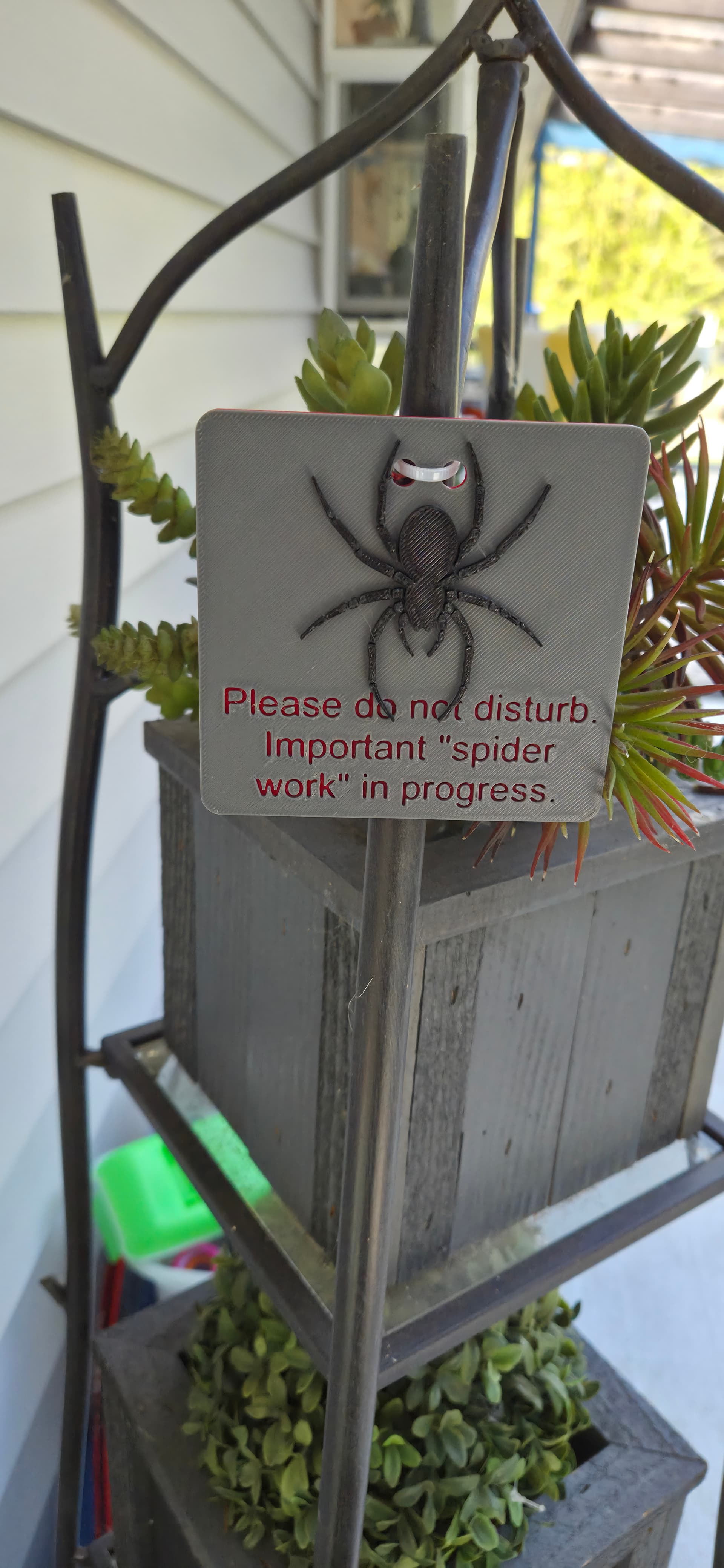

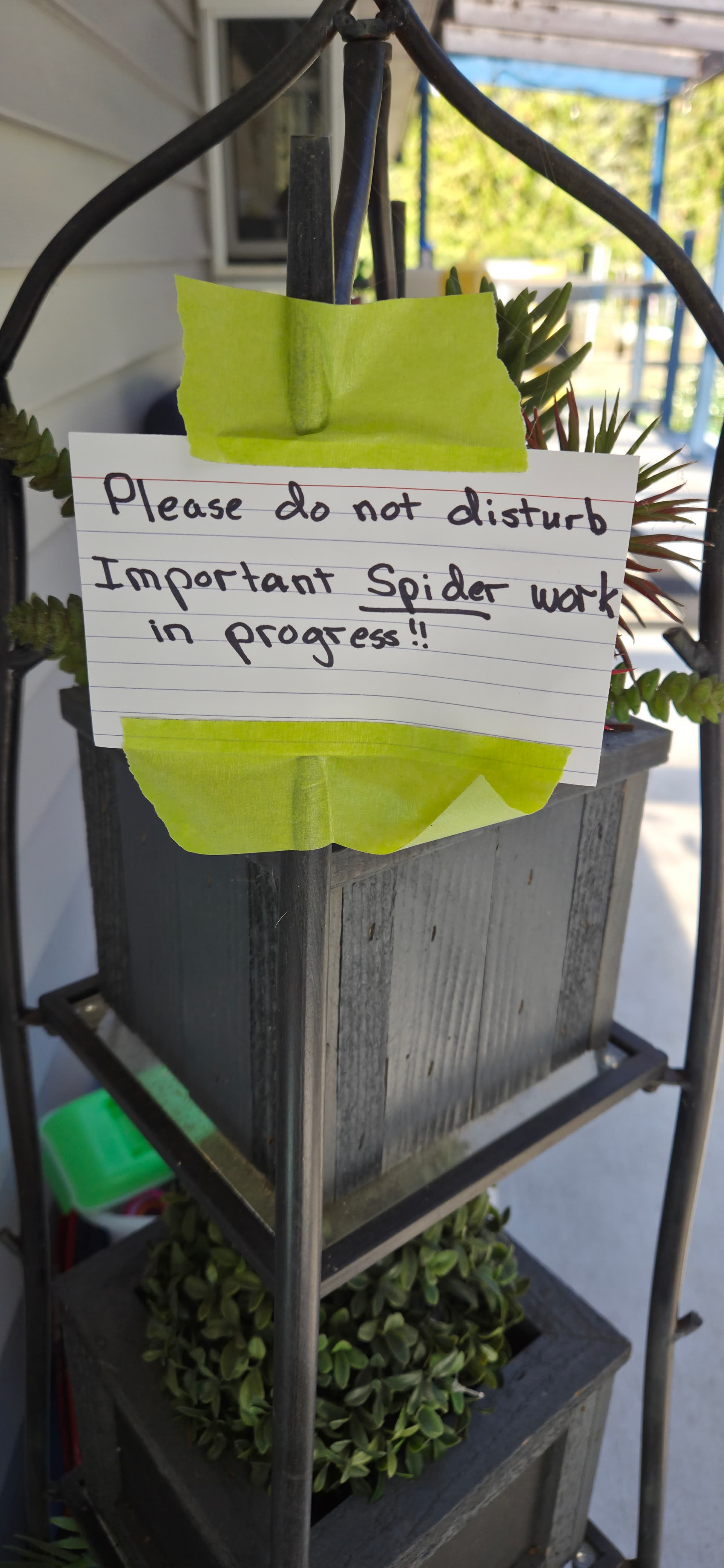

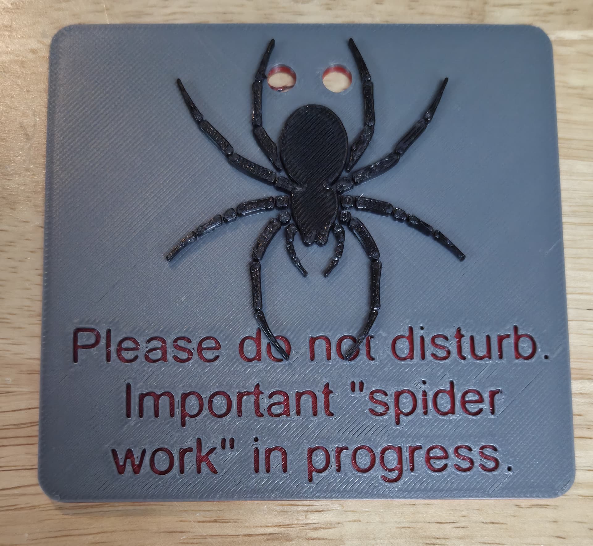

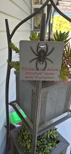

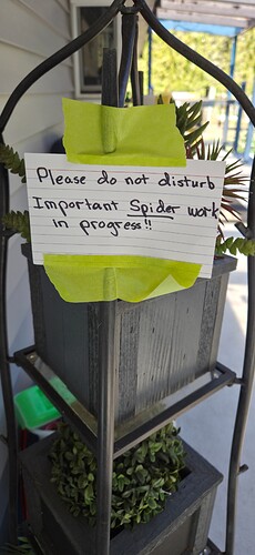

Here is my wife’s sign at our front door:
For a number of reasons, it catches your attention (awkward silence…:rofl: ).
I tell her (or imply) “I could print your a 3D sign???” Well, she is kind of lukewarm about it. I suppose she is afraid if I go to all that work and she does not like it, will she still have to put it up? Like all those crayon drawings from preschool???

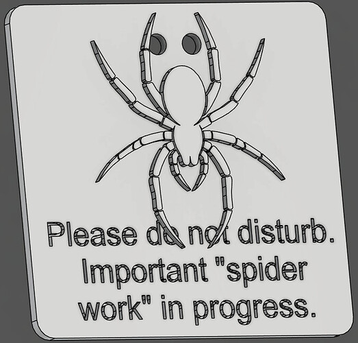

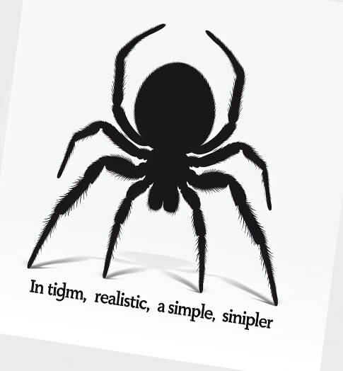

Then I asked “no hair” and “realistic”. Voila:
That worked flawlessly:
