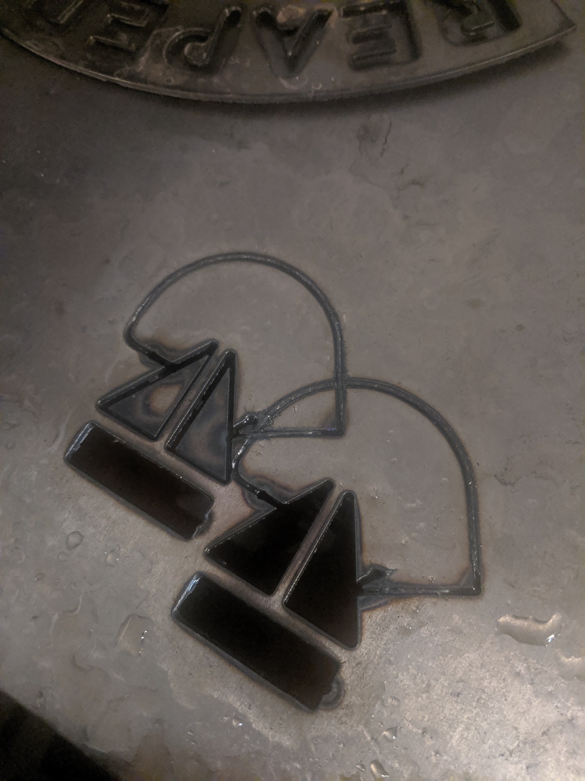

So when I go to cut multiple parts or a bunch of letters sometimes when the torch is supposed to stop firing and then move to the next letter is just does the rapid move while still firing. I can’t figure it out. It seems random. In the photo it is supposed to cut the two triangles first and then an inside cut of the rectangle. For some reason when it moves from one triangle to the other the torch stays on. I have also attached the g-code, maybe the issue is in there.

So I figured it out. Make sure the Razor weld 45 is in T2 not T4. Does anyone know what the “T” means?
4T is for cutting expandable metals, It sets the timer so the arc stays on longer.
2T is a simple on/off. Press the trigger and hold it - the arc fires until you let it go. 4T will fire when you pull the trigger & let go. To turn the arc off in 4T mode you pull the trigger again. Since Mach is using the M3/5 commands for spindle on/off M3 is like pulling & holding the trigger and M5 is letting it go.
