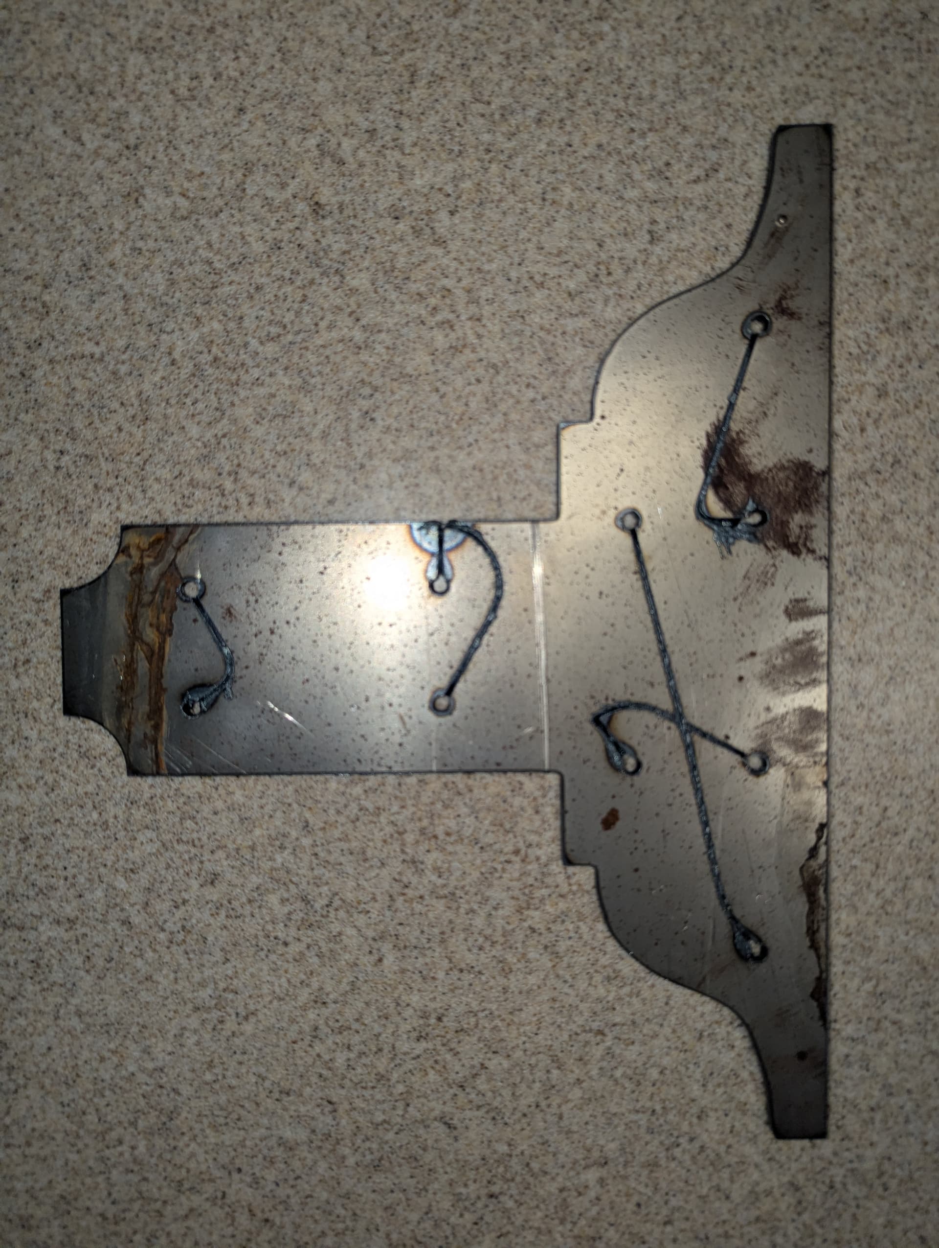

-Now the moment of truth: will this setup actually cut a project. I setup a piece of scrap 1/8” plate on the table, setting the origin point with the torch in Mach 3, trying to minimize waste. I imported the g-code for the T bracket. I setup the Cut 45 based on the Jasic cut sheet parameters for 1/8” mild steel at 45amps at 165 speed (split the difference between .105 and .130 thickness for the speed setting as there was no .125 recommendation) . After checking and double checking everything , based on the Legacy video’s, I pushed the button and let her rip! She came alive and started spitting fire, the torch moving around and cutting the Bracket as programmed; pretty cool to see finally! When the torch came back to the starting point, it seemed to continue to fire for a few seconds longer than it needed to, then the flame shutoff but cooling air blew for several seconds. I shut off power to the Cut 45 and pulled the cut Bracket off the table to check out the result. Here’s what I found:
The bracket shape looks great, but the holes not so good and as you can see the torch path from hole to hole was partially gouged into the plate, though not total blow through. Any ideas what caused the track gouging? The outside edges of the bracket cut pretty smoothly, except for the start/stop point. I saw no lead in or lead out with this cutting. I’m thinking I should cut back the amp setting from the Jasic cutsheet recommended 45amps to somewhere between 30-40 amps. That might help with the raggedy small hole cutting eh? What do y’all think?

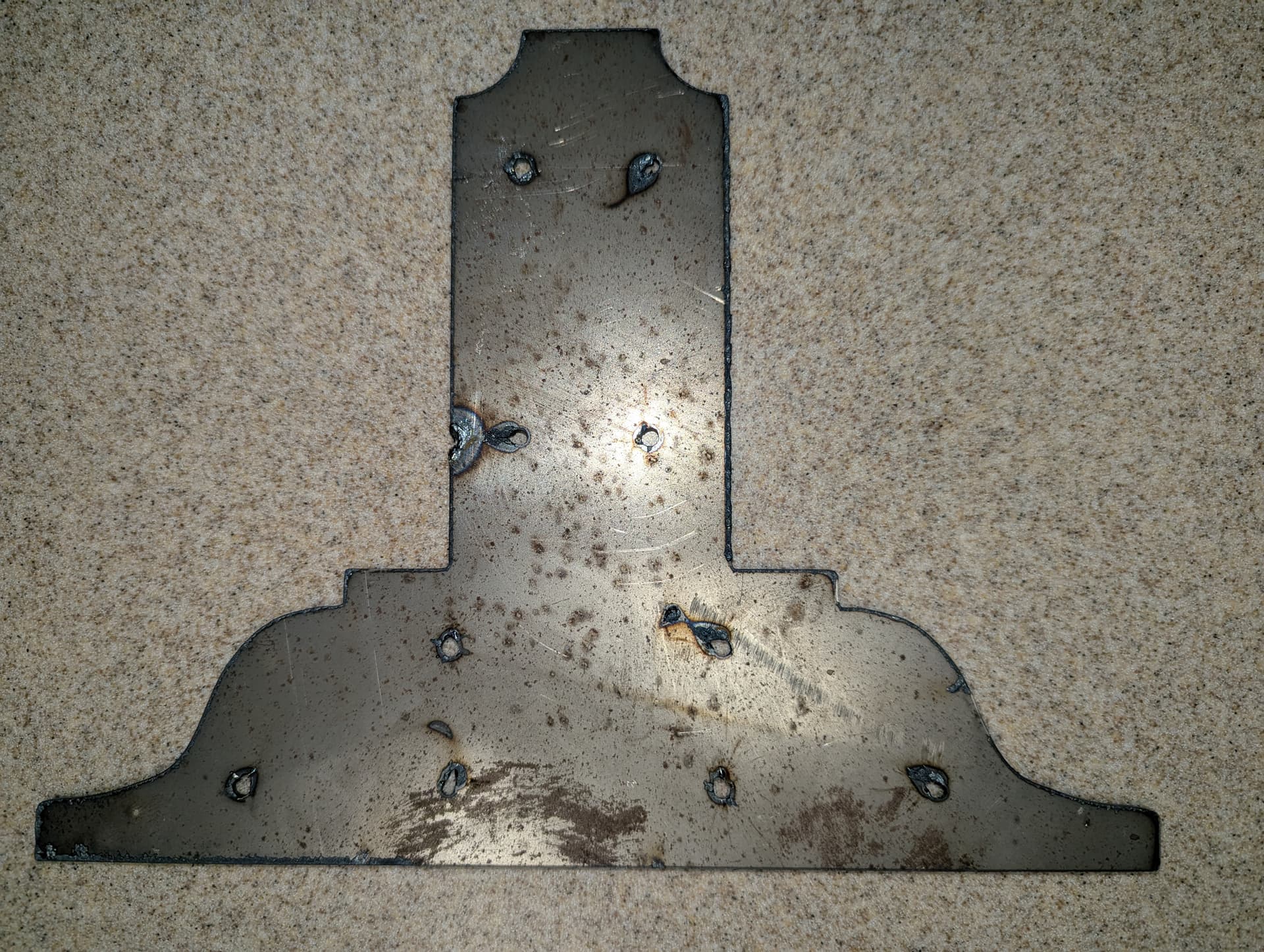

Here’s the back side. You can see the start/stop spot on the side edge and the irregular shape of the small holes with some slag. There was a bit of blow through from the torch tracking gouges seen on the other side. I’m assuming that lead in/lead out in the g-code would take care of the side cut issue. Thoughts/recommendations?

Thought I’d share a few things I figured out about the issues I reported in my last post, so fellow newb’s can learn from my mistakes:
This was a simple fix. Turned out I didn’t have it on the 2T torch control setting on the Razorweld Cut 45 box; it was on 4T. Made the switch to 2T and on my last test cut of the same bracket the torch fired and shutoff as it moved around the pattern as it should.
This was caused by the 2T vs 4T settings problem.
This was due to the cutting tip being wallowed out a bit to the side of the orifice. I didn’t even look at the tip before making the first cut (duh)! This tip had been used before by the previous owner and it definitely needs changeout. I ordered up a bunch of consumables for both 30A cutting and 45A cutting; got a pretty good education on tip sizing and consumable wear searching through this and other forums.
Thats it for now. Waiting for my consumables to come in then the plan is to make some cut plates at various metal thickness’s and settings to see what works the best in various conditions.
