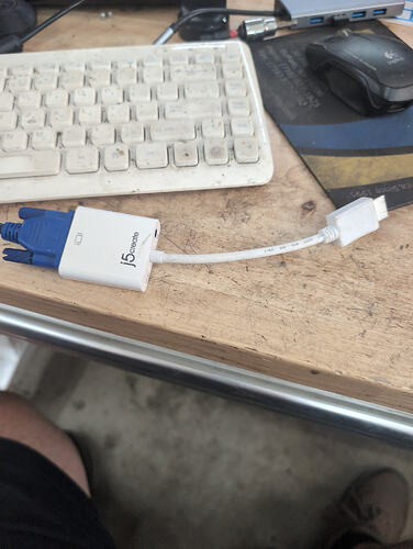

I had that trouble when I very first started about 5 years ago… Someone at Langmuir helped me figure it out then but I had long since forgotten it.. Back then I was using a desktop and there was some sort of interference being created by the desktop I switched to a laptop and everything worked according to plan… Yesterday I reorganized my desk using the same laptop that has worked for the last several years.. once I moved things around I started experiencing the same difficulty.. torch fire strong, moves about a quarter of an inch and stops… When I reorganized. I decided to put larger monitor into the system… That did it!!!
… Once I removed the monitor, all was good again… It took me 6 hours to figure that out this morning/ afternoon.. I’m not sure if it was the monitor or the adapter… I was using a HDMI to VGA adapter… So it could have been either or both of those things… Hope that helps.. JD
