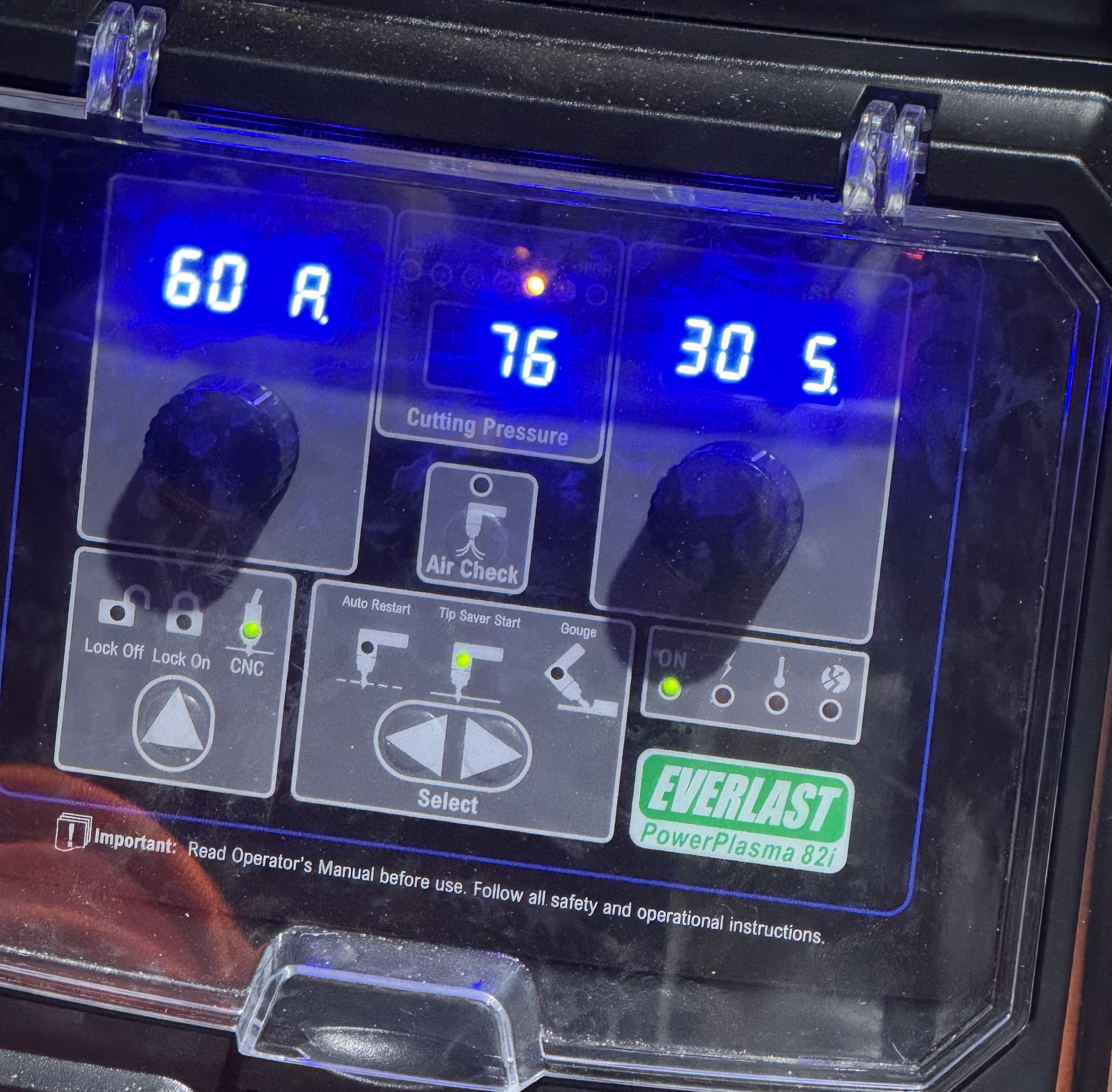

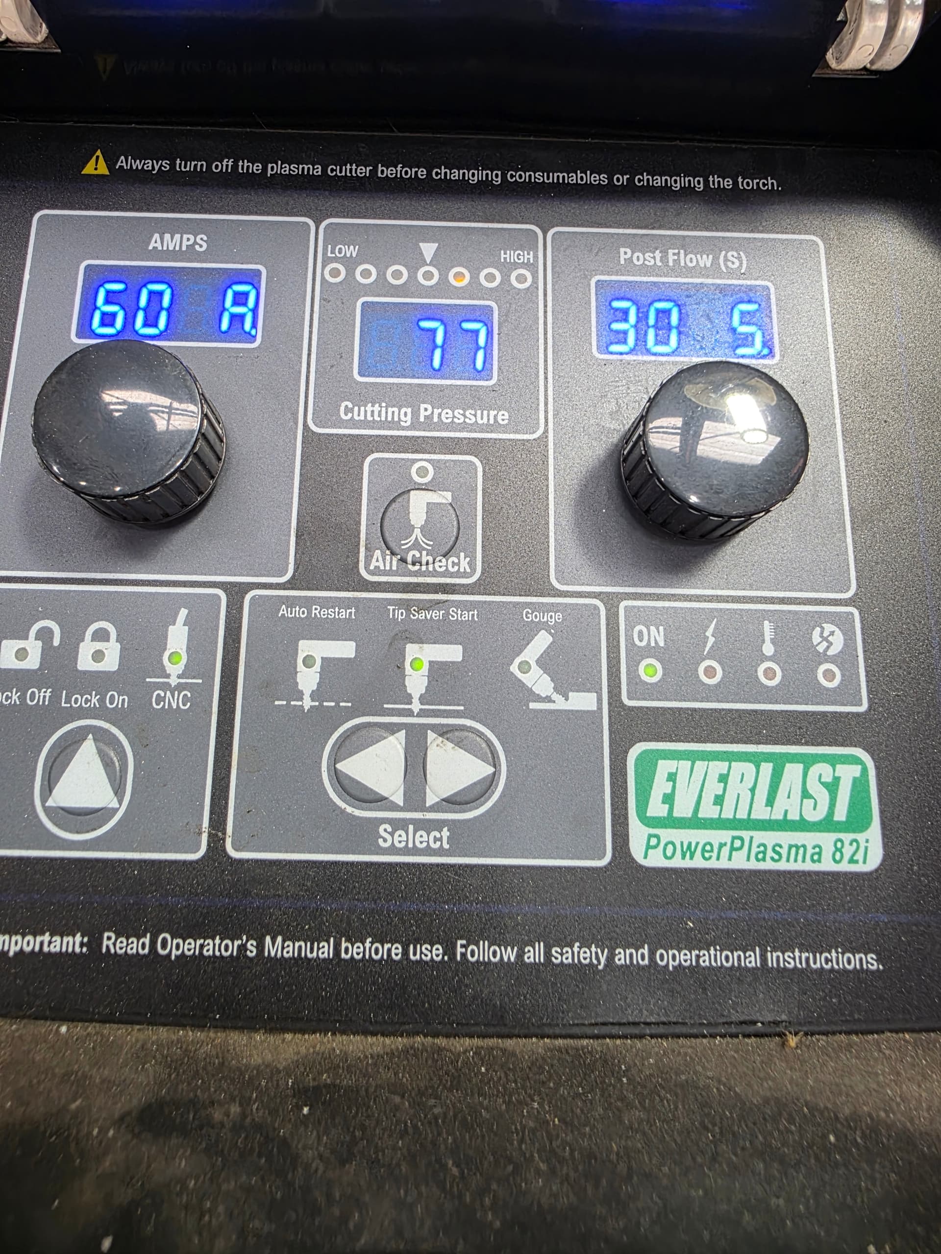

What PSI are you running at the plasma?

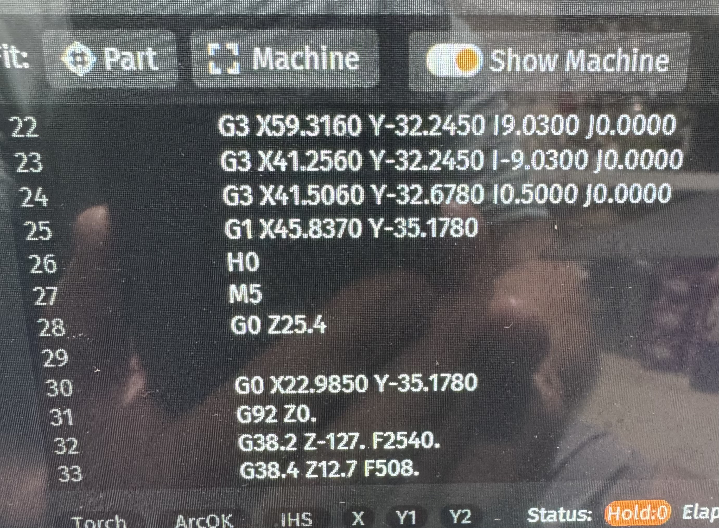

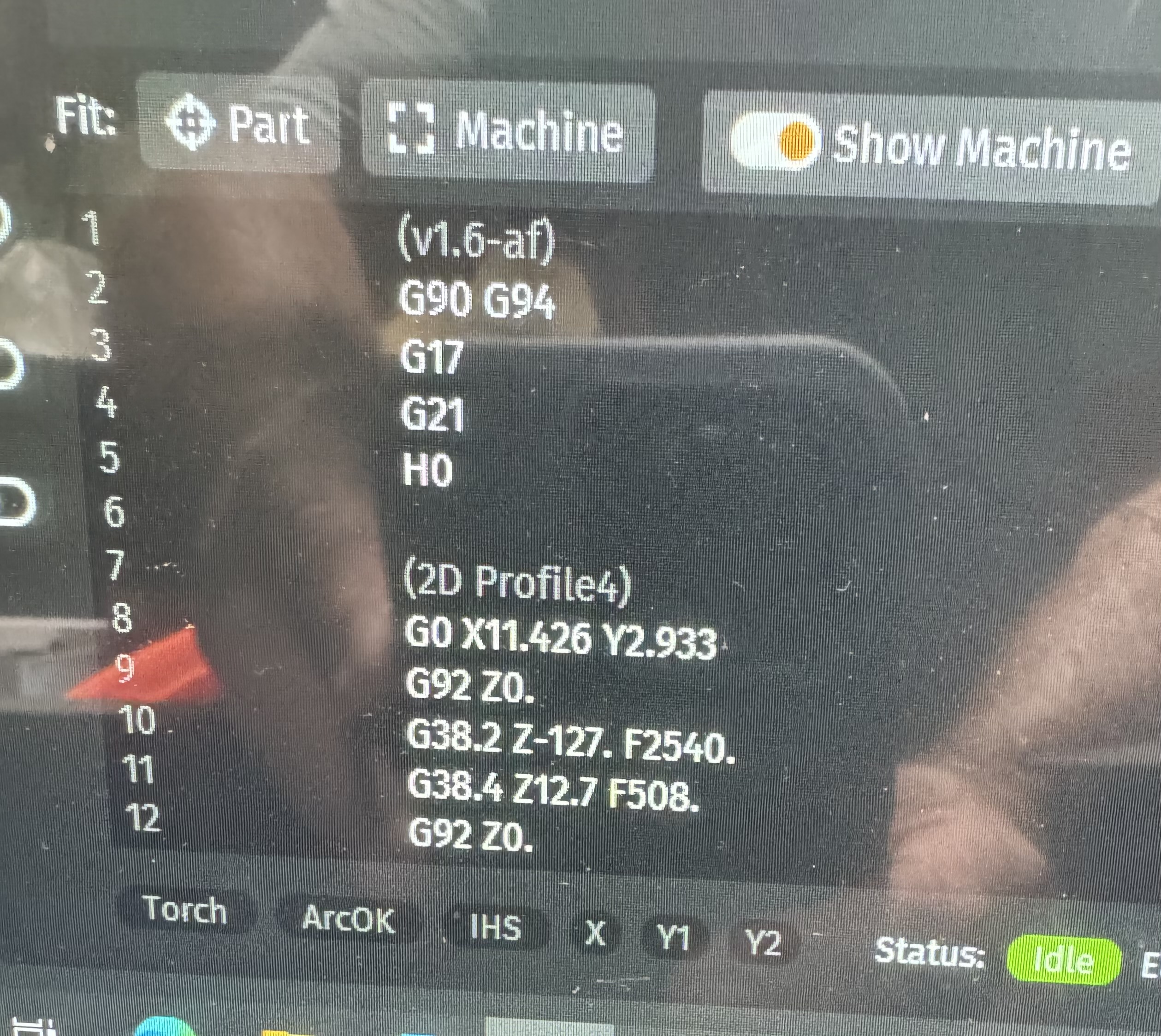

Open the g code with a text editor like notepad and copy and paste the first 20 lines in a post on this thread. That will make it easier to see if this is a programming issue or something else.

The air pressure I am using is 64 psi

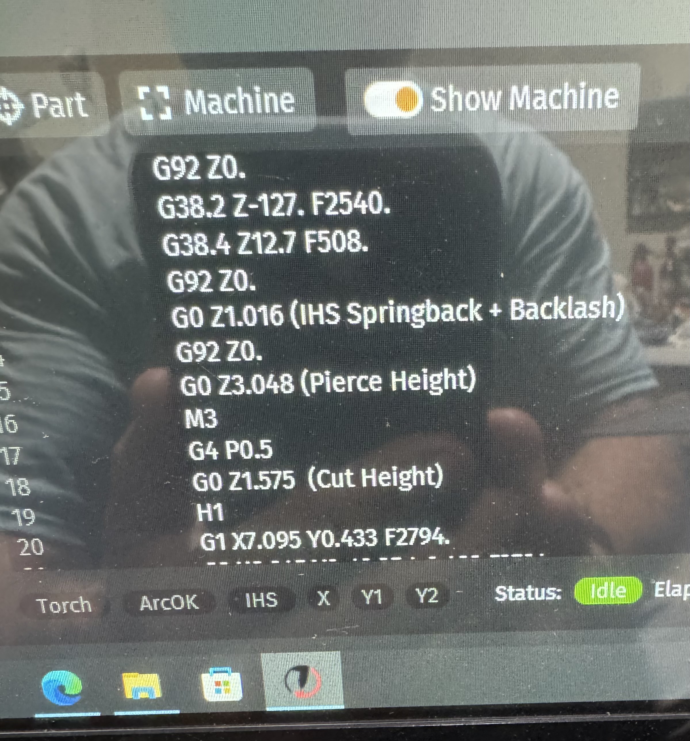

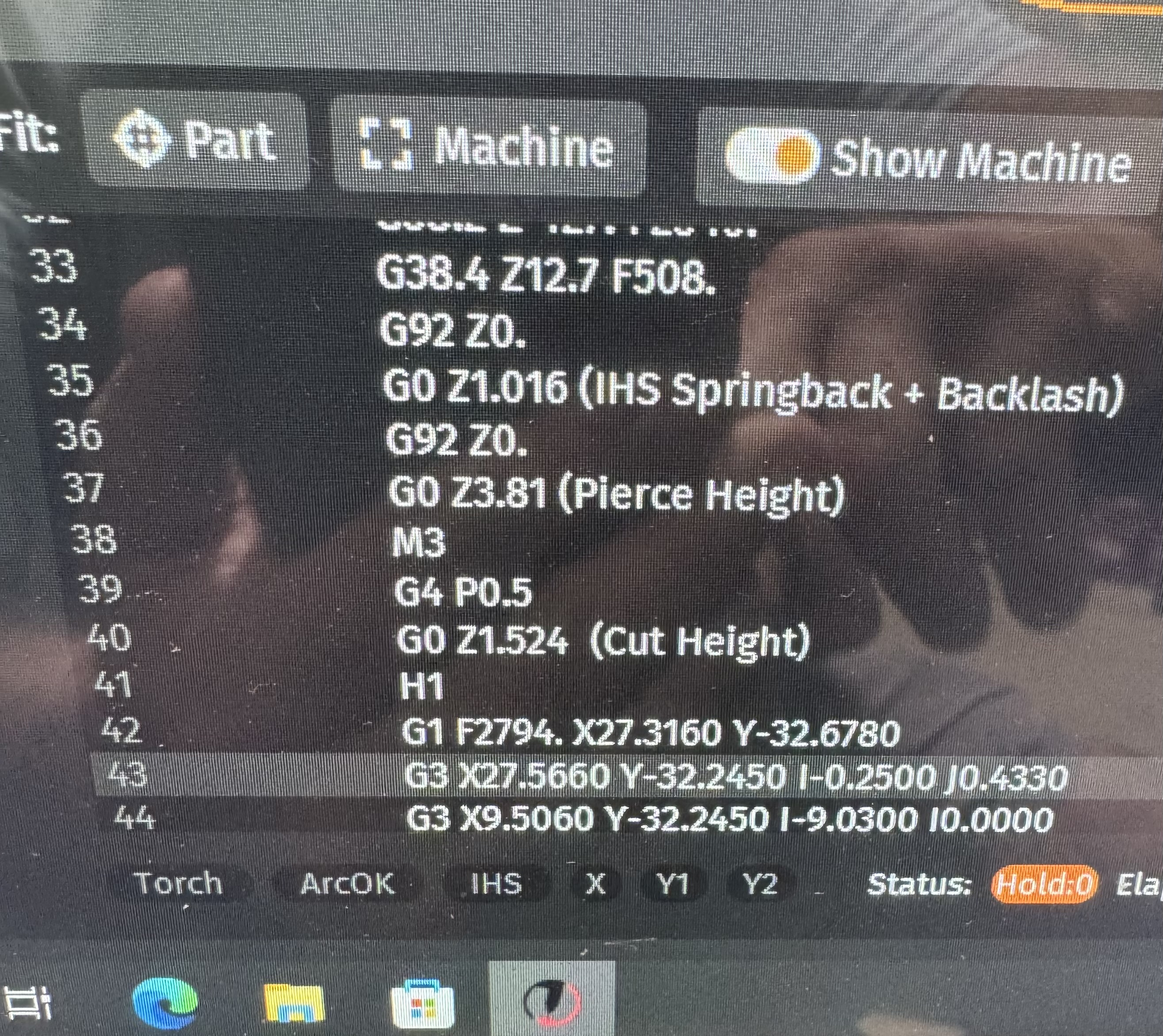

It appears it stopped on line 43. Pictures show G code lines one through 49.
I also tried anywhere from .1 sec to 1 sec
Air pressure must be set to a minimum of 75 psi. The torch will not fire consistently at 65 psi, as it requires the proper air pressure to ignite the pilot arc. Set you pierce height to.12 you have it set .81, set the cut height to .062.

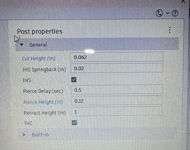

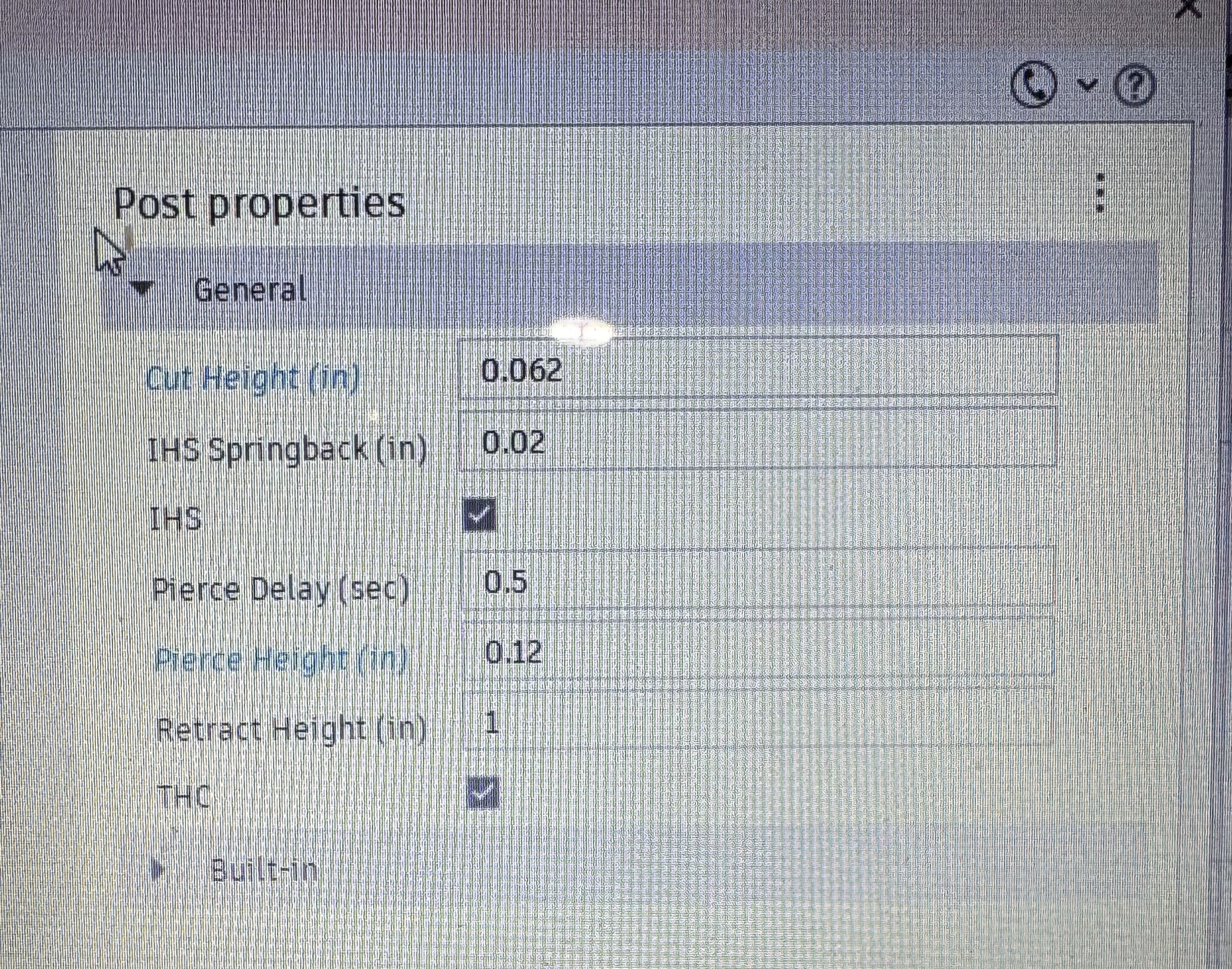

Make sure the cutter set to theses settings
CNC and TIP SAVER. SEE MY FRONT PANEL

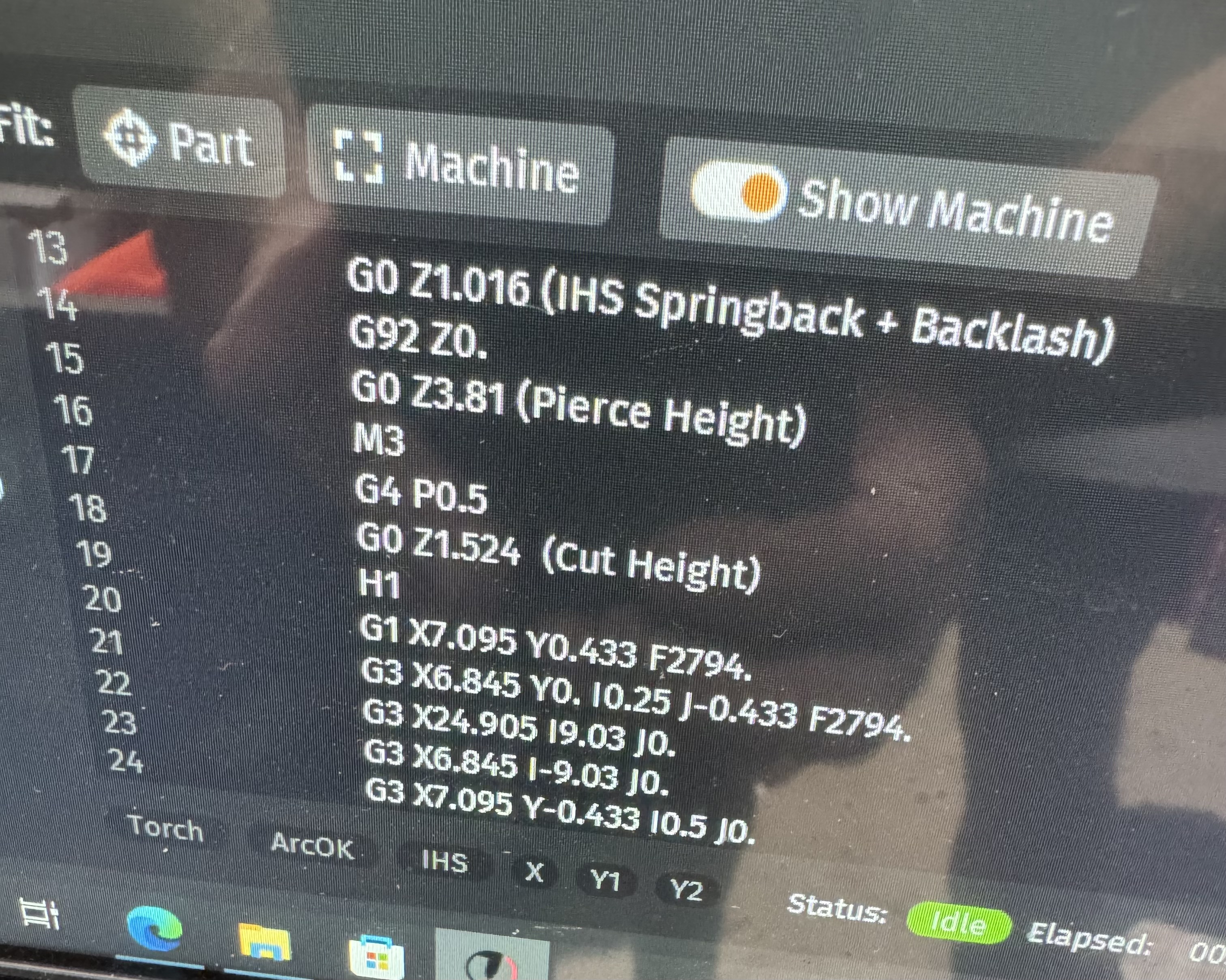

After entering the settings you suggested in fusion 360 post, then transferring the G code file to fire control, you can see it enter a different cut height and pierce height numbers.
After making these changes, the torch went to profile one and went through the torch height control, but the torch did not fire… The error says THC unit did not detect arc voltage when the torch was commanded to fire. Your program was paused.
I don’t understand that. Email Langmuir to see if it’s a bug. Mine are exactly what Fusion has set them.

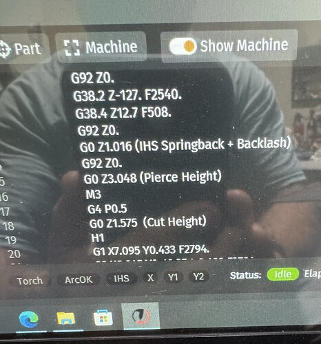

All of your units are in metric in the code. You must have selected metric output in Fusion and it’s converting all of your values to metric in the code.
The outgoing units were in millimeters and I was working in inches. Now the G code reflects the correct numbers and units. Now the unit is just not firing off when commanded to.
That was the case. The outgoing units were in millimeters. Now the numbers in G code and fire control reflect the same as in 360.
Try setting your air this way. Air to the regulator 100 to 120psi, turn the regulator all the way down till it reads 0. turn it up some and set your cutter to air check, then turn it till it reads 75psi, turn off air check.
