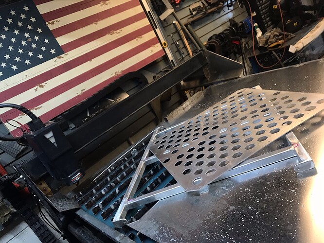

Running into similar issues today. we were running some 3/16 aluminum . and just loaded a 4x8 of .090 alum. its cutting a bunch of hex patterns and the pierce is pointed to pierce .10 inside one corner of a 1-1/4" hex . with an arch lead that stops at the corner then runs inside cuts. Touch touches off .1 delay then moves with no pierce and arc starts 1/4" after the hex corner. We have seen this in the past just don’t remember how we fixed it . Thinking remove that guard and tie it off or remove it . Make sure the touch off SW is clean as well as the shafts rollers. Seeing same results with a brand new cartridge. Aluminum can be messy throwing debris up maybe we run the silicone boot on it, but all that debris will likely be loading up cartridge more than we want . We have already run 4 full sheets of this pattern so something just started tripping us up.
