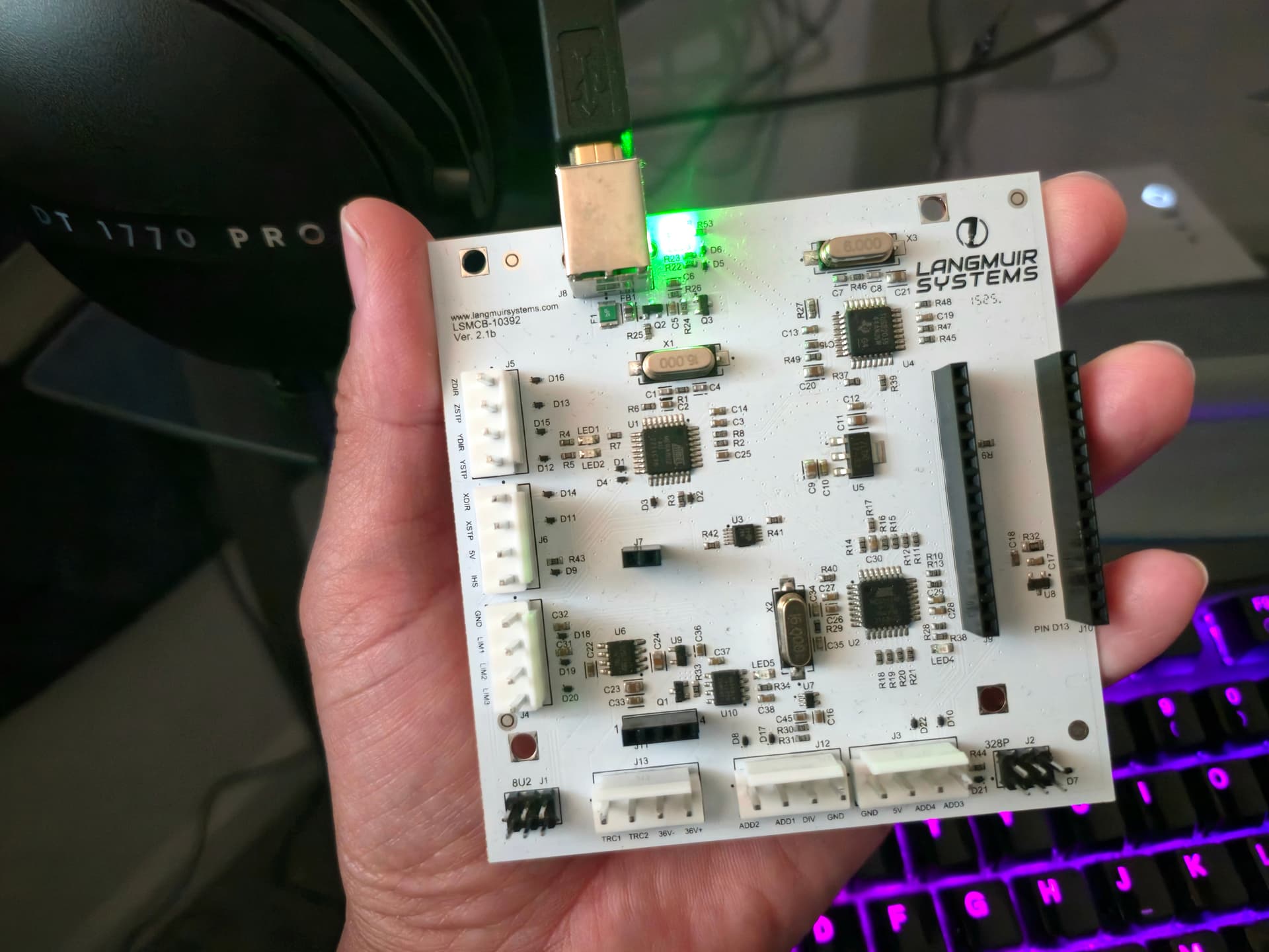

Just bought a used table (1yr old) crossfire XR. I’m slowly figuring out how to set up. I linked my machine to FireControl and was jogging it around the table, then I sent it back to home and when it docked in the corner of the table, the torch lights turned off and it disconnected from my computer.
I’ve tried redownloading firecontrol but I cant seem to get it connected again or to get the torch lights on. There’s power to my control box and I can hear it humming, and the fuse in the back is intact but no table lights.

When homing The gantry will move to the back left comer and will stop when it contacts limits. It then moves back maybe a 1/32” and then the green light on the torch goes solid green. If the limits get tripped during operation the torch light turns red can’t remember if it flashes or is solid
Tried new cables and a different computer and a few different versions of fire control. Also tried unplugging the limit switches all to no avail

Email Langmuir to send you a new control board. They go bad on occasion. They will get you taken care of.

Ok, then it is the control board. If it wasn’t grayed out, I would have you check the power supply inside the control box. The control board is powered by your computer’s USB. Langmuir is very reasonable and may even send you one. I cannot speak for them, but they have always been super helpful. Sorry about your situation. I had one go bad on my Pro and on my MR1.
Just make sure when you install it that it does not touch the control box housing. It will have isolation bushings behind it. The USB on the board is critical. Here is an example of a problem installation.

Thanks for all your help guys. I got a new board from Langmuir for free! Installed it and I’m good to go! Had a few troubles with limit switches but did my first few cuts.
