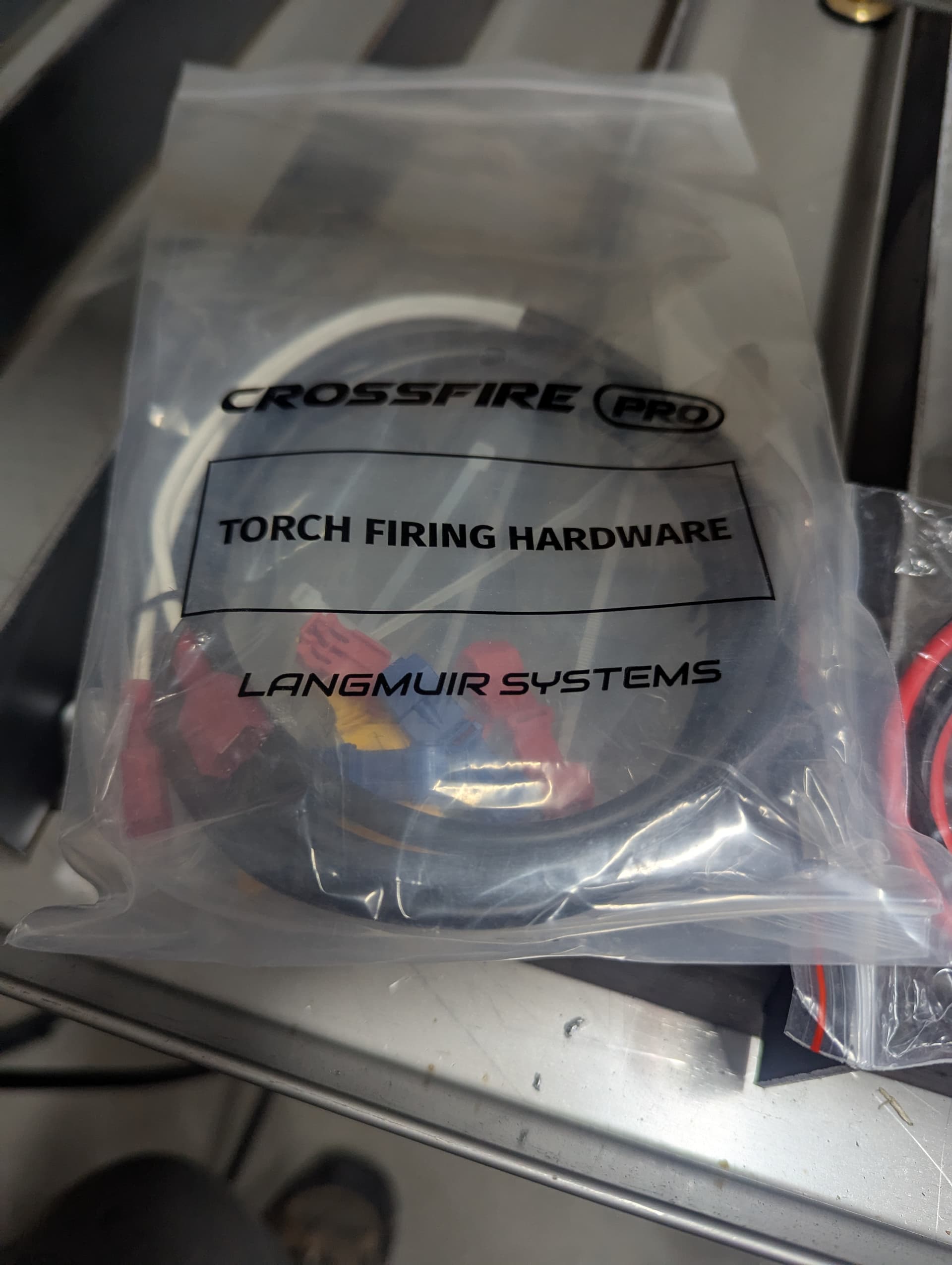

I am getting to the end of assembly, and I have the razorweld 45 with the Machine Torch, do I still need the torch firing hardware or does the torch on/off cable on the front of the plasma suffice for that?
Define “torch fire hardware”
I bought mine 3 years ago. The only thing I did not use was the extra wiring that is for anything other than a Razorweld Cut45 bought from Langmuir.

If you have the wires that plug into the ports on the front of the plasma cutter, you don’t need the stuff in the torch firing hardware bag. That stuff is for plasma cutters other than the razorweld that Langmuir sells.
