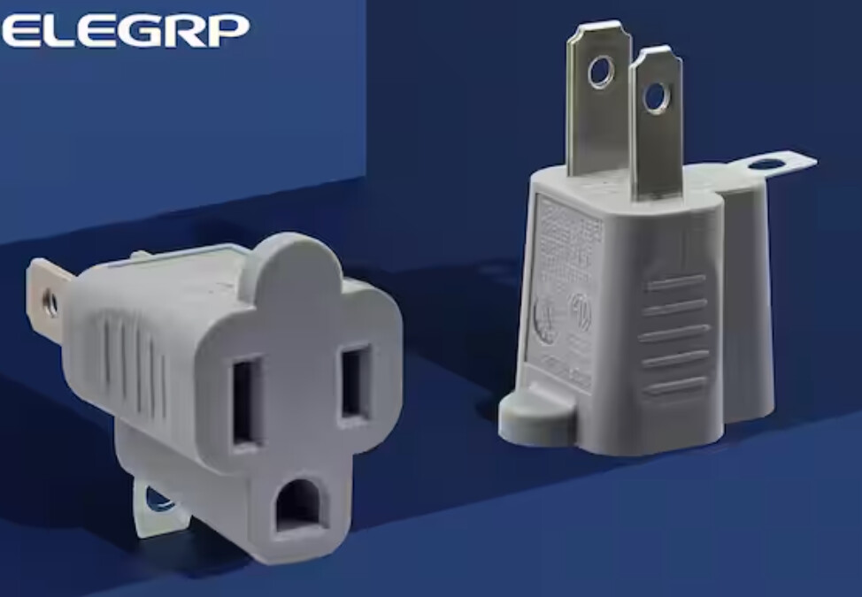

So if the laptop is plugged in, use one of those plug adapters for non grounded outlets so the grounding plug is not a source for the EMI.
(I have mine plugged in, as well)
If your laptop charger has a ground plug you want to run on battery when cutting. You can get feedback through it to your laptop causing issues.
