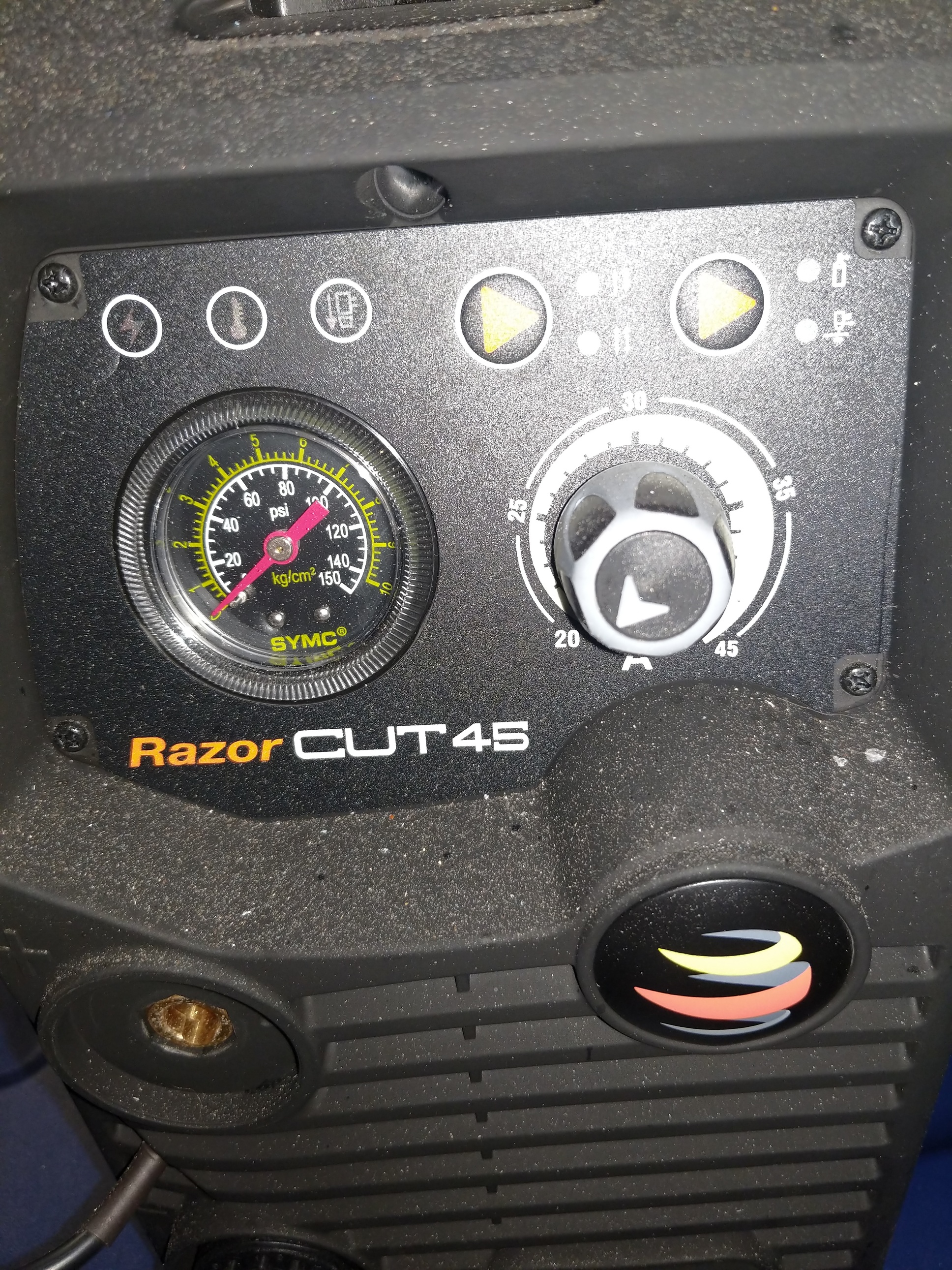

has anyone else’s torch had an issue with continuing to fire after its run through the g code? My torch continues to fire for a long time after it has completed the entire cut path. I actually had to hit the stop button because it acted like it was gonna burn through the slat be. Also my post flow air seems pretty long as well.
What Plasma cutter are you using? If it’s a Razor weld make sure your in T2 mode.
Thanks Jason its the Razorweld 45 I’ll check it to make sure its set to T2.
Artfish or Jason where do you go to find out if your cutter is in 2T or 4T
There’s a switch on the front panel of the RW45.
It’s the 2nd arrow button from the right. If the top light next to it is on, it’s in 2T mode. If the lower light is out it’s in 4T mode.
On the front of your machine there are two switches that are ARROW shaped, you want the left arrow select the arrow until the top circle is lit. There is also an explanation of your front panel on page #9 of the RAzor Cut45 manual :grinning:
