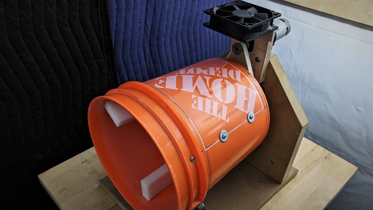

Anybody here used a tumbler before? I’ve got 100s of small parts with sharp edges and some dross. If a tumbler works I’m down. These are too small and the quantity too high to hold by hand with a power tool and too time consuming to put in and out of a vice. I pressed the tip of my finger into my belt sander the other day and that didn’t feel so good. Fresh belt.
@thesupermarket
I’ve thought about a tumbler many times… Then, I make a bigger part and forget all about it… Found a few examples on YouTube builds using 5gal bucket… Take a look… Good for ideas anyways!!
Quite a few vids on YouTube if you look around a bit… Good Luck!!
Amazing! Thanks for pointing me down the rabbit hole. This will be a finger tip saver.
Make sure you stop back at this thread and show us what you came up with…!! I’d be interested to check it out… Actually, could have used one earlier today!!
