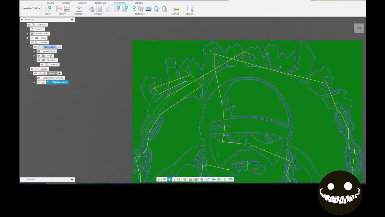

Here is the file I am dealing with. I understand that some points are going to drop out when cut, so I may do multiple layers, but my main issue is just selecting a toolpath, I am not sure where to start.

In the video I find a arch terminating at a acute angle at the intersection of the i dot and body that was causing the issue about the (13min mark) by using the divide the conquer method. I repaired the issue then go on to develop the CAM.

You actually are not too bad with contours but you have infinite loops: Sort of like a circle within a circle within a circle. Tin will show you.

That is awesome. I learned more in that 27 minutes than I have in a month scouring the web for generic F360 videos. Again, very new to this, so the divide method will be very helpful. Thanks for taking the time!
