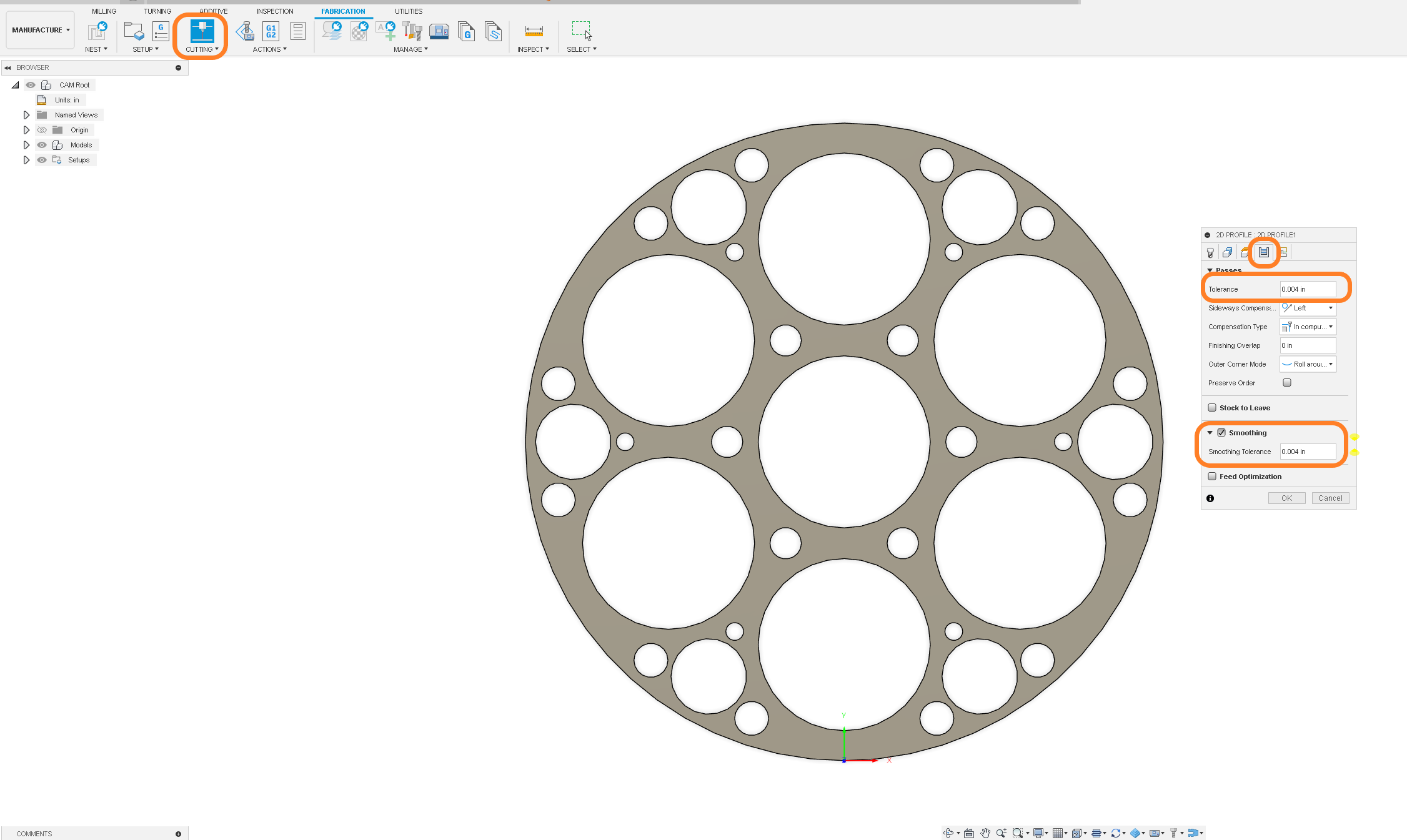

Hey I am trying to generate a toolpath. It is stuck at 77.7%. Do you guys have any suggestions how to help solve this?
If it is really elaborate, Fusion might have got stuck.
If you shared your f3d we could give you an idea if it is that answer or another.
When it has happened to me, it was usually caused by an open contour or a duplicate line stack which created the effect of an open contour.
Like Jim said, post your file and one of us can investigate.
Try to reduce the tolerance in the 2D profile menu and add smoothing.
I’m in the habit of reducing the tolerance by 1 magnitude from the default in fusion
That’s good advice. I gotta get in the habit of reducing that tolerance.
