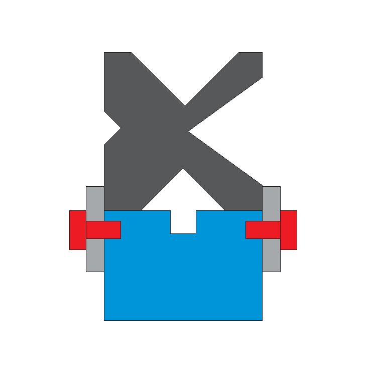

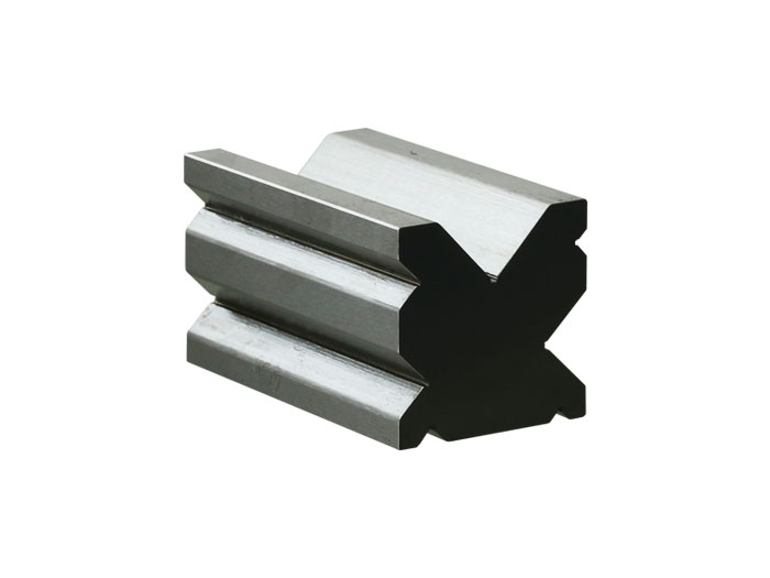

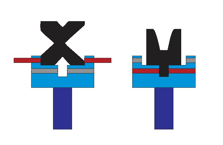

If I were to design my own lower tool holder, it would be something like this, which would hold both dies without the need for extra plates and holders. This 4 way die is designed to be always centered, while some dies have multiple grooves in each side which would need adjustment, but with this die, that is not necessary. just my .02
Interesting, I didn’t know that about dies with multiple grooves on same side.
Another possible solution is to simple bolt on side plates, if the base is 60mm, and the 4 way is 60mm, then the threaded holes in the side could be used to bolt on two side plates. something like 1/2" x 2", CR or even better 7075 alum, countersink the holes and some SS torx. The threaded hole are metric or standard?
this is the simplest solution.

Is the machine bed also 60mm wide ? the same width as the 4 way lower?
The machine itself is 60.89mm. The 4-way langmuir die is 60mm.
thanks for that info, their mill tolerance in china must be 0.0350393701 (.89) :laughing:
Thats the Normal way Die makers make them but the cost of that would be 10 times or more than their current Langmuir die holder. Langmuir designed their holder to be economical to buy from China.
