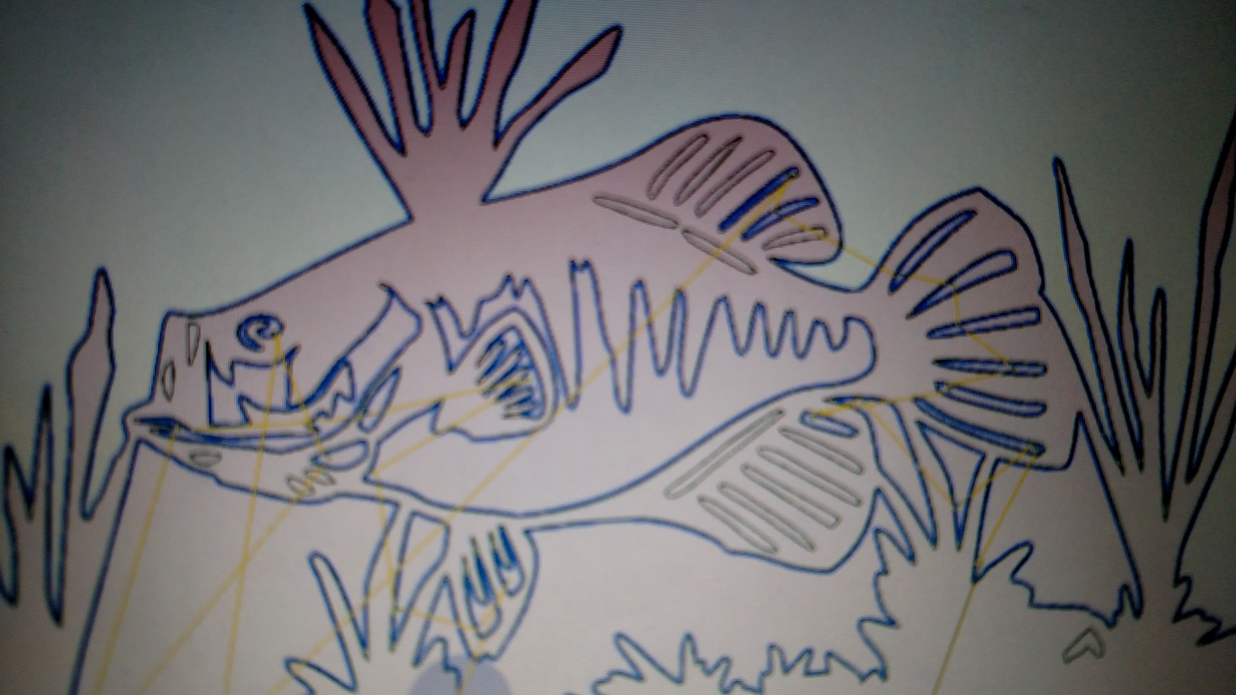

Tool path error
Im trying to create cut paths for this image and I want it to cut on the inside but it will not create the path. What am I doing wrong.
Settings are same as initial setup.
The small cutouts are too small for the lead-in/out values.
