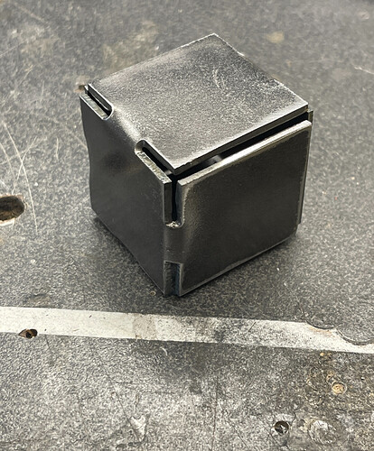

@ChelanJim @Phillipw @TomWS @TinWhisperer @72Pony Working on the foldable box. I have my kerf set at 0.055 in the Cutter Tab, I then fixed the cut direction to the outside. However, the tool path is not cutting the relief cuts when the dimension width is 0.055, but it is at 0.064
I mean what is the best way to handle this, one pass to eat out the relief line? Seems the kerf is coming in around 0.60 according to the dimension.
Box v5.f3d (224.4 KB)
Just remove your pierce clearance and it works. Nope…it didn’t. Still looking at it…
The gaps that are not cutting are 0.055 inches or less. That have to be at least 0.056 for the torch to enter.
Here is another thing with your cube: It is not 1.5 inches on all sides.
I made all of you slots a minimum of 0.06 inches, and the sides all 1.5 inches and went back to Manufacturing and allowed your tool path to run. Now it works.

One quick question, I noticed my cuts are a bit slaggy on the back, I read that too much water in the pan will splash up and cool the slag causing it to stick. It’s not really chipping off like I’d expect, even grinding it takes a bit. Any suggestions on getting a cleaner, crisp cut?
Also should the cuts be 90 degrees? Mine seem to be beveled to the inside starting about halfway through the depth of the cut.
30Amp
60 PSI running
220v power
.6 mm tip
I’ve been using 100 ipm, as it seemed 125 was a bit fast for 14g plate. What speed should I be cutting at with 14g and the settings? I was thinking it’s too high amps for slow speed and it’s cooking it
That’s not the water… generally it is slow speed that causes the slag. It can be bad air causing consumables to wear out too fast. What plasma cutter are you running? Post some pictures of your slag.

Here are the results of the cuts. Showing slag, the two boxes didn’t cut well. @TinWhisperer , it appears the box didn’t cut the last fold and was short. It also cut through the tabs. @ChelanJim box for some reason started cutting offset in the middle of the cut, then the torch cut off. Not sure if these were due to any of the post process settings after I received them.
I was cutting at 125 ipm, Everlast 52i at 36 amps. After looking at the bevels, they aren’t as noticeable from 75ipm to the 125 ipm, but still is beveled. You can see those in the pics.
The slag on top easily just chipped off, the slag on the bottom is what sticks pretty good. Cut Height 0.059 in, Pierce height 0.15

Yes, I would bet you “dollars for donuts” that your actual cut height is too high.
This photo shows you are having a bevel consistent with the torch too high off the metal.
You description of the heavy dross on the bottom would also coincide with that assumption.
You will need to stop the torch while it is cutting by pressing the space bar to interrupt FireControl. That will stop the torch movement and firing without changing any position. Then you can measure the distance from the torch to the metal. Send a photo and use feeler gauge or at a minimum a piece of 16 gauge metal to compare.

You might have your cutter set to 4T, those tabs are right in line and it is suppose to be a rapid but you cutter is still burning metal.
I see there is a contruction line which may have caused it? I’ll cut again.
If you don’t see the tool path generating a cut on the construction line, that is not what is happening. Did you check to see if you cutter is set to 2T vs 4T?
The odd Y axis movement is effecting both @ChelanJim and mine which lead me to believe you are having a Y axis travel issue . (motor plug, coupler? )
the code is good in NC viewer and run a good dry run on my machine.
I may have copied paste from another file on accident cuz I saw it on another file. Strange! I removed the line and recompiled the cut. I changed the cutting height to .058 from .060. Seems much better! Looks perfect.
