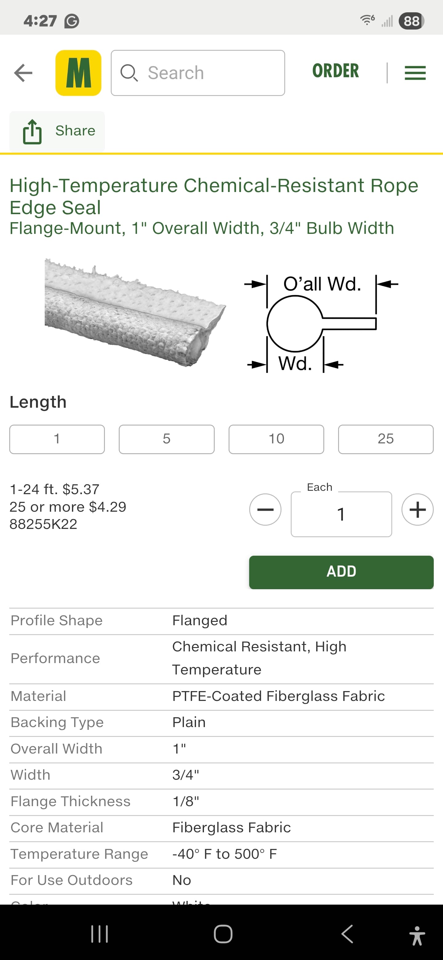

I replaced my door gasket with one from McMaster-Carr. I drilled and pop riveted it onto the door. It’s not asbestos, but a super high-heat oven seal with a 3/4 inch tab sewn in. It works perfectly and doesn’t fall off.
