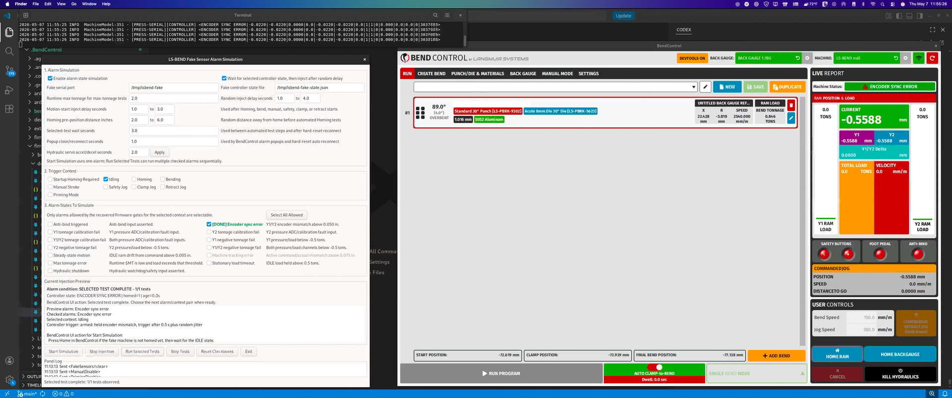

For reference, I attached a screenshot from an automated alarm-code testing application I built during development/testing.

So far, I finished reconstructing the firmware and burned it into the controller and it accepted without any fuss and printing happy messages over the usb terminal. However, during my initial burning, I accidentally bricked the controller MCU due to a single line of code :grimacing:. I had to desolder it from the controller and transplant a new one from a regular Arduino Uno R4 Minima to fix it. It was such a fun thing todo while not managing to damage anything else on controller PCB :rofl: . Luckily it is in working condition now.
On the controller level and bendcontrol, the following feature are implemented:
  • Metric system: This one is a priority for us from the beginning. Machine now can accept metric units with $U=Metric command send from Bendcontrol, so both inch and metric measurements can be used and switched on the go within Bendcontrol interface.
  • Updated bendcontrol ui to run in higher resolution. Added UI scaling option to increase font, button and other ui element sizes. So, no more small buttons.
  • Added and changed some UI element positions, moved a few things around to give more usable space inside UI.
  • Fixed the backgauge names are dissapearing from bendcontrol.
  • Hold to bend option is added, alternative to double tap to bend. This was an invasive prodecure and gated through controller firmware itself, not by Bendcontrol.
  • Upgraded the onboard computer: The computer comes with Titan 25T is ok, but it can be unresponsive and sluggish, especially with armbian OS. So I decided to switch it with Orange Pi 5 Pro with 16gb ram. Added M2 SSD and eMMC to get rid of the SD card problems and so far it is working flawlessly, machine boot time is less than 30 seconds.

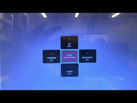

Sorry guys I was crazy busy for the last couple of months. Yes I completely rewritten the firmware from scratch and it works flawlessly. Once in a while I encounter a few minor bugs but as soon as I encounter one, I quickly fix it.
As a side project, I also started working on a new software, completely different from bendcontrol to control the machine. So it will be completely different firmware and application suite that does not had any resemblance of Langmuir firmware or code to stay clear from any intellectual property claims. Since I never heard back from anyone from Langmuir, I decided to work on everything from scratch rather than modifying on existing software and firmware.
However, I still feel it is not ready for public or close testing, since there might be some edge cases where unexpected bugs might occur and cause damage on the machine itself, which I cannot accept any responsibility for. Changes are substantial and motion and safety system is completely different from what Langmuir programmers implemented. That will also requires new Orange Pi 5 Pro with 16GB ram and M2 SSD, since running it on SD card with old orange pi 3 might cause performance issues. So some hardware swap is going to be needed.
But here is a video I shot a while ago that I demonstrate the changes and the new UI that is still way too early steps in progress. Sorry for the video quality and shaky hand :smile:
