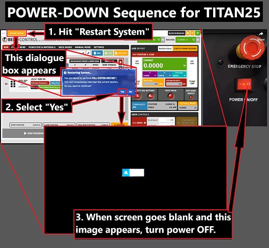

Titan 25T Proper Shutdown Procedure
The Titan 25T system controller is an embedded Linux single board computer. The 25T interface doesn’t have a shutdown procedure. Simply turning off Linux boards is not a preferred way and there’s a slight chance that filesystem corruption may occur (which causes a long boot process next time the system is booted).

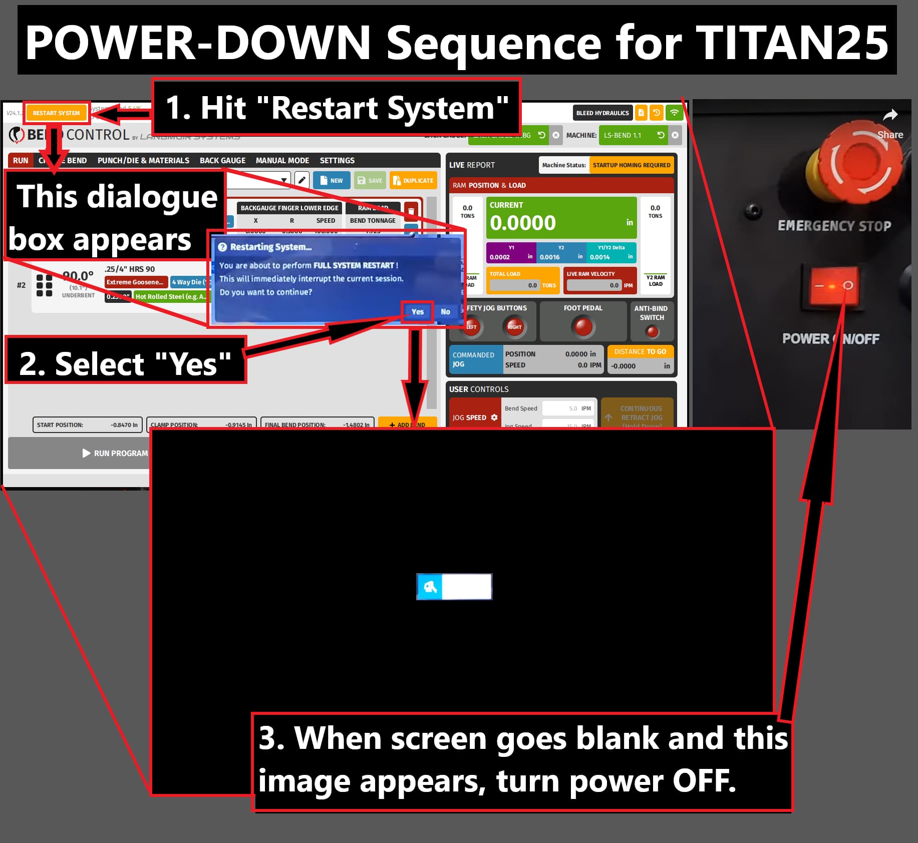

Here is a graphic I created for Craig’s shutdown procedure. Sorry that it is a little “busy.”:
It’s almost as if this procedure should have been included in the operation manual…
so this is still the recommended shut down?
With the most recent 24.1.3.img patch, no. You can and should just flip the switch normally.
I agree with Sam, this firmware revision prevents file system corruption. Just turn it off.
