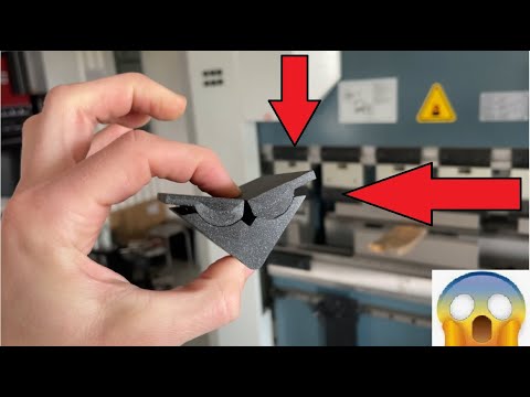

An option you can play with is 3D printing your dies. 3D printers are a dime a dozen and it really is a viable solution to thinner material bends.
Here’s some videos.
