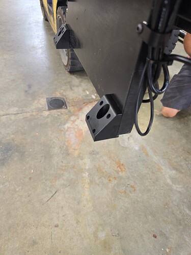

Here are some assembly pictures. My two cents here are that if you can’t put this together, you’re in trouble with life. Simple as pie. A forktruck to suspend it so you can bolt on the stand is a plus. Don’t unbolt it from the pallet until it is secured with a hoist or fork truck. It can fall over.
Just follow the instructions, and you guys will get this.

For anyone who might need the DXF file for the lifting brackets for Titan, I will leave the FireShare link here for you all to take a look at. There are photos on how to install as well as the additional materials needed for the lifting and moving process.
https://www.langmuirsystems.com/fireshare/titan-lift-plate-14-steel

did the lift brackets come with it? I see in an earlier post they are $29? does anybody want to make me a set?
No, you need buy them. I will send you mine if you like but it will cost almost that to ship them.
Where do you buy them? I don’t see them on the site. I see some opportunities as an 7.5’ high beam might not allow enough height to hoist it. Do you think an engine stand will do it? It almost looks like a bar going between the 2 brackets could help reduce the height of the straps/chains. If the brackets are in the final invoice then I will get them then.
It probably won’t work due to the pallet. It is bolted down and needs to be secured before you take out the bolts and brackets. Without the bottom bolted on, it has a good chance of falling over. Look at the picture I posted. I would recommend the wheel kit. After it’s together, it rolls with one finger. The base is a quarter of the weight of the machine. Without it, I would guess 800 or 900. lbs.
I don’t know when yours is shipping, but if you email Langmuir, they will add these parts to your order.
Lifting brackets
Wheel kit
Are highly recommended by Bigdaddy2166
