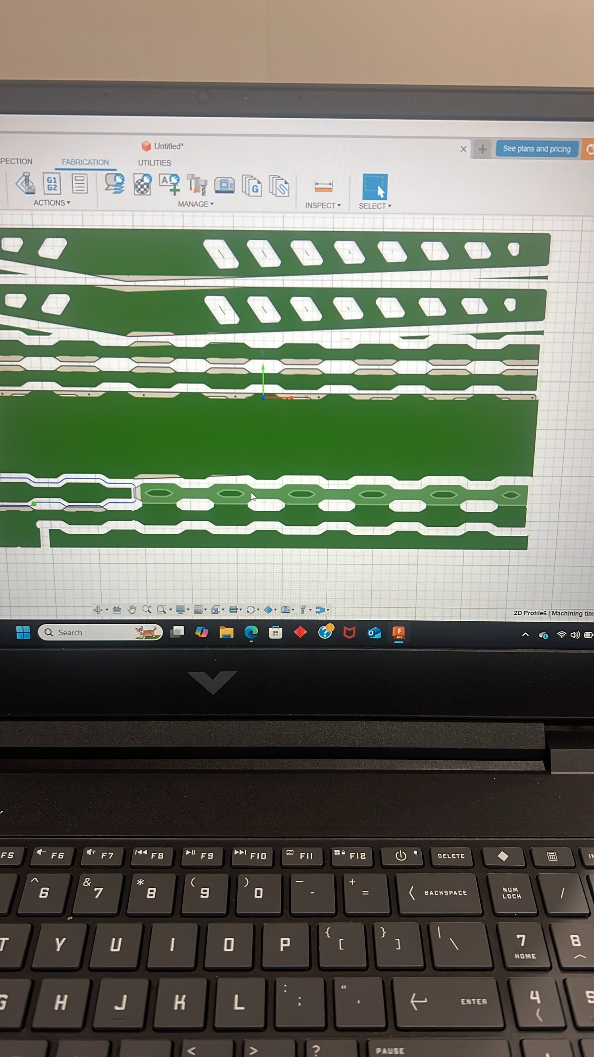

Fusion 360 will not include interior details in design as a cut line, any way to fix this? I’ve tried clicking the body of the part, and every line in the part no difference.
It is a bit difficult to know exactly what you are asking. If you shared your f3d file, one of us could look at it and see more of what you are trying to explain.
Here is how you share the f3d file:
If I was to guess, when you say “Fusion 360 will not include interior details…” you are saying that ‘Fusion is discarding some of the contours.’ If that is the case, it is likely there is not room for your lead-in, lead-out and or pierce clearance.
Keep in mind, you can/should ALWAYS set pierce clearance to '“0”. It messes up most new users and is totally not necessary.
