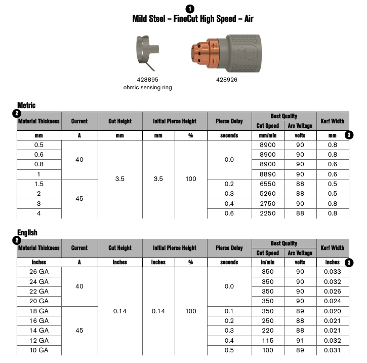

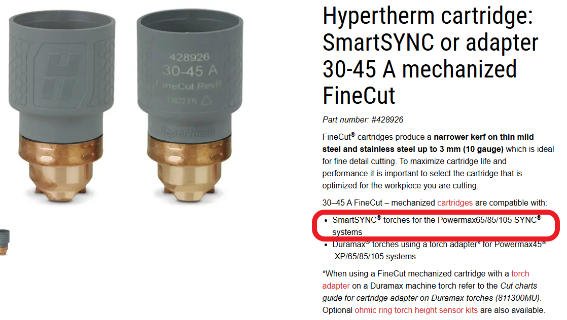

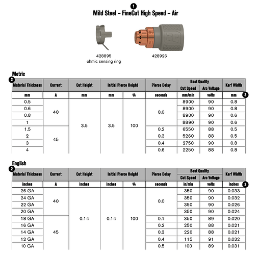

May I ask you about sync 65 . Can you use sync tip from the sync 45 like the fine tip 30-45a ?
To be honest II don’t know. I use a fine cut 45amp for my sync65.
Hypertherm states that the fine-cut is compatible but you need to keep the amperage down to 45 amps.
But remember, fine-cut is not recommended for aluminum and it is not meant to be used with thicknesses greater than 4 mm or 10 gauge.
The sync wont let you over amp the cartridge. It sets it to the max amps for the tip. You can lower it but not over amp the tip.
