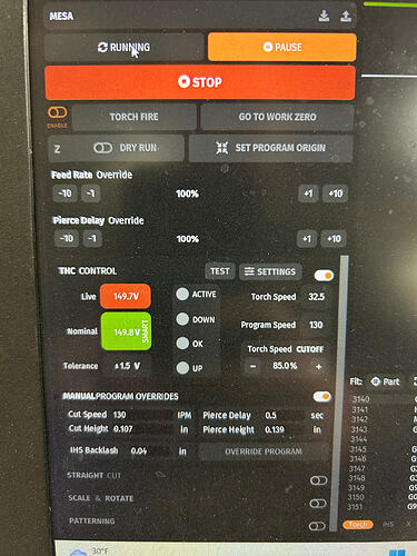

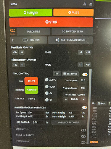

Need your live voltage numbers while cutting.

Do you have voltage showing there when you are not cutting?
It drops to 0

His voltage numbers are spot on for the book specs though.
I agree. His settings are correct also.

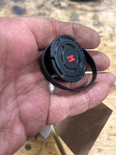

I bought this with my cutter. Does anybody know how to use this and will this help me?
You should be able to read what’s on the cartridge directly from the machine.
But if you want to use that you’re going to have to download the app and then hold the cartridge very near your phone where your NFC reader is.

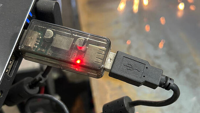

What is this?
Ground loop isolator from Langmuir
Langmuir gave that to me to kill the emi that goes to the xr
