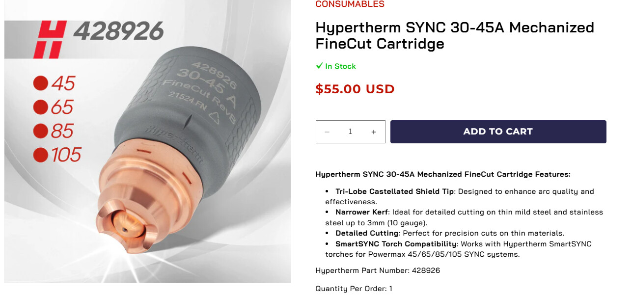

First off that is the wrong Shield on the torch. Thats for hand cutting.
Is that piece 1/4"? if so your not getting spring back from the piece flexing. I dont have a cross fire but I think the torch mounting would be the same as the XR. Its only the weight of the torch pushing down on the piece. Are your slats seated firmly? Is something loose some where?
I would put a larger piece on there and check again.
Why are you using a hand cutting drag cartridge on a CNC torch?
It is likely this consumable:
It is not really a drag tip. (I fell for that before)
Jim is correct, it is in fact a Mechanized Fine cut cartridge for the Sync 45.

so when you set cut height do you do it with that shield on? I cant tell in the pic if the tip is flush with that shield?
Hypertherm designs all their torches to be measured to the machine shield or deflector (not the drag shield). Somehow they have it all calibrated that way.
Well then excuse me. Because I have never seen that cartridge before. I am guessing they built it that way to get rid of any blowback that may happen.
They are just trying to trip us up George! Don’t you know it!
I see that now. Also just found out that the Eastwood Versa cut 40 cnc plasma cutter uses a Chinese S45 hand torch. But the machine torch is a Chinese copy S75 torch and only uses 50 amp drag consumables, I just don’t get it. I think these company’s need to do a little more research before just buying this junk from China.
