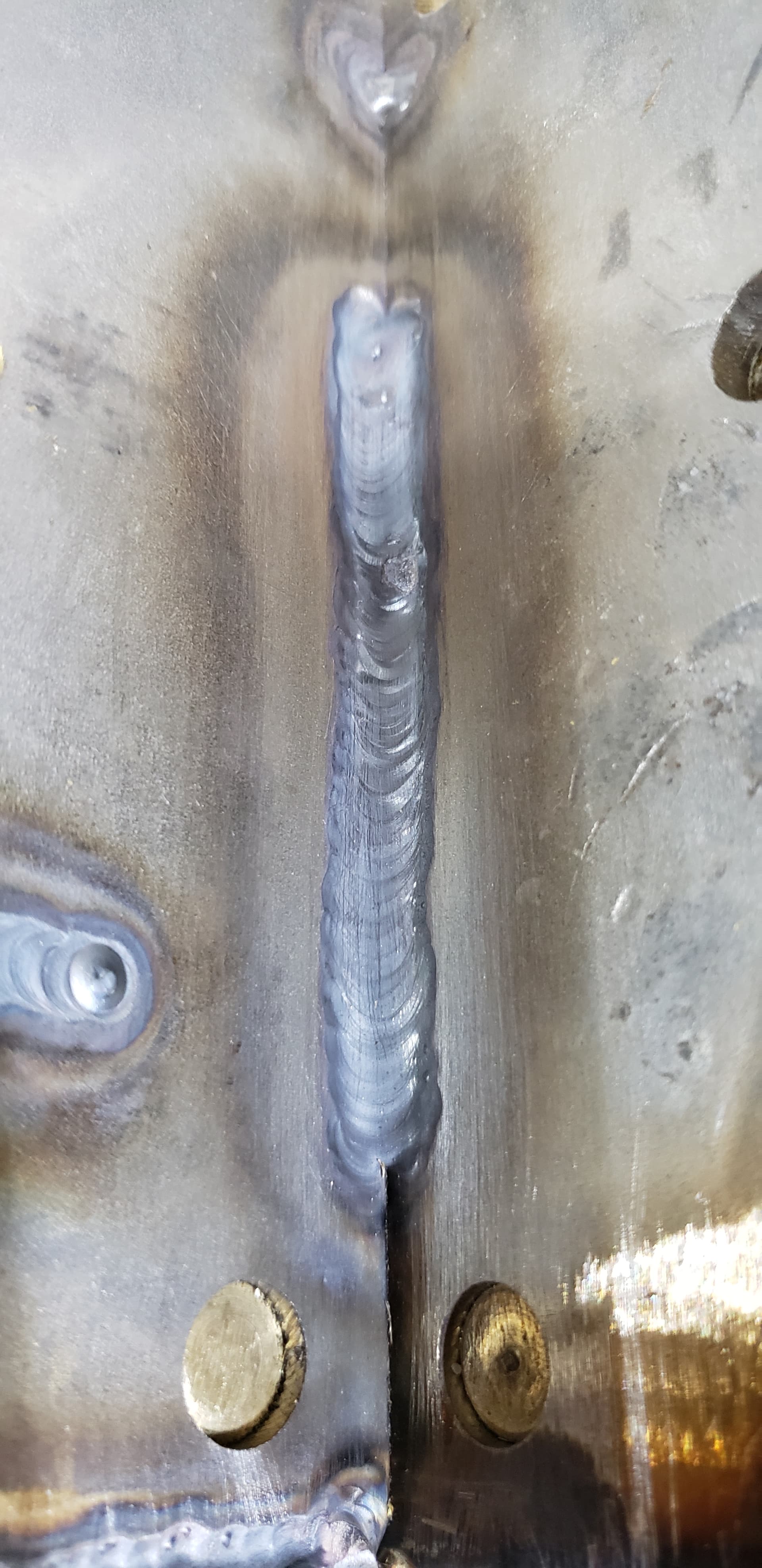

I got about 50 lb of argon left in my bottle, so i did a quick stick together on some 316. No filler rod, but the fusion weld did pretty good.
Yes, I know, clean clean. I’ll work myself up to that.

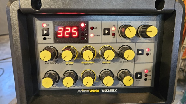

I like the analog nature of the controls vs menu driven. I feel like I am learning more using those than scrolling. Plus I figure repair costs, should they ever be needed, should be much lower if it’s just a rheostat failing vs a menu board.
And man, that SMAW is so smooth and easy to strike.

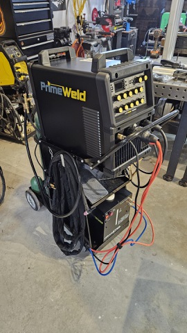

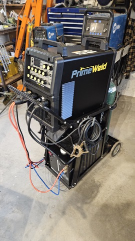

So is machine arrived he’s just short coolant which should show up in the next couple days.

Once he starts laying some beads I’ll let you know how this one works out.
Fill it up with tap water and have at it. That is all I use in all my coolers and change it out every few months.

That’s a lot of knobs! :face_with_spiral_eyes:
