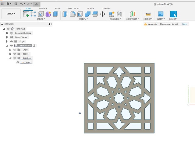

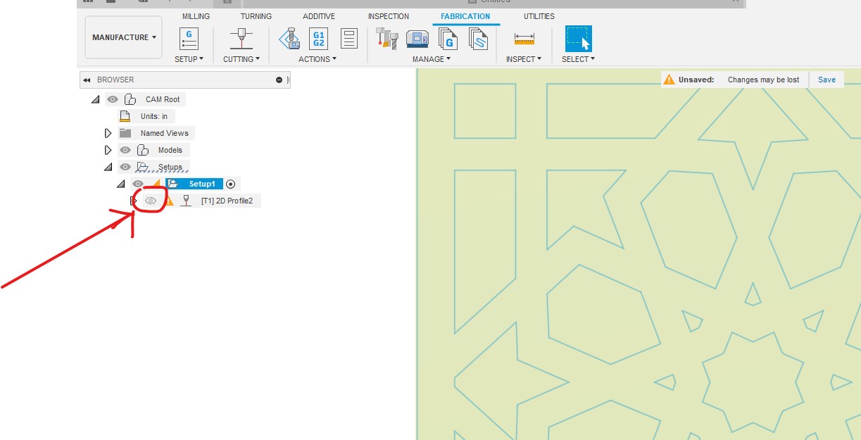

This file is refusing to generate g-code
I’ve now done this 20 times on different files, and this is the first file that when I’m done selecting all the outlines to cut, it only generates g-code for a few of the elements and gives an error. I’ve seen that error before when the areas to cut are too small for the software to generate a path. but that’s not the case with any of these. I deleted all the cutting and setups and started from scratch, and it did it again. Interestingly, I had to redo this file (the frame wasn’t the right size). The first time, it worked, it’s only now that I’m running into this.
pattern 29 v4.f3d (966.7 KB)

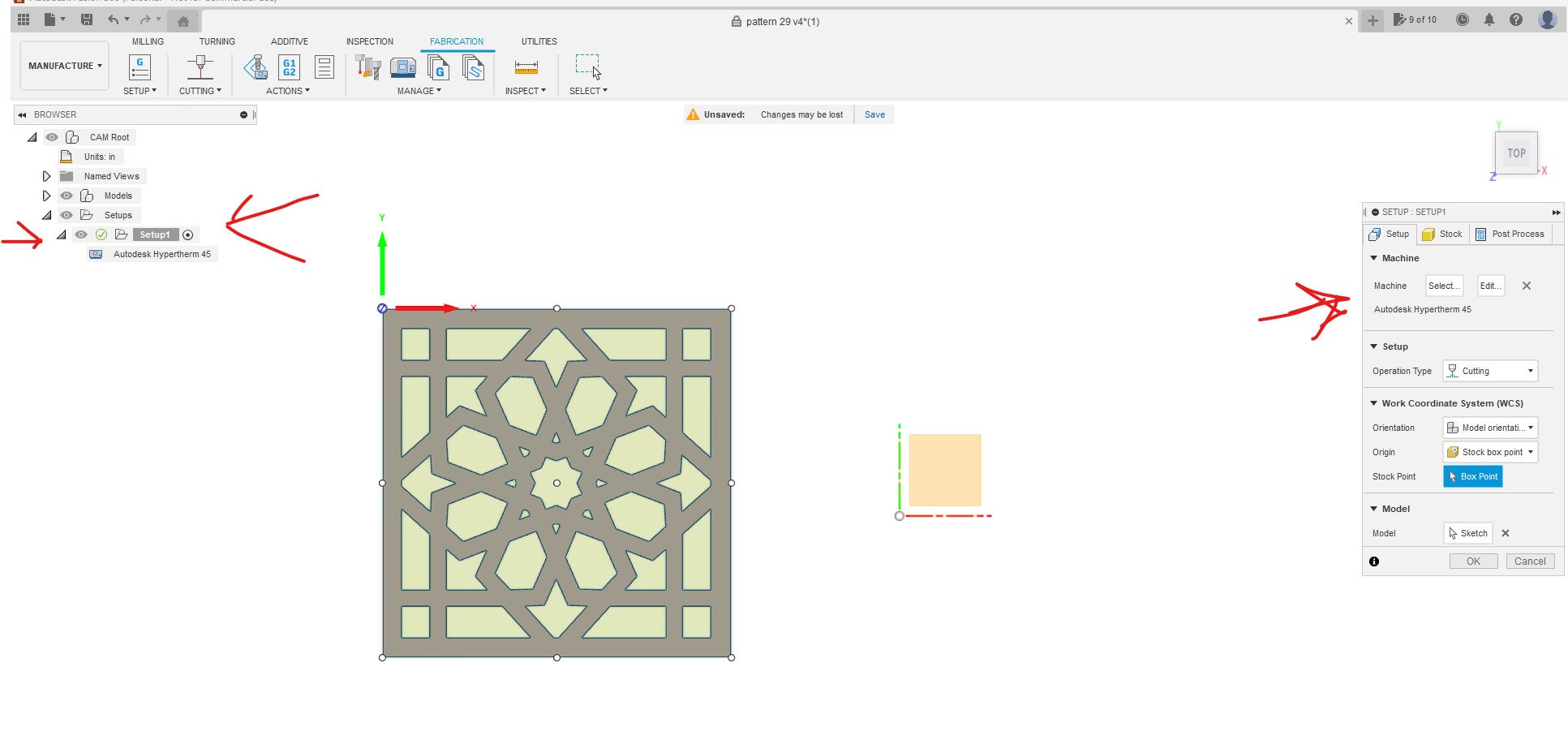

you must click and have the eye show marked when you try to create Gcode.
Don’t cut because you won’t be happy. I don’t have time to look at everything now but if not resolved when i get back from the easter egg hunt i can explain how to fix if someone else don’t

see attached. look everything over before creating Gcode.

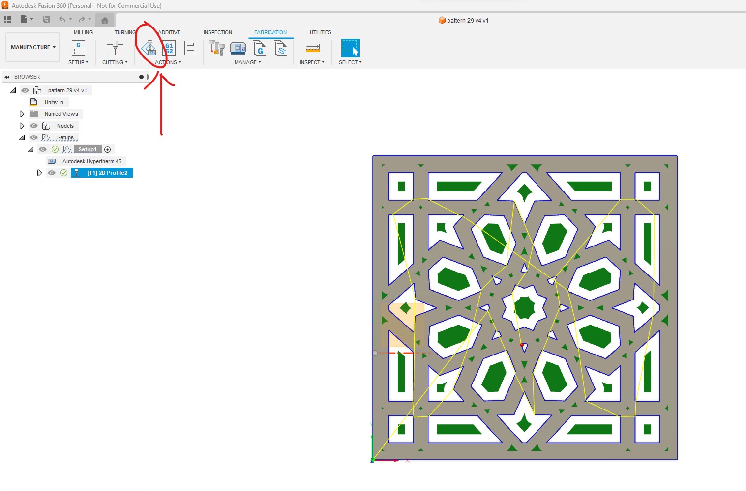

it should be extruded like this prior to going to manufacturing to create tool path
make sure you check to make the file is correct for your machine. i have hypertherm45 and looked like you have a RW45.
thanks - did you have to make any changes?
I tried what you said on my file (extruded a sold and used that to generate g-code) and it didn’t work. I downloaded and uploaded your file and changed from hypertherm to razorweld and it won’t generate g-code. It still gives the linking constraints error.

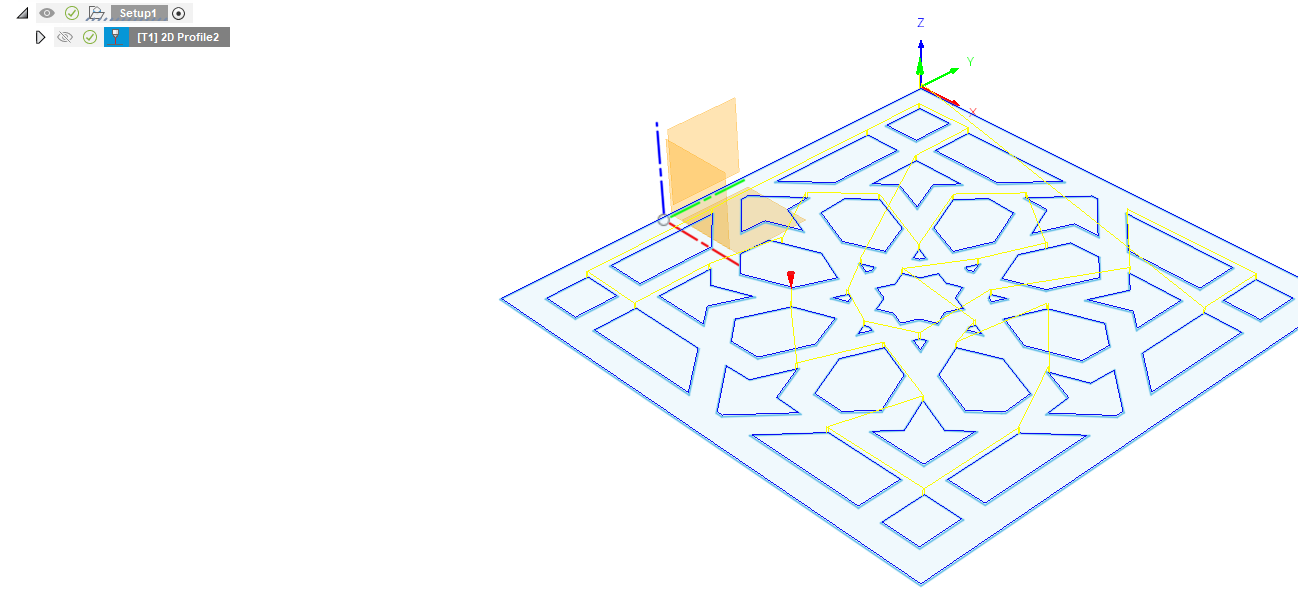

I reloaded your original file and try to run the simulator on it, and it wont’ run.

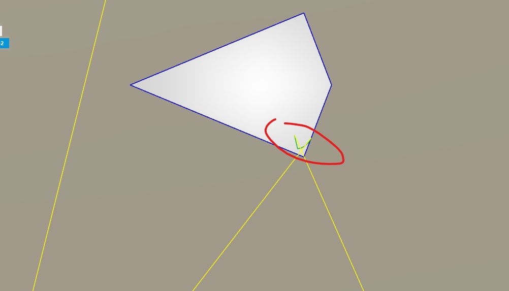

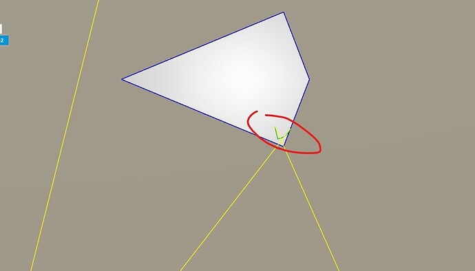

I tried your original tool path and this worked without extruding made these changes to lead-in and pierce clearance:
Here is the result:
I know. It is a little frustrating at times. But you will get it.
nope…it took me maybe 2 mins tops to just go back to design and extrude. You must be cutting thicker metal if running at 40 ipm. I like to so my lead-in down a little so if speed is 80ipm i do 60ipm for lead-in speed. Just something to consider if you’re not already doing this with cuts. Start off with book settings and dial it in is the best thing. GL and post some pics
the razor is set to 40 for default, I’m running these at 80 (14 gauge).
thanks, the changes to the pierce clearance fixed it. Thanks for the help.
Now, when I generate the g-code. I’m getting this error - and I never screw with that tab in the cutting tool. I’m guessing it’s okay to run.
Warning: From the highest Z position of the stock, the Safe Distance (Linking tab) is higher than the specified Retract Height (Heights tab). To maintain the Safe Distance, the Retract Height as been raised. If you want to maintain a lower Retract Height, consider reducing the Safe Distance.
watch the simulator
things to look at is lead-in tails

That error, relating to z-axis is not related to the piercing clearance.
Piercing Clearance lets you specify a distance away from the part profile to safely pierce the material, before starting the contour. This value is in addition to the Lead In distance values.
Consider this more like a tool moving in laterally like a milling machine. It is not in the z-axis plunging motion but a lateral motion of the table.
