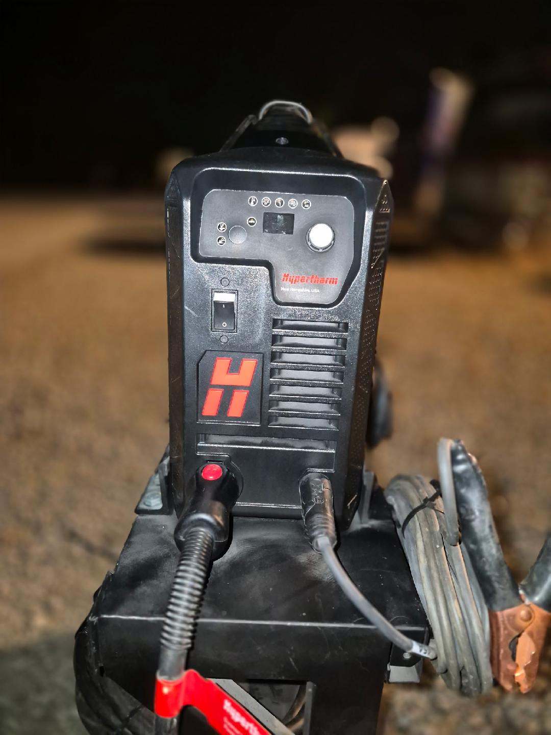

I have a 45xp (non-sync) with a machine torch. They didn’t have the sync stuff when I bought mine.
If mine broke tomorrow, I would buy another one for my table immediately. That is the best rating I can give.

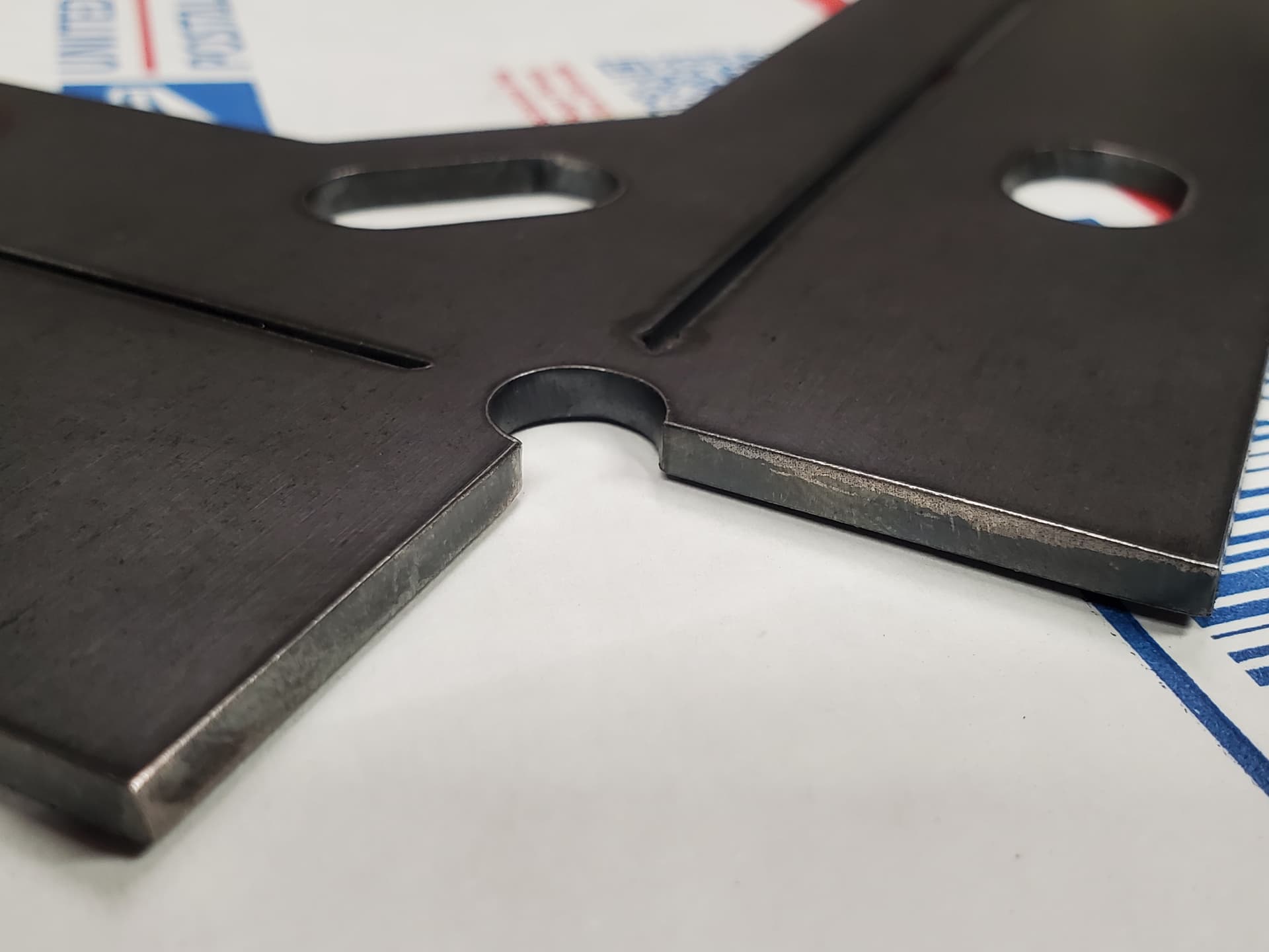

I personally ran a PrimeWeld CUT60 for well over 4 years (2.5 years on a CNC table) and achieved what some people thought were laser-like results. Clean, sharp and squared edges, cuts with no dross, and more. And this was done with the Chinese PTM-60 machine torch using Chinese consumables. I say this as I’m aware of Everlast machines using the same consumable style as well.
Here’s an example -

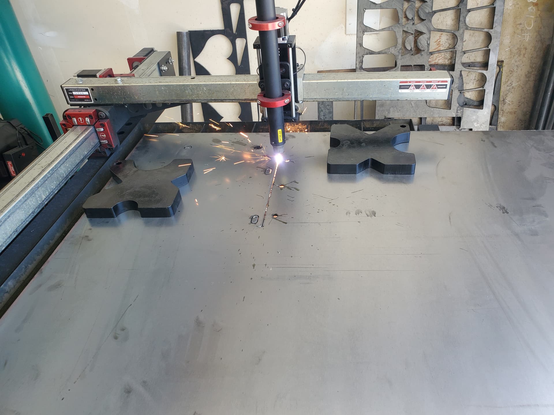

This was while running a small, 30 year old Craftsman air compressor at 110v with no refrigerated air dryer.
On the other hand, you could look into buying a different machine torch type that uses different consumables. A lot of people make a clone of the old Hypertherm torch, using T45 consumables as I had one on my PrimeWeld as well when it first came out.
Cut quality was the same (not a bad thing, I was already getting excellent results) whereas consumable life went up quite a bit to an average of 800 pierces per electrode, and 800 pierces per nozzle. This difference in consumable life can be explained due to the use of shielded consumables versus that of the PTM/IPT style torch.

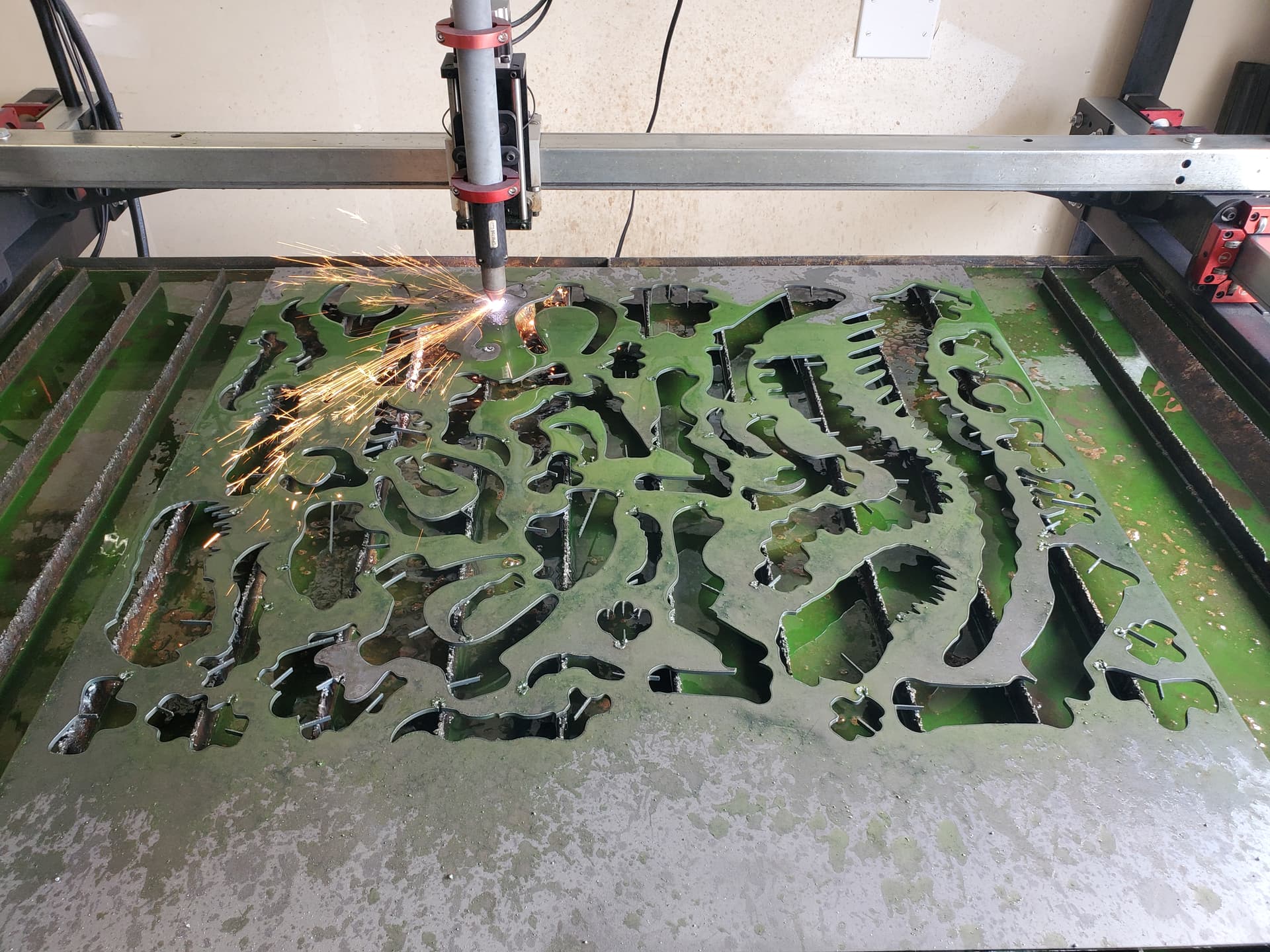

Here’s an example of those cuts -

Since I cut 3/16” quite often, I will say I saw practically no difference between both plasma cutters. Nothing stuck out in terms of cut quality, lack of beveling, etc. I did notice that I was able to run a shorter pierce delay, as the Hypertherm was quicker to fully pierce thicker materials.
The only other thing that stood out was being able to cut at a faster speed for all materials at the same 45 amps. With the CUT60, I would run a slower speed at 45 amps, or nearly the same speed as the Hypertherm but at 60 amps. The Hypertherm just seemed to have more “oomph” and that’s due to the actual higher output voltage.

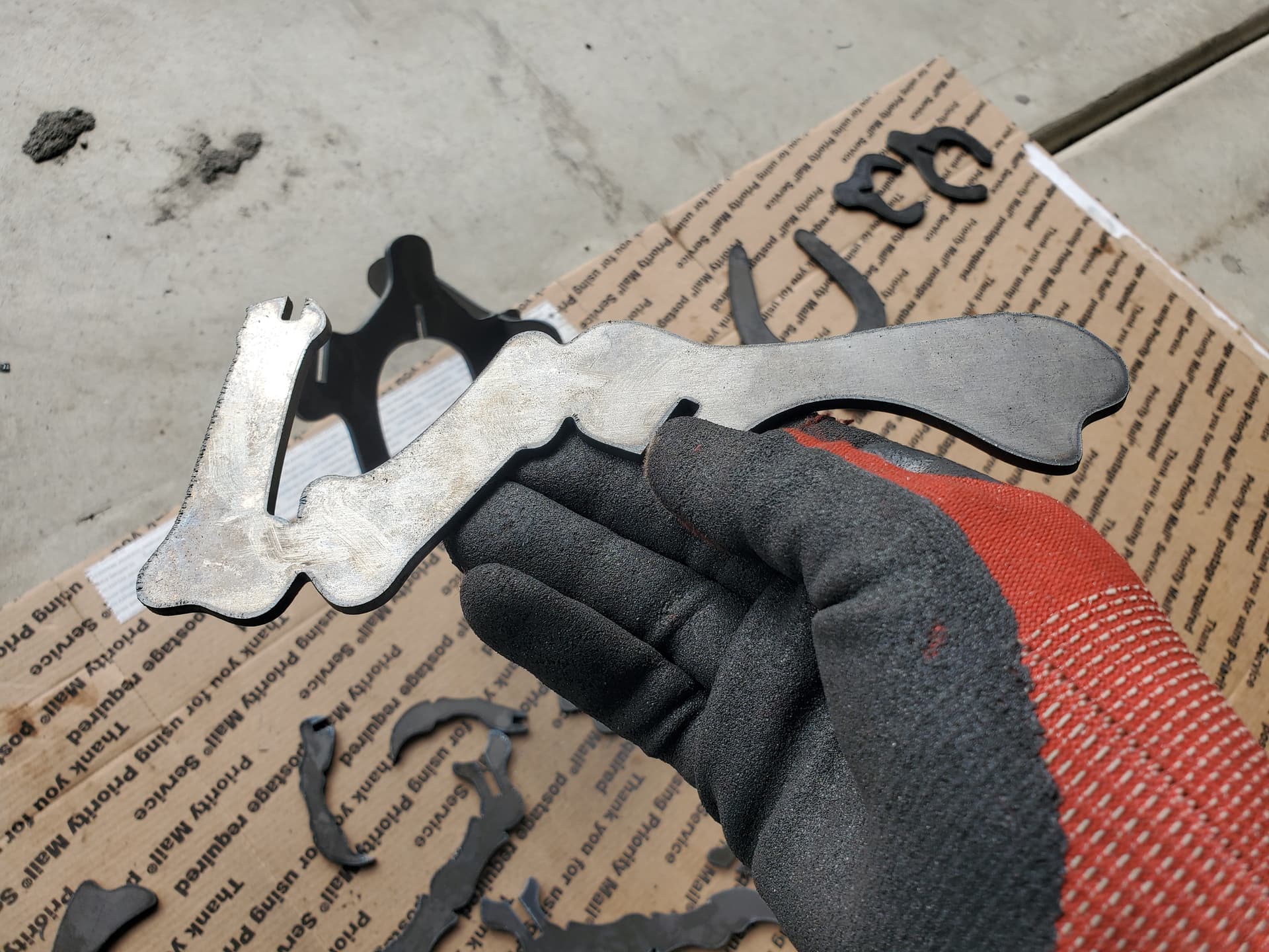

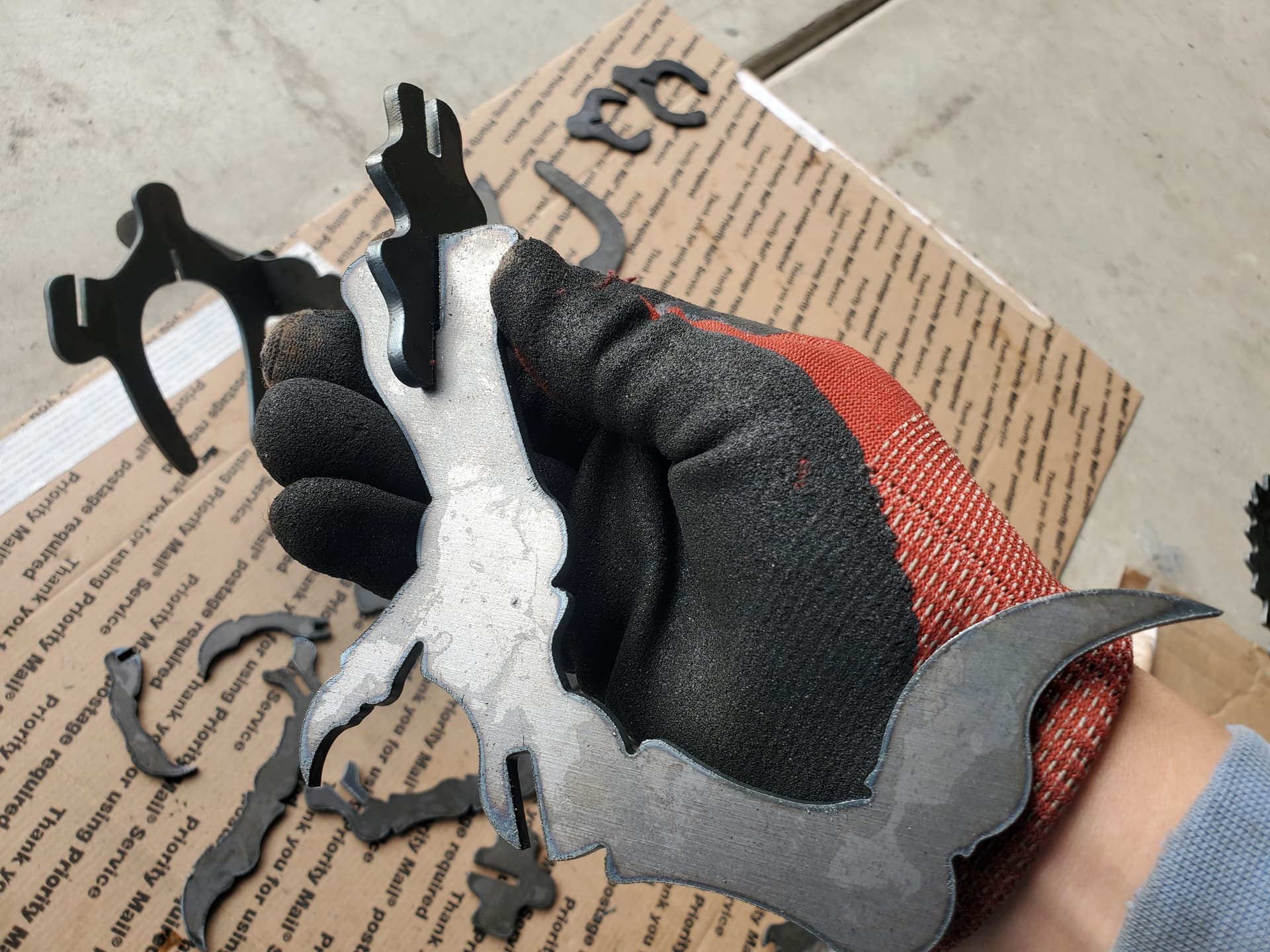

Here’s a cutout of the same item, same table, same material but with one item being done with a Mechanized consumable set, and the other being done with Finecut -
And just some random parts cut with Finecut -

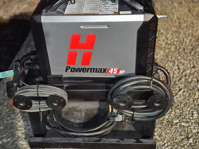

Here’s one for 1200 bucks
https://denver.craigslist.org/tls/d/denver-hypertherm-powermax-45-xp/7901969155.html
