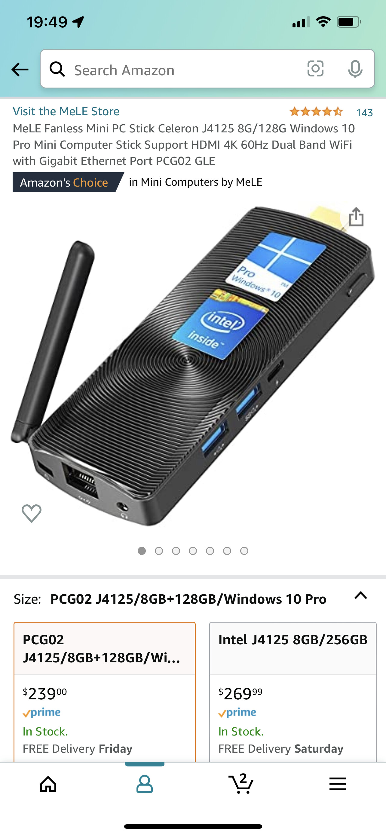

Some more adventurous (AKA Cheap dudes… :wink: are using a Mini PC which you can get brand new for $110 → $200. I’m one of those… I use a Mini PC on my CNC Router (Plasma table was already setup with a laptop so I’m sticking with it) and it works fine, albeit slow boot up and file access.

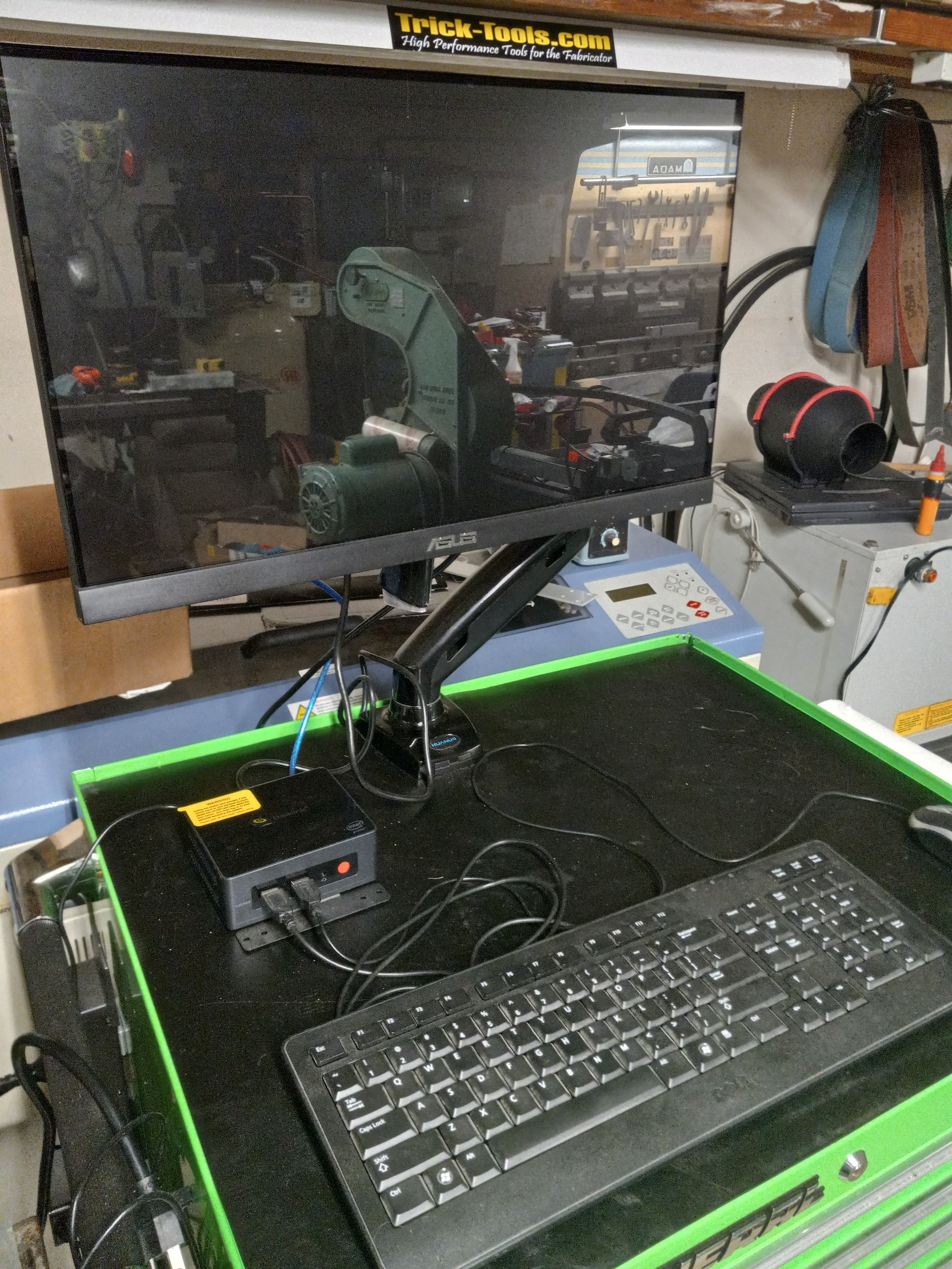

I followed a suggestion from @Cletus and @Bigdaddy2166 about using Mini computers and bought this one on Amazon. I tried an even less expensive model but had to send it back.
Beelink GK Mini PC with Windows Pro, Intel 4Cores Processor Gemini Lake J4125 (up to 2.7GHz). Mini Desktop Computer 8GB RAM+128G SSD,HDMI Support 4K@60Hz, 2.4G/5G Dual Wi-Fi, Gigabit Ethernet, BT4.0
I won’t be using CAD/CAM at the machine site, so it will only be using Fire control there. You will need to look at the specs to see if it is adequate to work with your process.
The upside is it was only $250 and has a minimal footprint. It is in the upper left corner on top of my cart.
Disclosure: I haven’t fired up my table yet, so you might want to search the forum for BeeLink and read what these guys have to say about theirs.

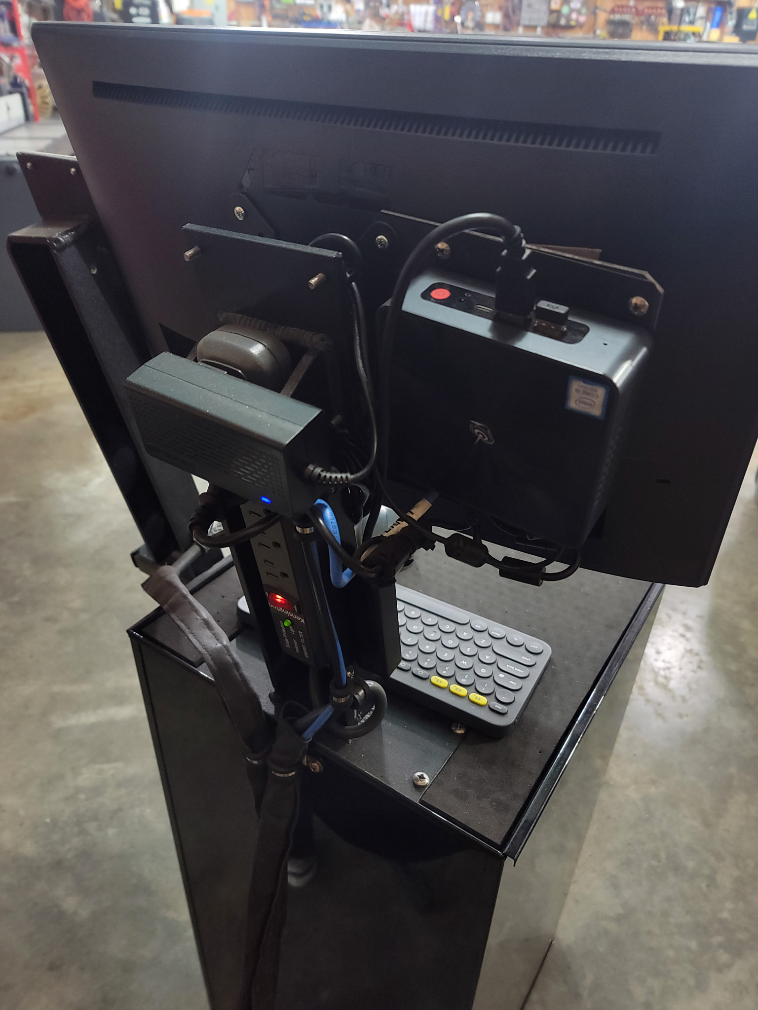

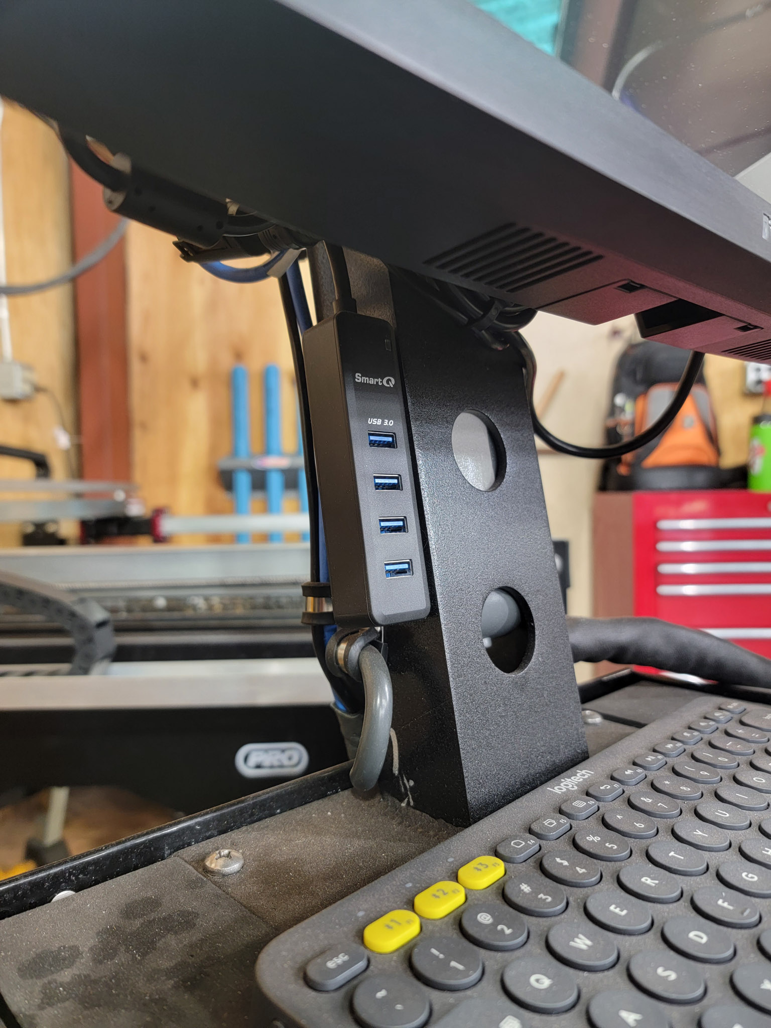

Looks great. You’re going to love it. Mounted mine to the back of the monitor.

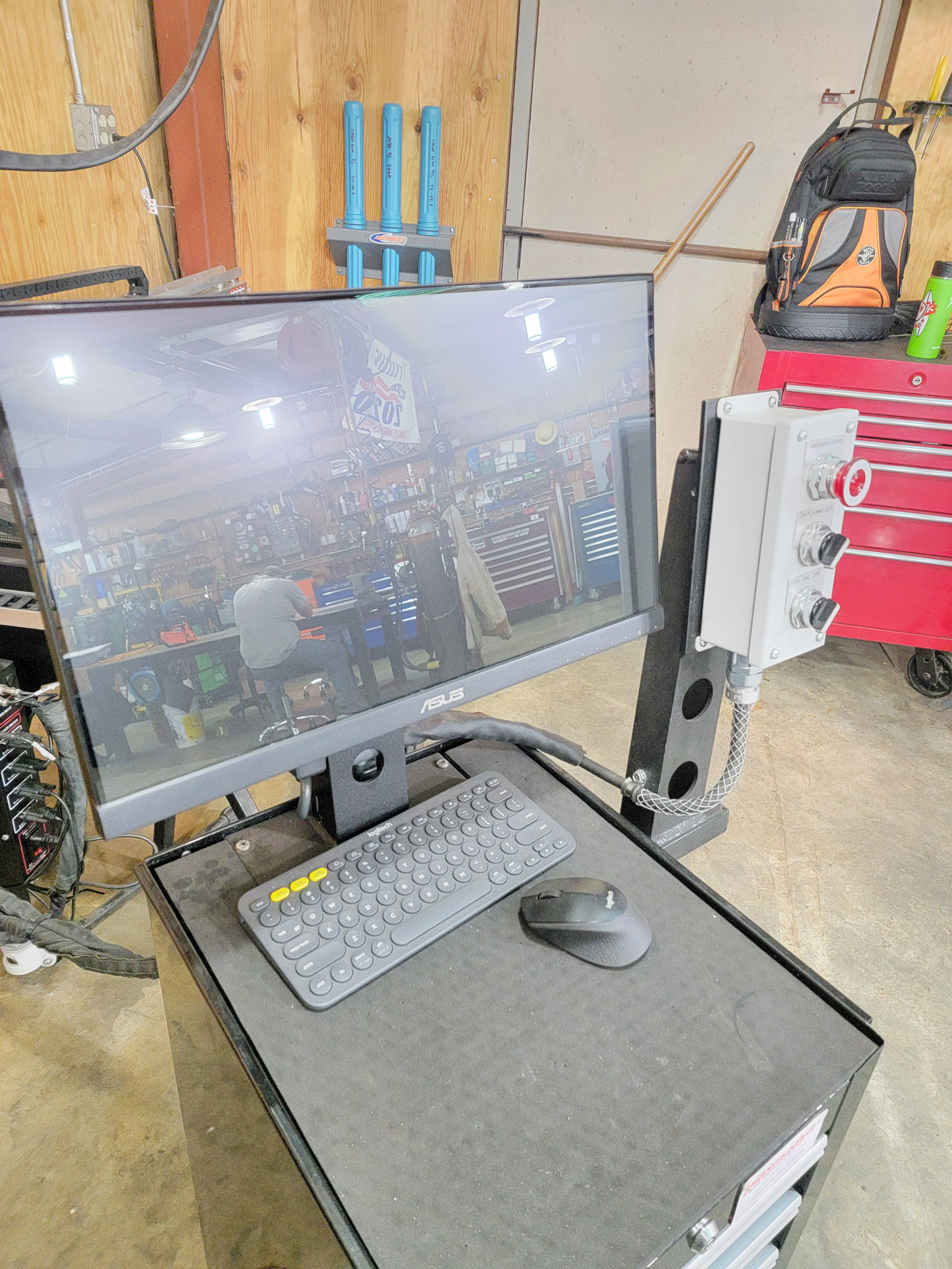

This is what I use to drive the table now.
