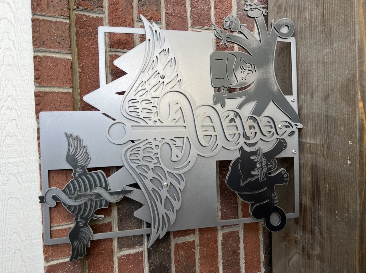

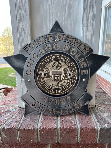

Here’s the latest, 24x25
Was asked to incorporate elements from 4 different military patches.
dude…you are getting some serious nice finishes on your work…
Thanks man! I go through a lot of sandpaper. The Odies is good, but it’s tricky. I oiled and buffed then stripped and started over in this one 4 times trying to get it right. I think the heat was a factor. You also need to let it sit for a bit to not leave fingerprints.

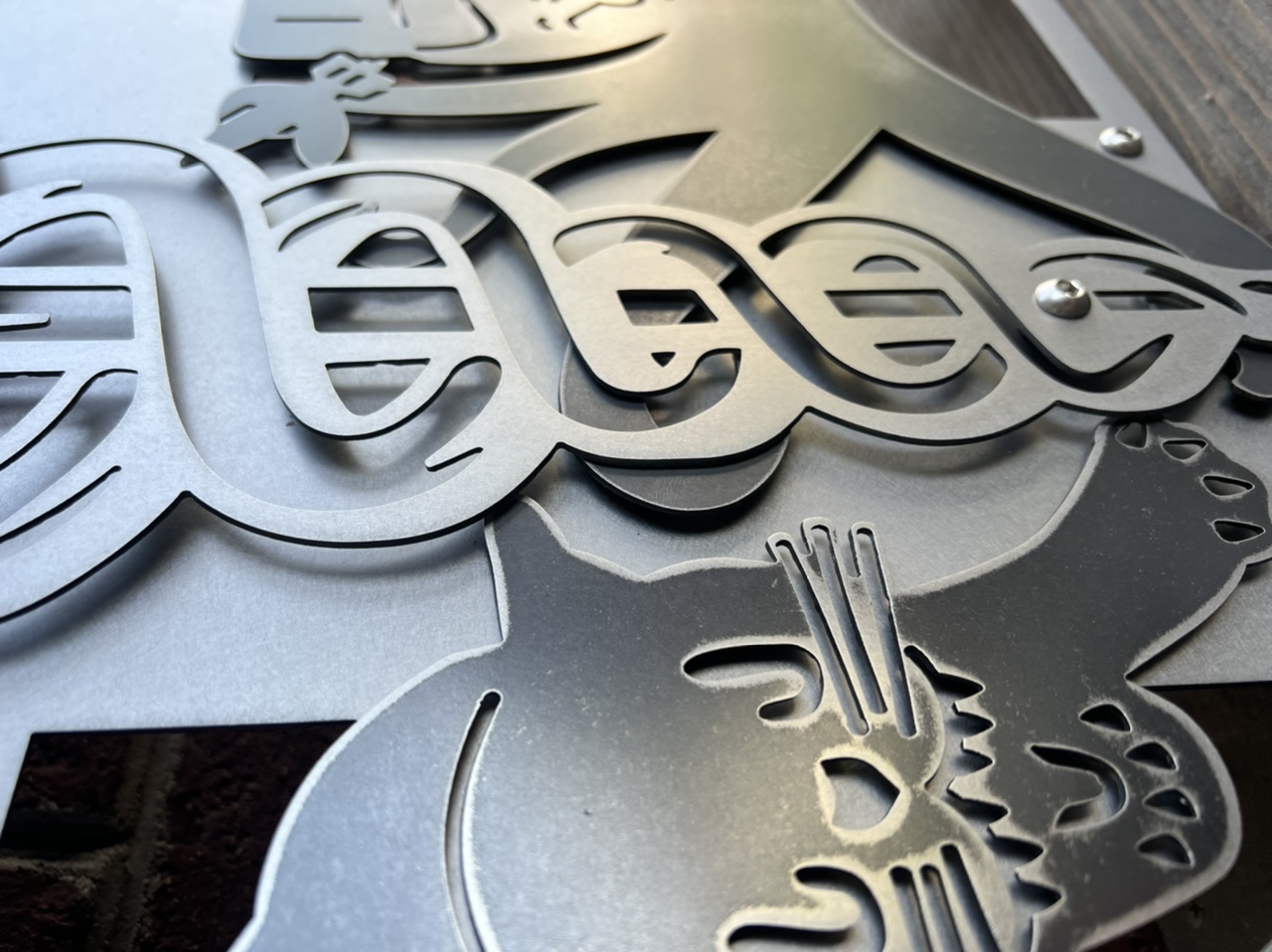

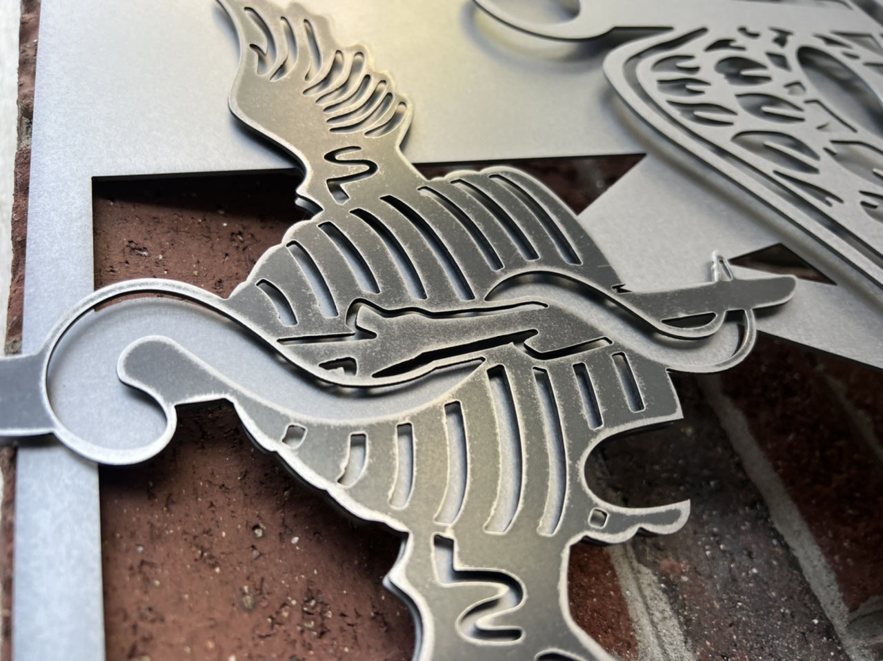

Here’s one of the latest. The laser is really coming in handy.
Laser? Did I miss you getting a laser? Engraving type I take it?
and I see this? how many layers is this, I thought 3 but is it more?
I think I’ve mentioned it before, maybe not. It’s a small one. 20 watt xtool D1. 18x38 I think? It will cut 1/4 inch acrylic and wood.
That design is three layers. 16 gauge with 1/8 inch Baltic birch inside.
Black Acrylic only, right?
Affirmative
