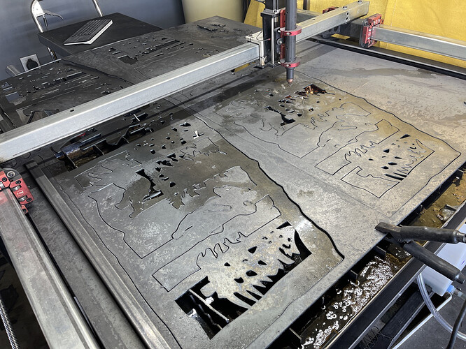

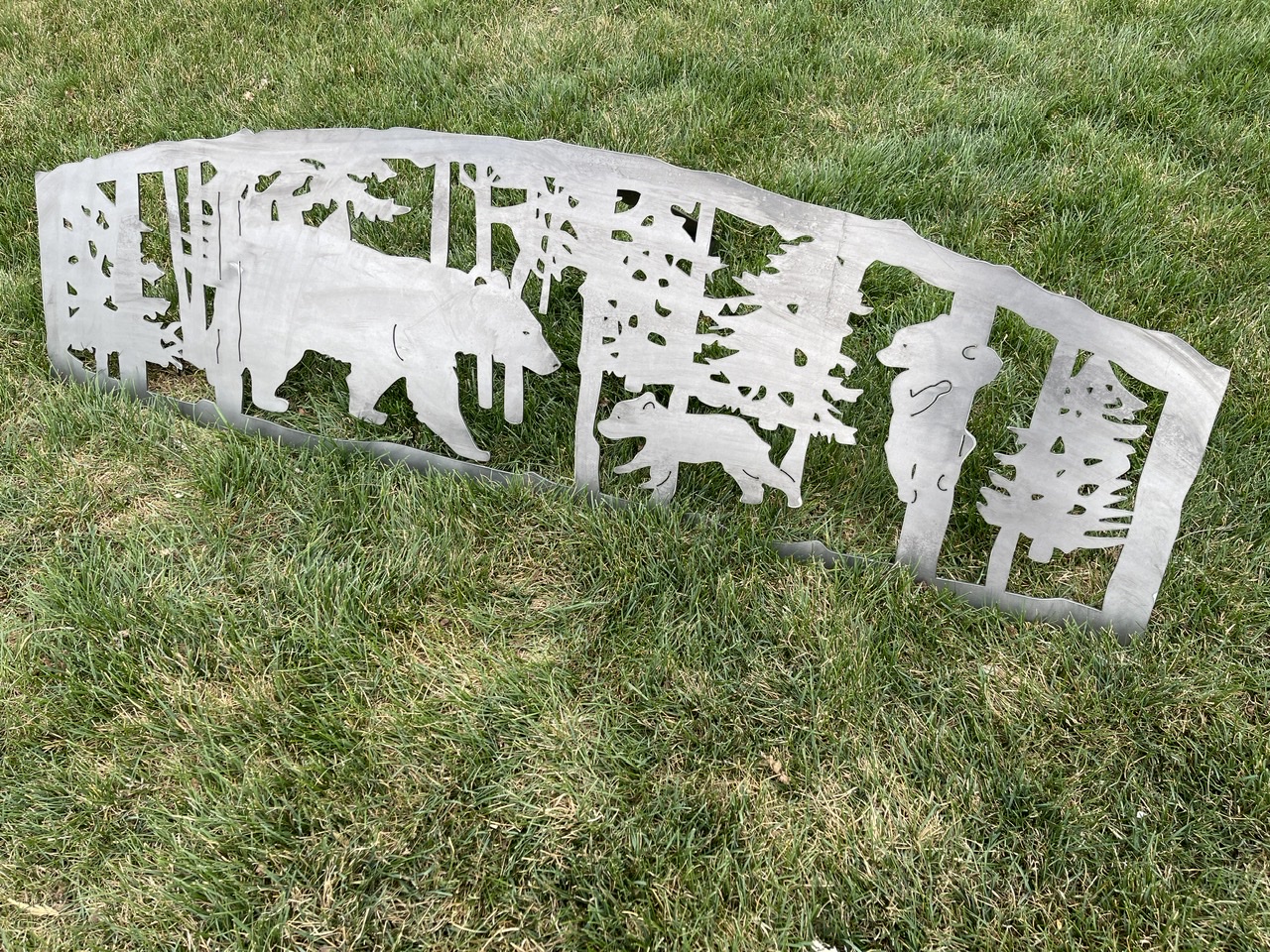

Had the table a year now, finally did an indexed cut. I missed by 1/16 but it sanded out fine.
Cool! Nice design!
Where will you use it?
How many segments did you have?
What method did you use to align each section?
Easy there Robert Muller.
Lol
It’s going to be on top of someone’s gate, they wanted one for each side. The “customer” is a handyman that does side projects for people. Perfect customer for me, I can design and cut and not worry about the install.
It’s 5 feet, so just two segments.

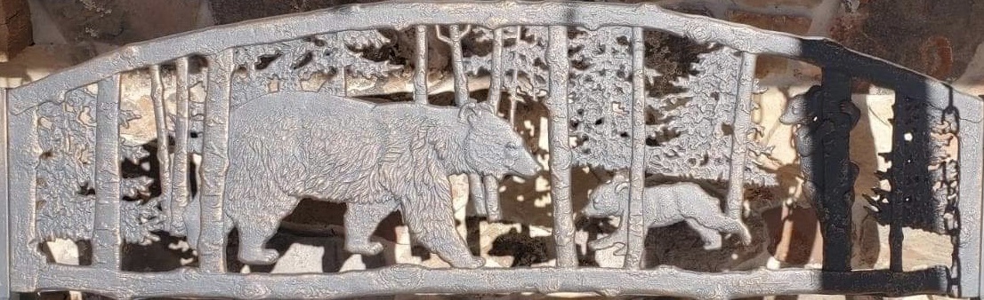

I googled how to do this, read for 4 minutes then had this idea pop in my head. Added a 2x2 angle bar to the left side of the machine then spaced out another inch with square tubing. I picked a spot as close to center as possible in the design that had the fewest lines to connect. I then drew a line down that spot, then broke all the paths I also added lines on the outermost edges so that when I imported into sheetcam they would automatically line up since they were all the same overall size. I did two separate program files in sheetcam. All the connecting lines were now open contours on their respective halves. After the first half cut, slid material up, checked via dry run, looked right then hit cut. Didn’t brace it properly and the sheet pulled up a bit throwing off the index, but you can’t tell unless you look at an angle to see where I sanded. Maybe an easier way to do this, but this is what made sense for me.
This was the source image.

Thanks! I learned a ton on this. Like using a wide angle lens to take a photo, then referencing measurements on screen that were taken in person…… is not good. But I’ve worked out a system to be able to reproduce this in the future much easier. It was a lot of fun to figure it all out.
