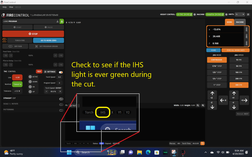

It is termed “hunting”. The THC is not getting the voltage that it needs. When the torch is closer to the plate, less voltage is required. If THC determined that you needed more voltage based on the “nominal voltage” or “smart voltage” then it rises to try to find it.
But…it is more likely this:
Or there is a loose connection with the IHS contact wires in the z-axis assembly. Do another cut and watch to see if you are seeing the IHS light come on. Every time it triggers, the torch will rise about 0.06 inches. If that does not turn the light off it will repeat. It eventually extends out of reach of the torches ability to make “fire” and turns off.
