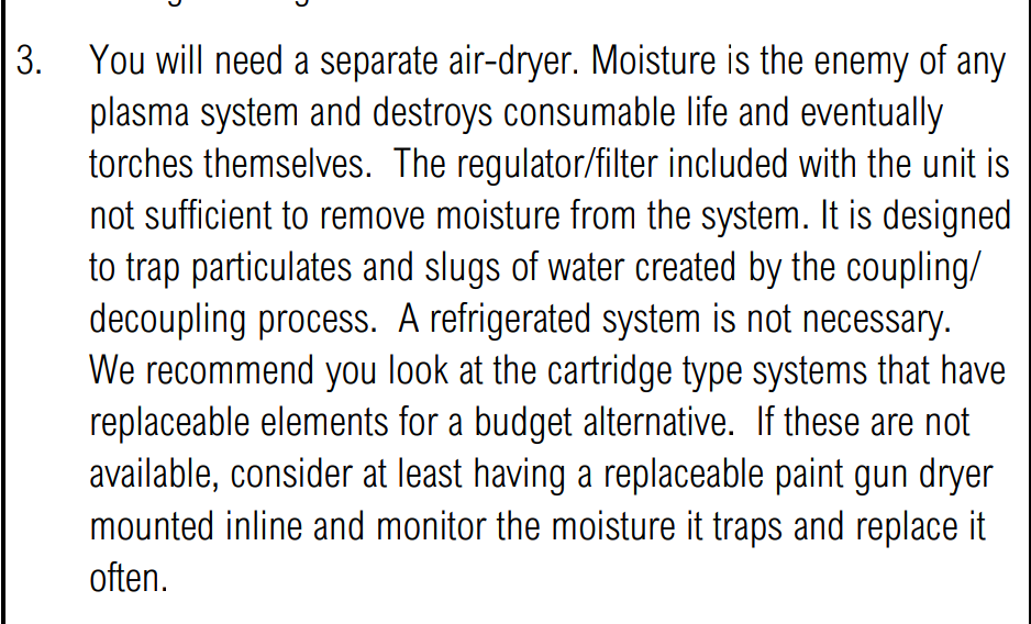

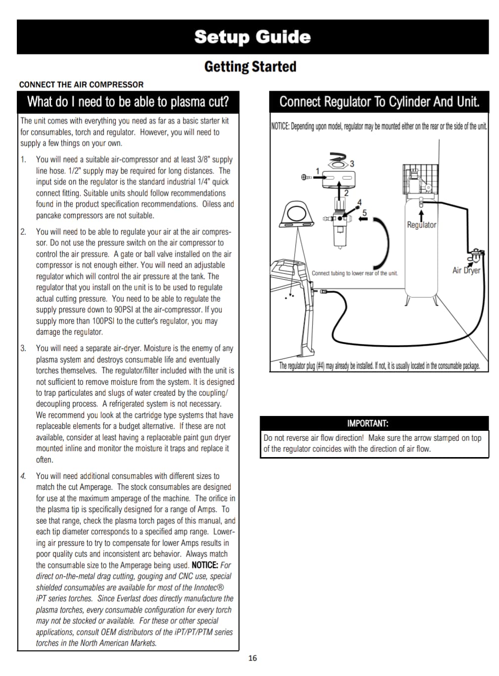

This maybe the reason you are now having issues with your Everlast solenoid.
In your Everlast manual page 16 it stresses the need for additional filtration.
“The regulator/filter included with the unit is not sufficient to remove moisture from the system.”
I would also disregard the statement “refrigerated air dryer not required” this would be a regionally and seasonally specific need. You may or may not need this to improve consumable life.
