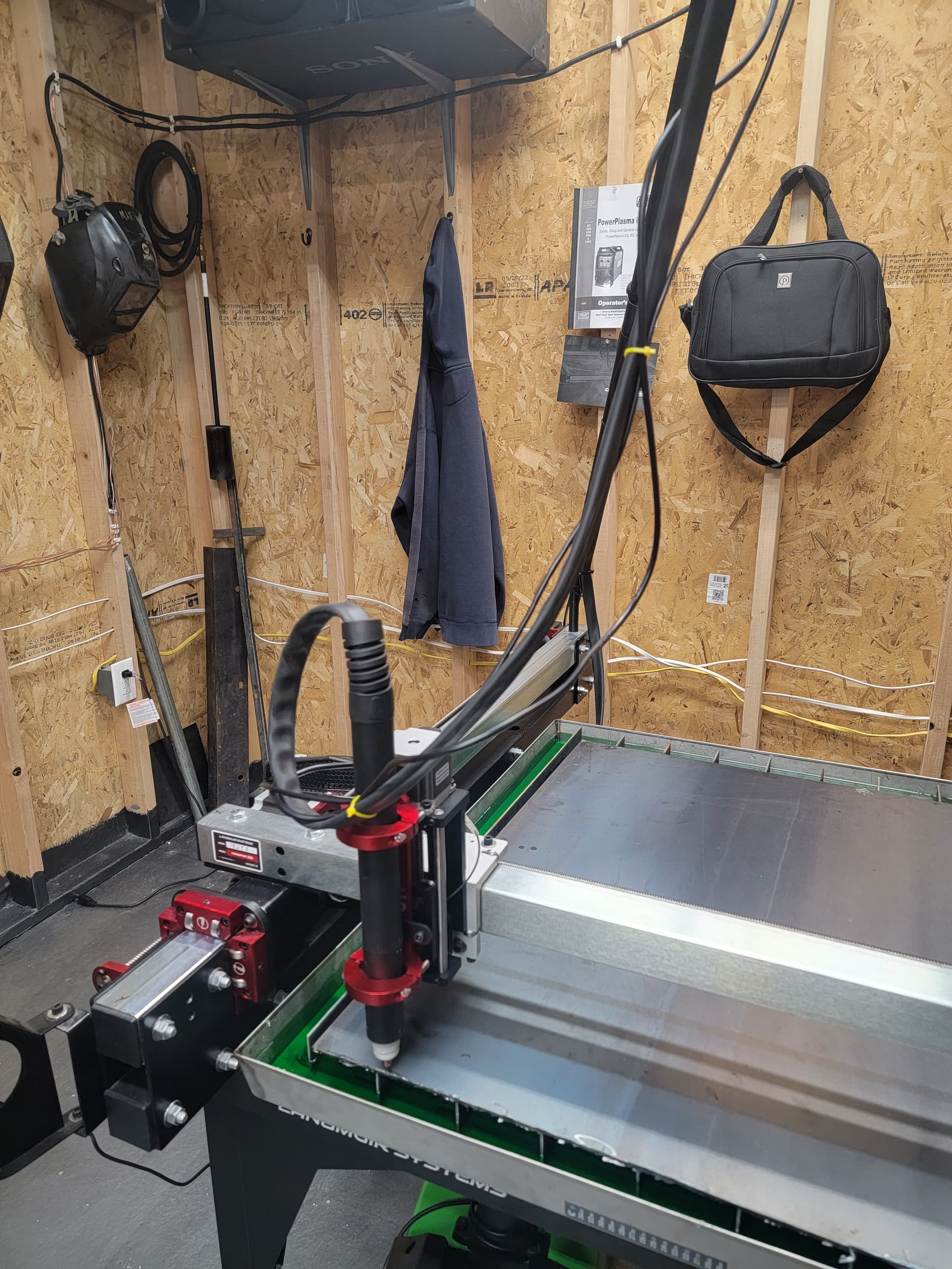

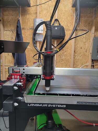

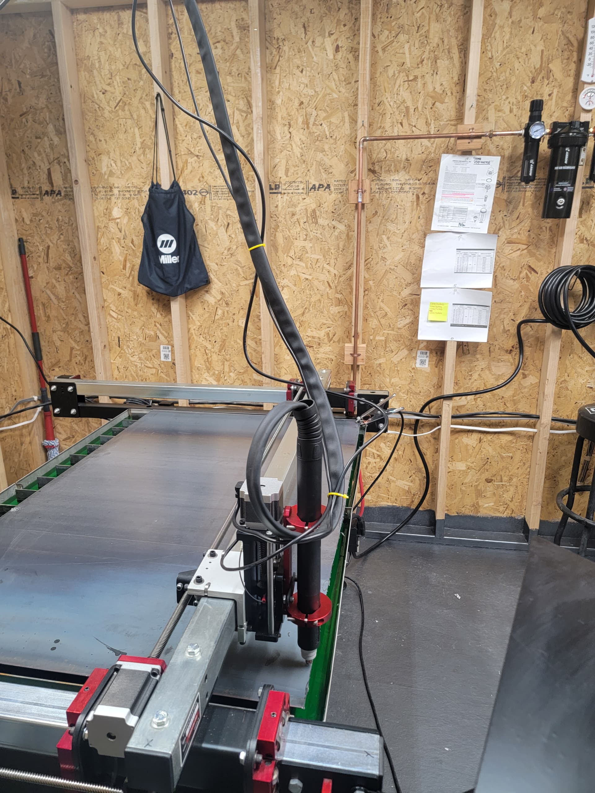

So we were working on getting are torch height controler working and in the process we could fire the torch at first but now the torch wont even fire anymore
Is your air turned on? Is the torch on/off cable plugged in? Its easy to step on that cable and break off the connector.
Where is the torch clamped down?

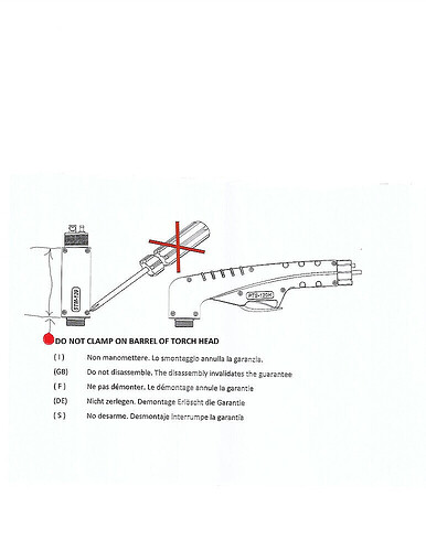

This picture should be in the manual…
We need more information.
Plasma cutter?
Torch type?
Pictures of your setup?
Yes the air is turrned on
Yes the torch on off switch is on

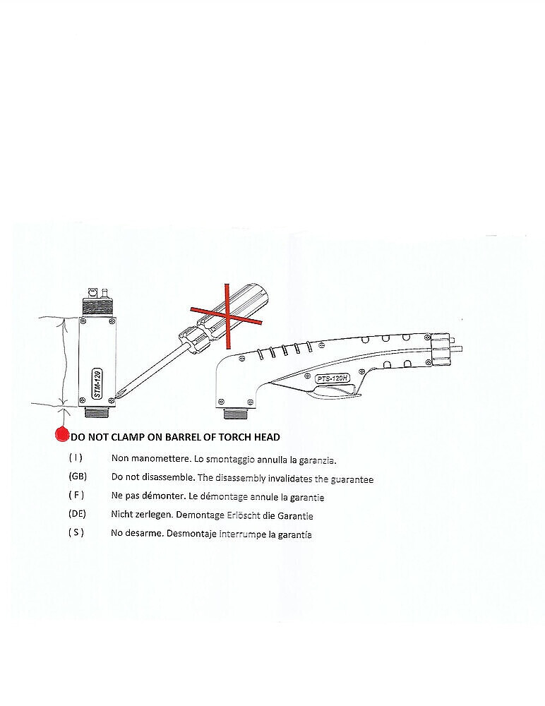

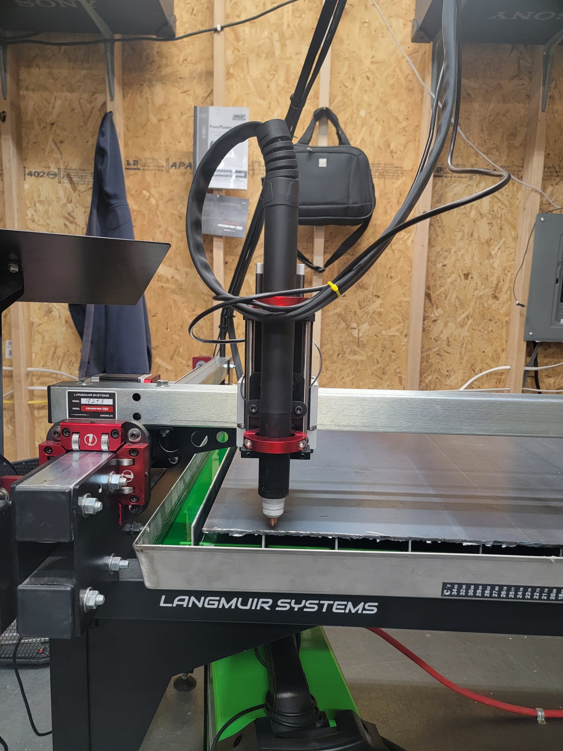

Move the clamp above the torch firing mechanism.
An internal plunger need to move freely inside to fire torch.
Can you elaborate
You have the bottom clamp on the torch firing barrel. Loosen the torch bracket move it above the illustration I sent you.
Also make sure your work clamp is in the sheet of metal.
Inside the barrel of the torch is a plunger that need to move freely to start the arc.
By clamping it where you have it will make the plunger hang up inside. Take off the nozzle shield cap and you should be able to push up the electrode with your finger. It should snap right back down in place.

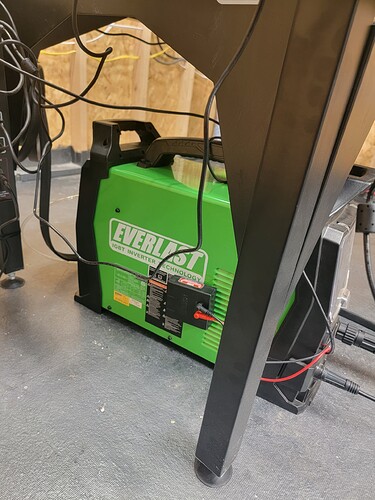

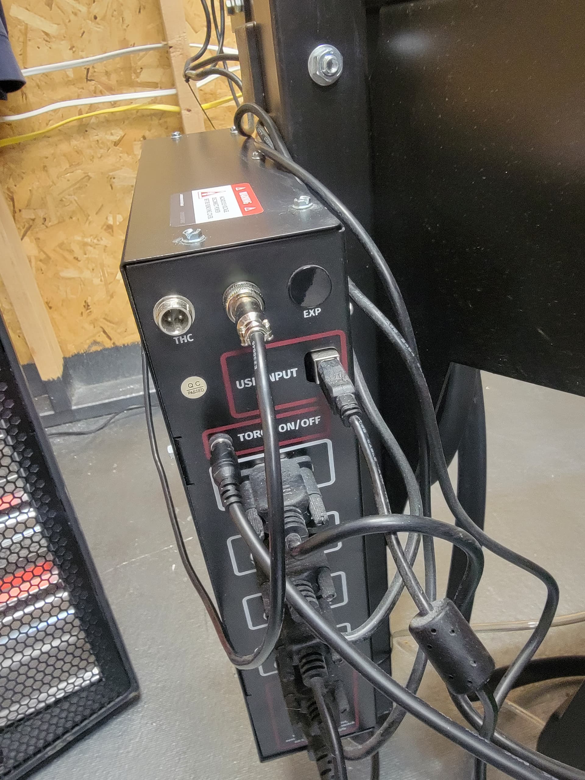

How are you testing THC voltage with nothing plugged into the THC port? There should be a wire going from the PV out on the VIM box to the THC port on the control box.
Got it fixed guys thanks im a dumbass lol

Why don’t you post what your problem was that way it can help someone else!
I didnt have it plug into the thc port
