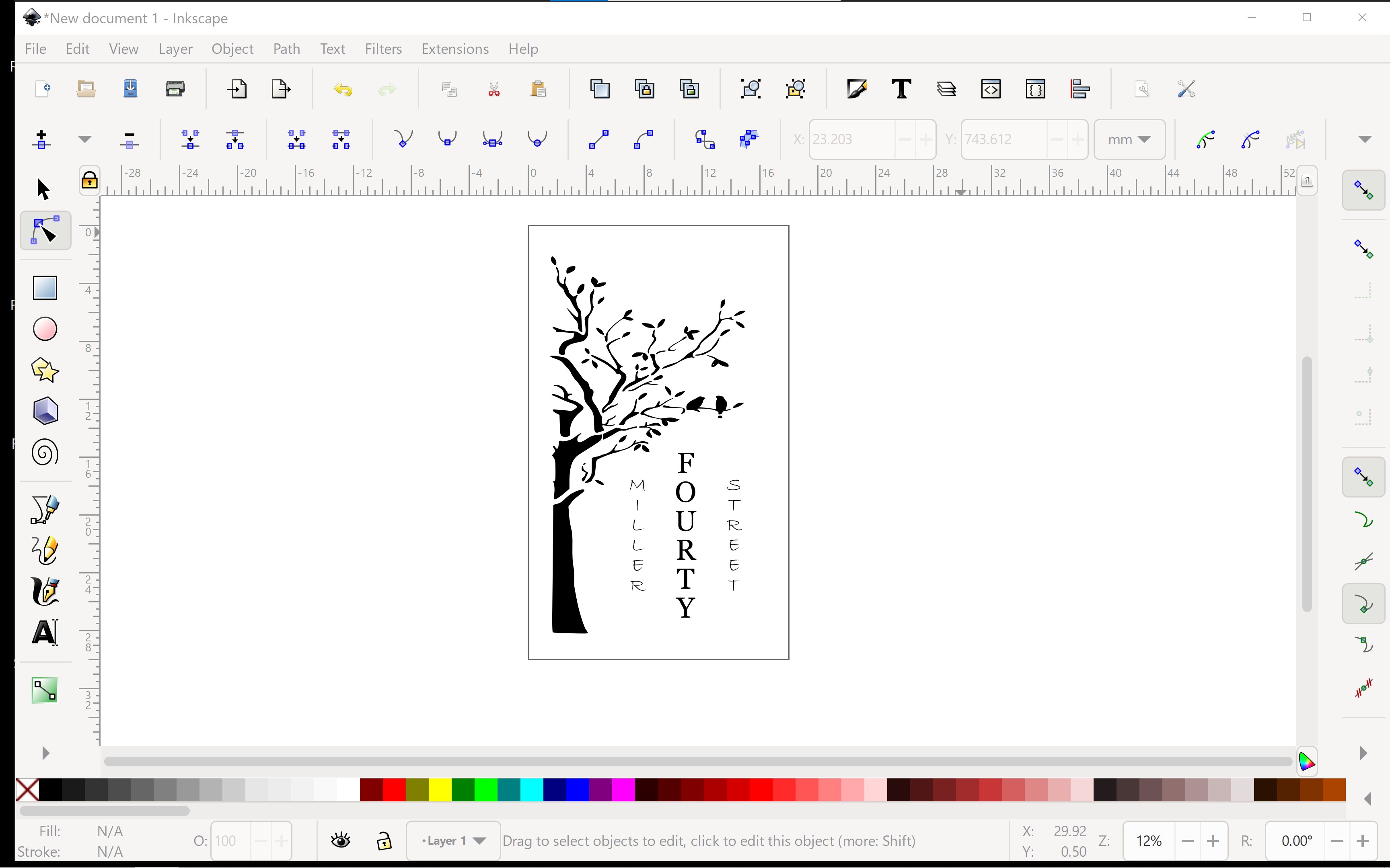

I’m back to a project i started and I’m using inscape to make this address sign. Before i go much further i’m in need of some help with the text.

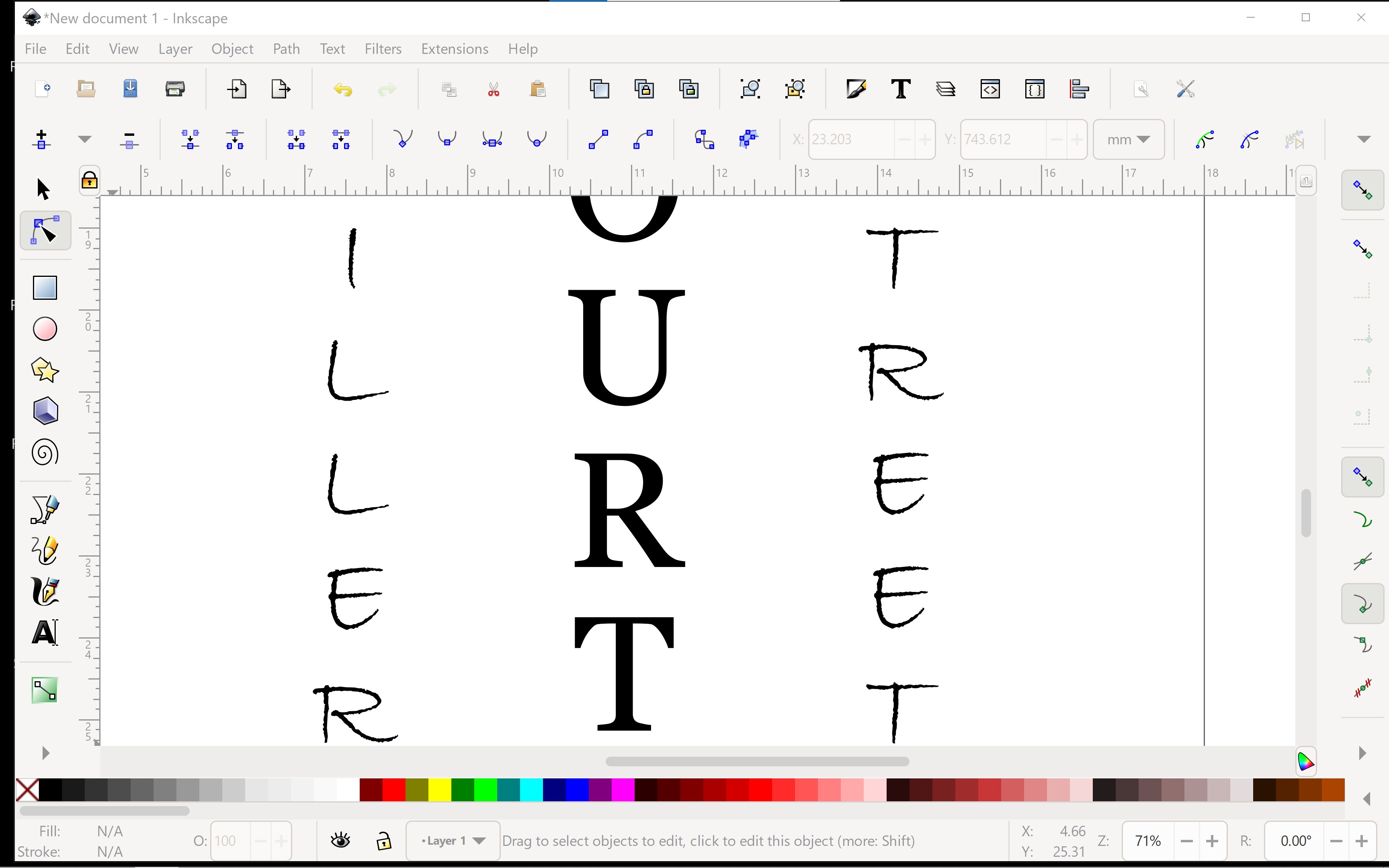

  1. Is it possible to fix the font in “miller street” so it is not jagged? I assume that will create an issue while cutting.
    OR
  2. do i need to pick a different font?
    I would like the letters to be completely removed, so you see through them, if that makes sense. Thanks

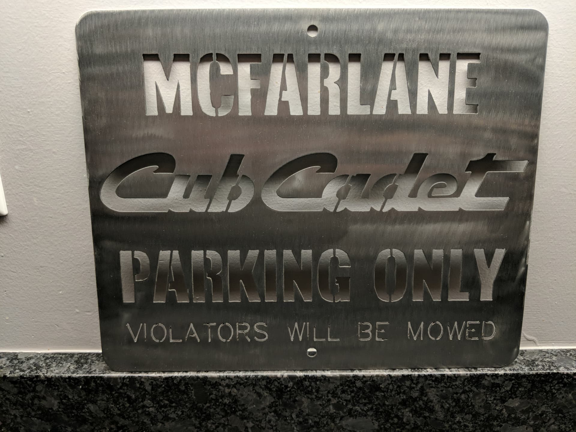

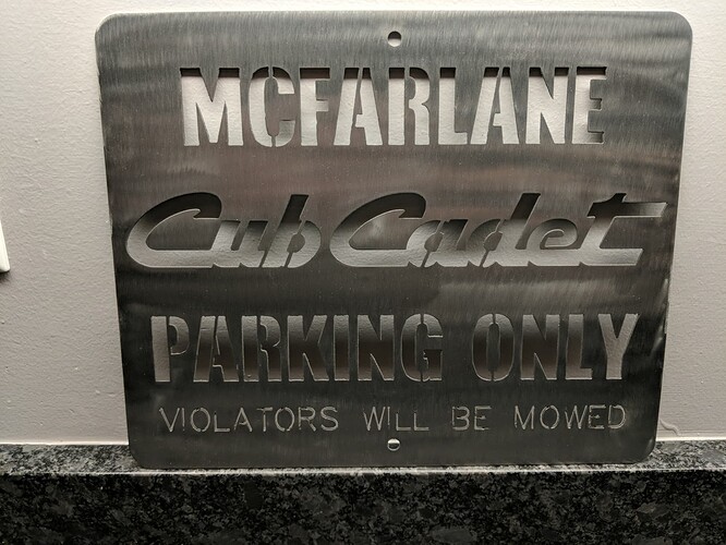

Single line fonts do cut,. And you can see them.
Just have to play with pierce delay to avoided a big hole at start, last line was single line font. 20ga ss

so your jagged font will come out jagged…what you design will be cut…
so if you are looking at what is called reverse cut…all that is black is cut out…then you have other problems…
the “O” and “R” in Fourty…will fall apart as the centers of the letters are not touching other white pieces…
Look at the sample provided above…it shows how letters need to be

One thing to keep in mind when using a vector drawing program is to be sure you’re looking at the vector image and not the “raster” (pixel) image. Everything will look jagged in raster view because it’s pixels and it can only be enlarged or zoomed in to a certain extent. Also, a lot of cheap fonts or some of the google ones even, will have odd nodes when converted to curves so there is always that possibility.
After converting text to path you can use simplify tool in Path menu to get rid of unnecessary nodes. Still might have to manually edit but saves some time.
I didn’t know that fonts were also raster, thanks for the heads up
That will make it easier, thanks
They aren’t automatically raster, you just need to confirm what you’re seeing is vector or raster. If you convert it to curves and you’ve got a crap ton of nodes then it’s just a messy complicated font.

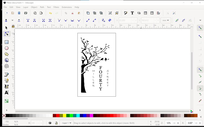

I could use some insight, Could someone look at this SVG for me before i go any further?
I was about to start making everything a path and combining them, I just noticed that i can not make the outside line/rectangle my cut line. What am i missing?
Also i need to make the tabs in some letters so they don’t fall out. thanksI’m not seeing the file here?

You’re missing an outside rectangle. I think you’re mistaking the bounding box for a cut-able graphic. It isn’t. You need to draw a rectangle.
You might also check the spelling of ‘Fourty’
