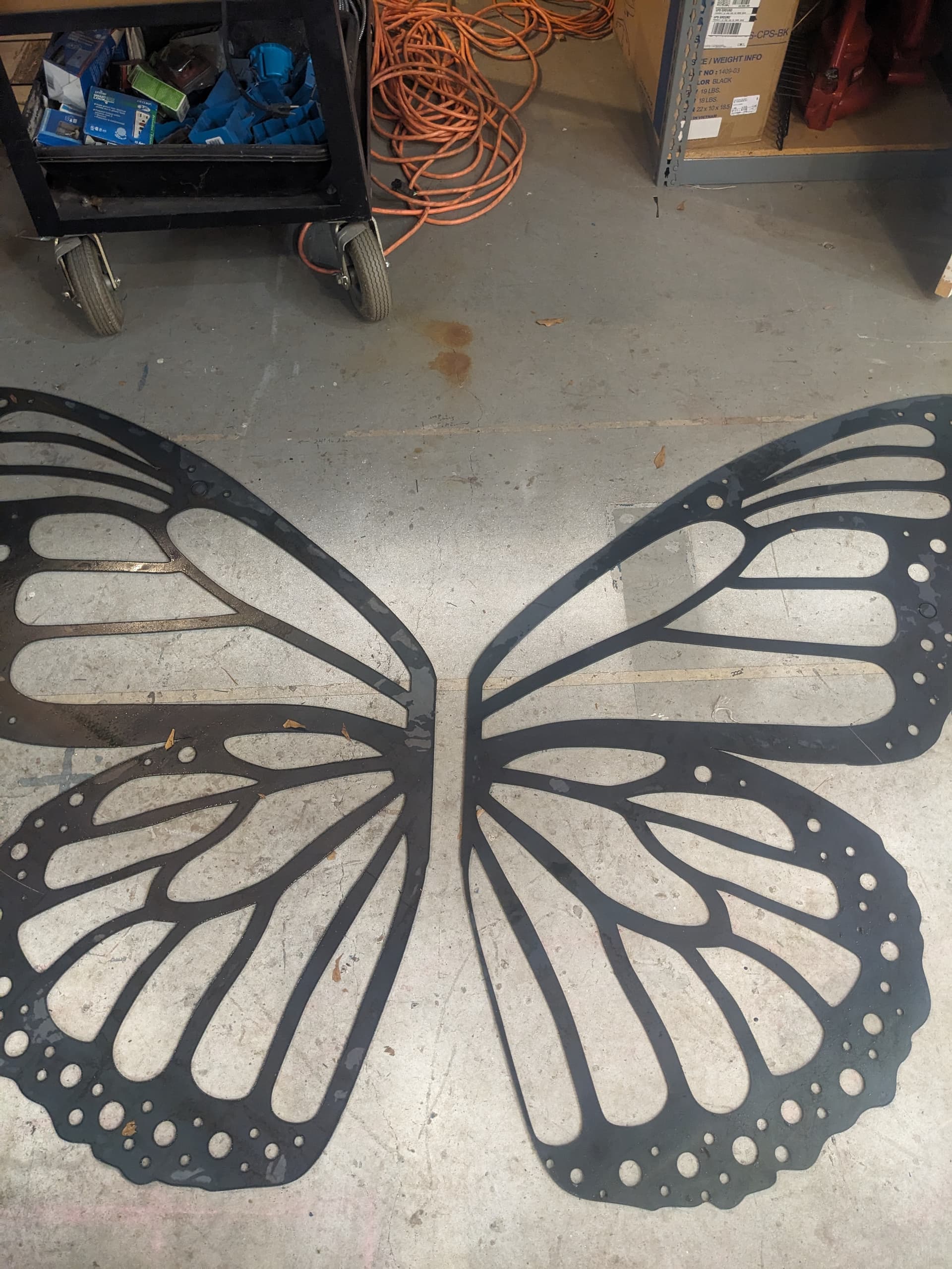

My crossfire xr sometimes doesn’t finish cuts. It will cut 99% but then leave a bit uncut. This has happened many times. I’ve swapped to new USB ports and that helps for a while but then it happens again. A new issue that happened today was the outline of my design was cut out of center of the internal parts of the design. I attempted to cut out two identical parts but one had the whole outside cut off center by a couple of inches. Any advice?

I didnt notice the machine getting hung up between the two cuts, i was looking at it when it moved between the two. it did all the interior cuts and then moved to the outlines for the last two cuts. The first out line came out correct the 2nd missaligned.

Update: I must have caught something during the cut because the whole torch assembly was miss aligned. I didnt notice this initially. I straightened it out and it moves and cuts smoothly again. I am still having an issue where randomly one or two cuts get cut 95-99% through but dont completely finish before moving to the next cut. it doesnt happen every time i cut something, seems random.
