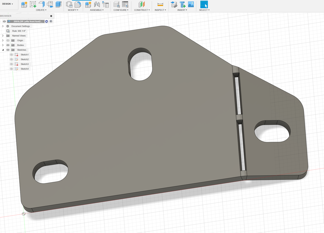

Trying to slot out the bend lines for forming. In Design, when the part was modeled, I unfolded the sheet metal. Then, I drew a new sketch using the largest face as the sketch plane. Projected the bend lines, and modeled two vertical slots, extrud cut the two vertical slots.

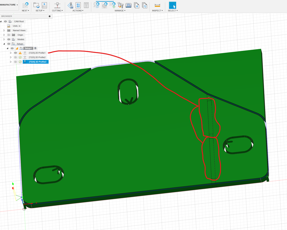

The modeled part looks correct. However, I can not get F360 in Manufacturing to allow a tool path inside the two vertical slots. I get an invalid linking warning.
Even started from scratch and tried two different-sized vertical slots, Zippo. The modeled slotted hole features cut fine, just not the slots.
Part as modeled:
Bend line slots projected and added:
Manufacturing fail:
Do I need to project the whole flattened profile and make a new part to the slot?
It is all about the lead-in/lead-out. There needs to be room. If there is not enough room then Fusion will disregard it. Just to show that it will work, remove the lead-in/lead-out and see if Fusion calculates a cut path.
That slot is about 0.1 inches and your lead-in is about 3x that. Reduce the lead-in to something like 0.03 or even smaller. It might be a little ugly but it is for bending, not for admiring. :man_shrugging:
If it still doesn’t “take it” you may need to give Fusion a “Preferred Lead-in Location” on this tab. In this example, it would not even be worth trying the “preferred lead-in” because I can tell it wouldn’t fit:
Now reducing my Lead-in to 0.1 inch radius, it fit:
