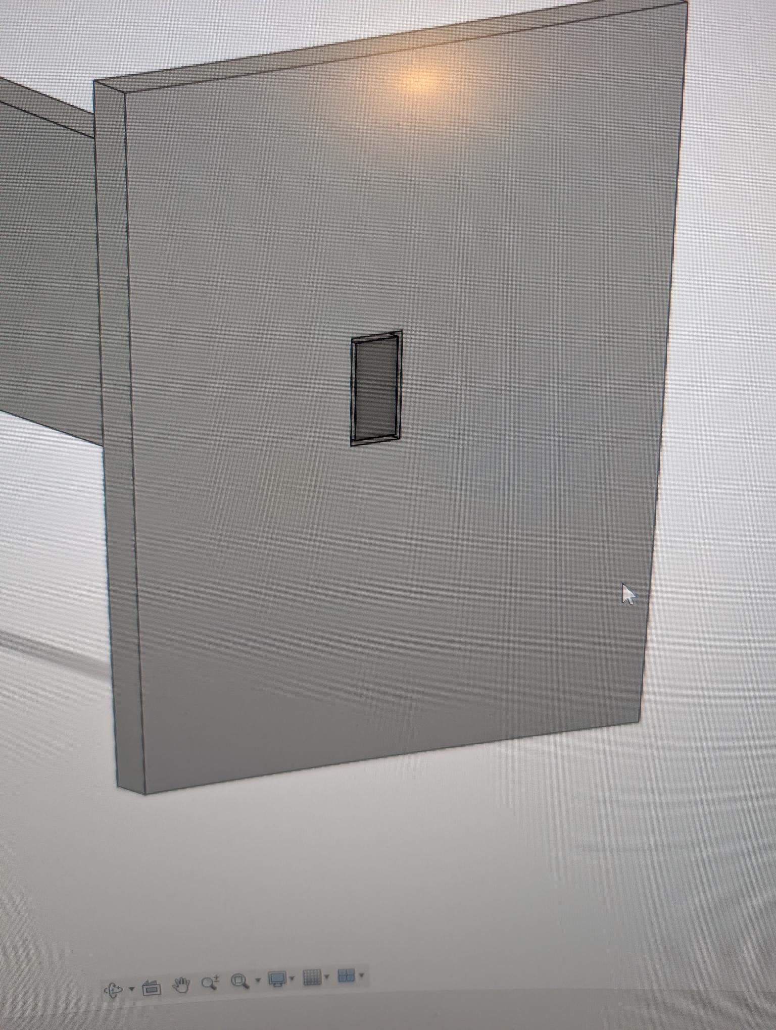

I am starting a project that has lots of tabs and slots and I was searching for a way to do this somewhat easier than actually modeling them as that is pain for more than just few.
So I ran across two fusion add-ins that really seem to help a lot. The first is “box joint”. The second is “nifty dogbone”. The first is free and the second has a 60 day trial with a one time $20 fee following that.
The most useful for this task seems to be the box joint addin yet I could see the dogbone addin having value for this or other projects.
Nonetheless, with a little goofing around I quickly did these.
Outside joint:
As you can see I added dogbone’s to this as well.
Outside joint with odd shaped pieces:
Connection mid piece:
Other notes:
To get the dogbones to work I made box joints with 0 tool radius. Super surprised that worked by way happy.
The last pic with the tab through I put in an offset face on the four sides of the slot for clearance. I would have loved for that to be built into the software but not complaining.
I haven’t cut these yet but I am sure I have enough here to make nice work of this.
Tab width and tab count are adjustable, I just don’t see a need for more than one tab for my application because I am really not doing a “box joint” like you would want it wood. I need alignment and welding location.
Also I am no expert on these pieces if software. I just played with them for less than 15 minutes and got something I can work with.

Just a couple tips for tab and slot. I would suggest .007" clearance all the way around if you are laser cutting and .010" for plasma cutting. Also put a corner relief like this. I also don’t bring the tab all the way through the slot so that you can fill the void with weld. Just a couple tips I’ve learned over the years.
I also add the corner reliefs on the tabs as well.
