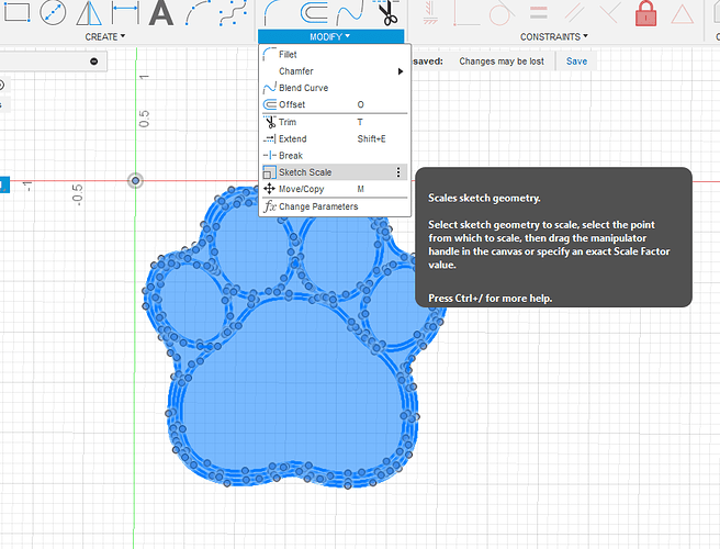

To the best of my knowledge, there’s not a calibrate for dxf or svg import. However, if you have a defined section (line, circle, arc) that you can measure, the scale command (in sketch) will solve your problems.

There is a scale in sketch. 2nd tab, modify i believe. (Away from pc atm.)

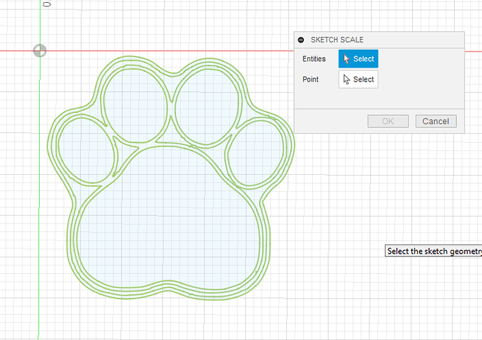

When you insert a DXF or SVG file, you will be able to re-scale it if it is "unfixed’ (blue). If it is “fixed” (green) you will need to “unfix” it to scale it.
Fix/Unfix constraint:
Fixed. No matter how long you try, you will not be able to select the fixed entity.
Unfix it and it is putty in your hands:
Any sketch or portion of a sketch can be rescaled if it is unfixed. There is a caveat to that statement: If you rescale a portion of a sketch, that has some aspects of size/constraints driven by other areas of your sketch, it may react other than how you expected. Or may refuse to do the re-scale operation.

I am still a bit fuzzy on this term. I realize to dimension a line the sketch had to be put in “edit sketch” mode. It would also need to be “UnFixed” (blue). Is that what you mean by UnLocked (blue)?
This is the step I was missing. I knew how to unlock but could not figure out how to size it unless I was using canvas. Thank you!!!
I was hoping you would chime in. I rely on the brilliant people on here for instruction. This is all making sense now. I will be drawing more tomorrow and can not wait to try this. Thanks!!!
Yes this is the tool I mean. the unfix / fix tool which has a padlock as it’s icon.
