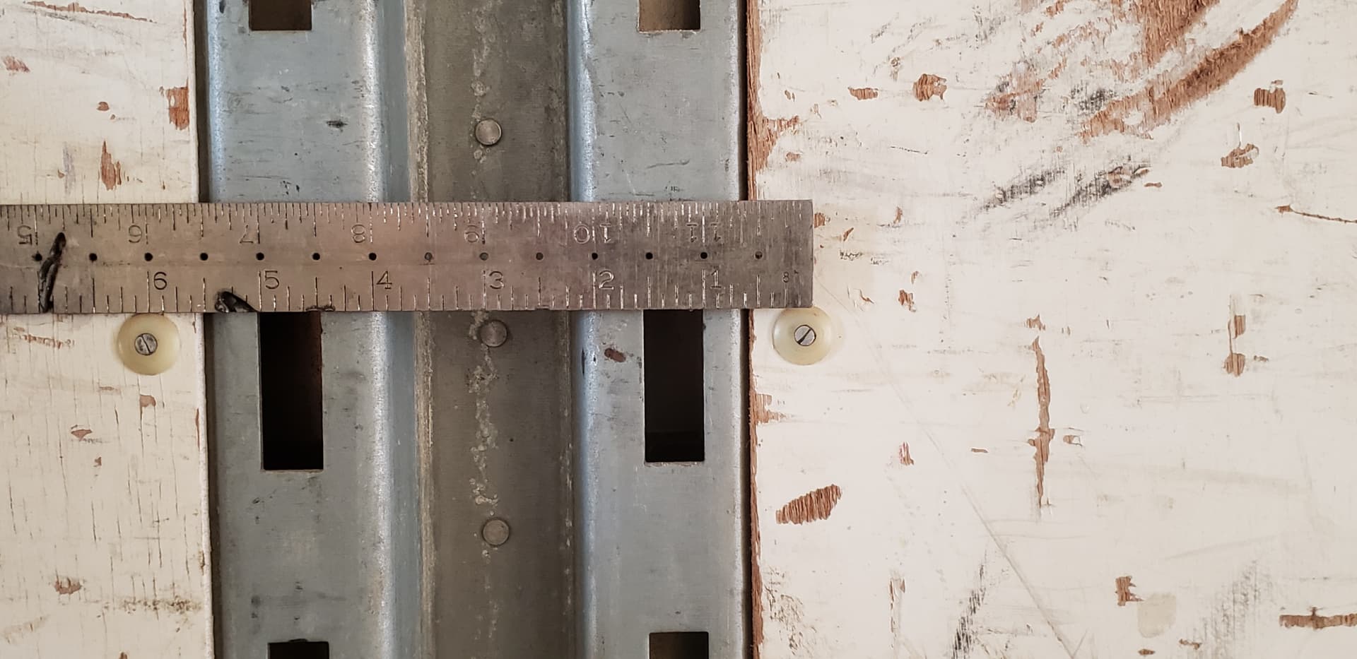

The E-track is ~.125" and 6" wide in kind of a hat channel design, floor to ceiling. It’s pretty stiff. My mill/lathe weighs about 750# and I am able to lift it off my bench by running a chain from both sides then a lever hoist down to the machine. That puts a lot of inward pulling on the track and it stays put.

The E-track is not your standard flat track that are put in as an afterthought These are a hat channel with a 1.5" rise from the flange - basically a C-Channel with wings and .125 thick and 6-8" overall width. Then the trailer skeleton on top of (well behind) that.

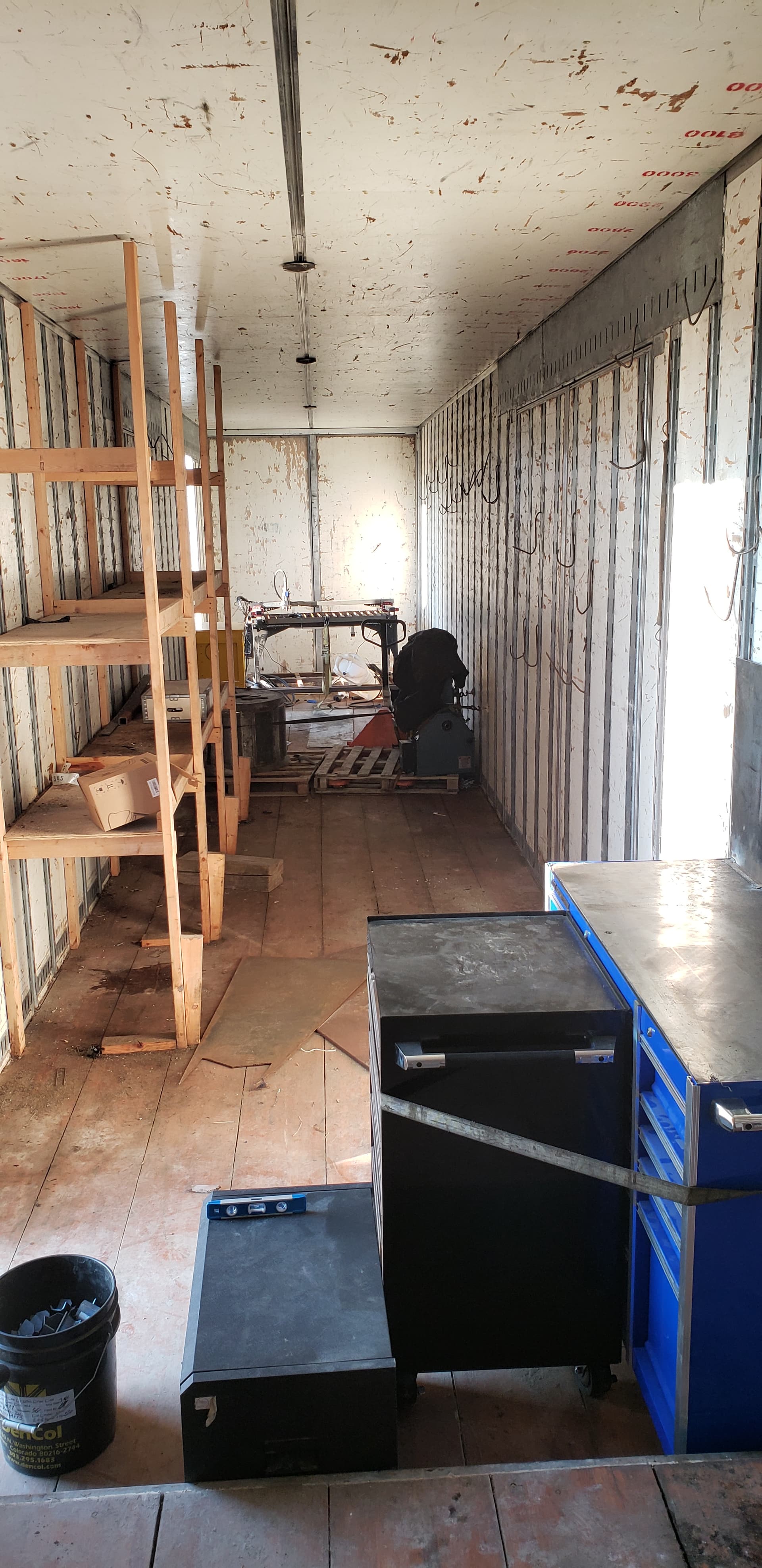

I’ll post pics of what I have to work with next week when I get back to the job.

1/8" is definitely not regular E-track, 72Pony is right though you should get the load specs from the manufacturer. All E-track is basically hat channel, but not 1/8" or 8" wide. I can’t wait to see the pics!

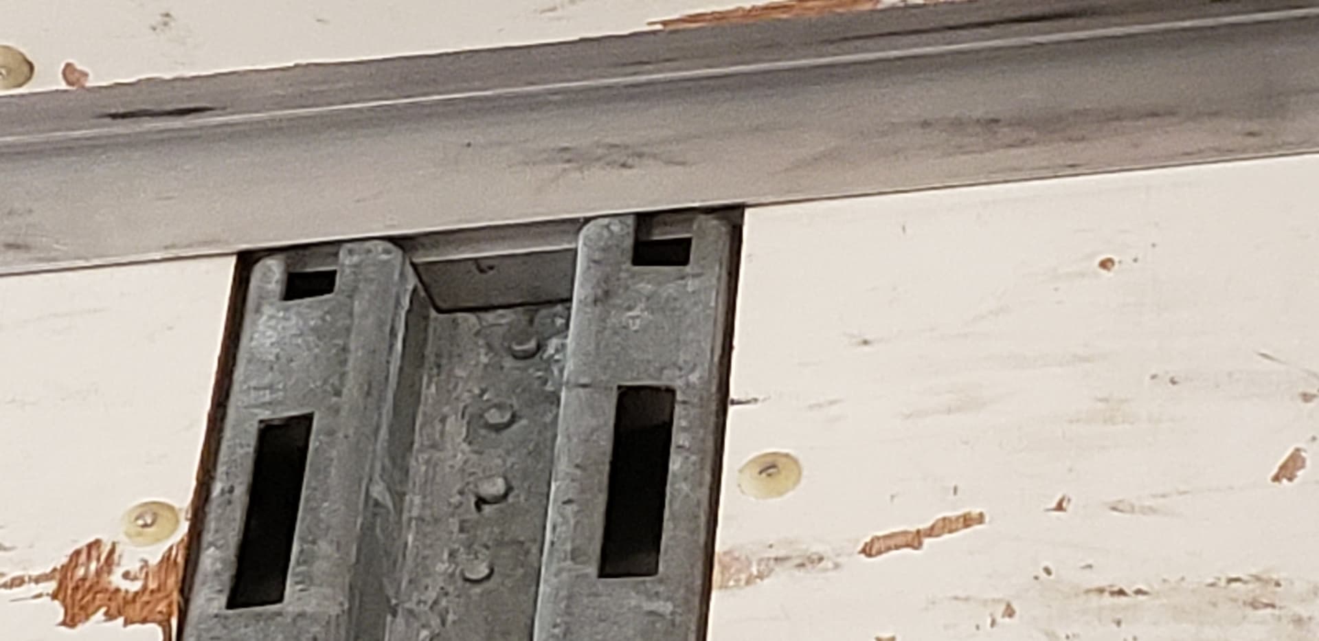

16" centers, pretty stout posts. The outer skin is riveted to the posts, and the plywood anchors are 6" on center, to the posts are likely 6.50 wide, if not wider.
2000# max is all I am worried about . The average use will be a 4x4 of 1/2" plate or sheet of 1/4 plus the weight of the carriage. 550# +/-?
Is the wall post center only buck riveted to outside wall panel or is the post edges as well? If edges of the post are buck riveted, then your idea will work. But make sure that top roof rails as well as bottom rails are one continuous piece have not been spliced due to repairs and that buck rivets are hardened (will have a small dot on head of buck rivet if hardened).

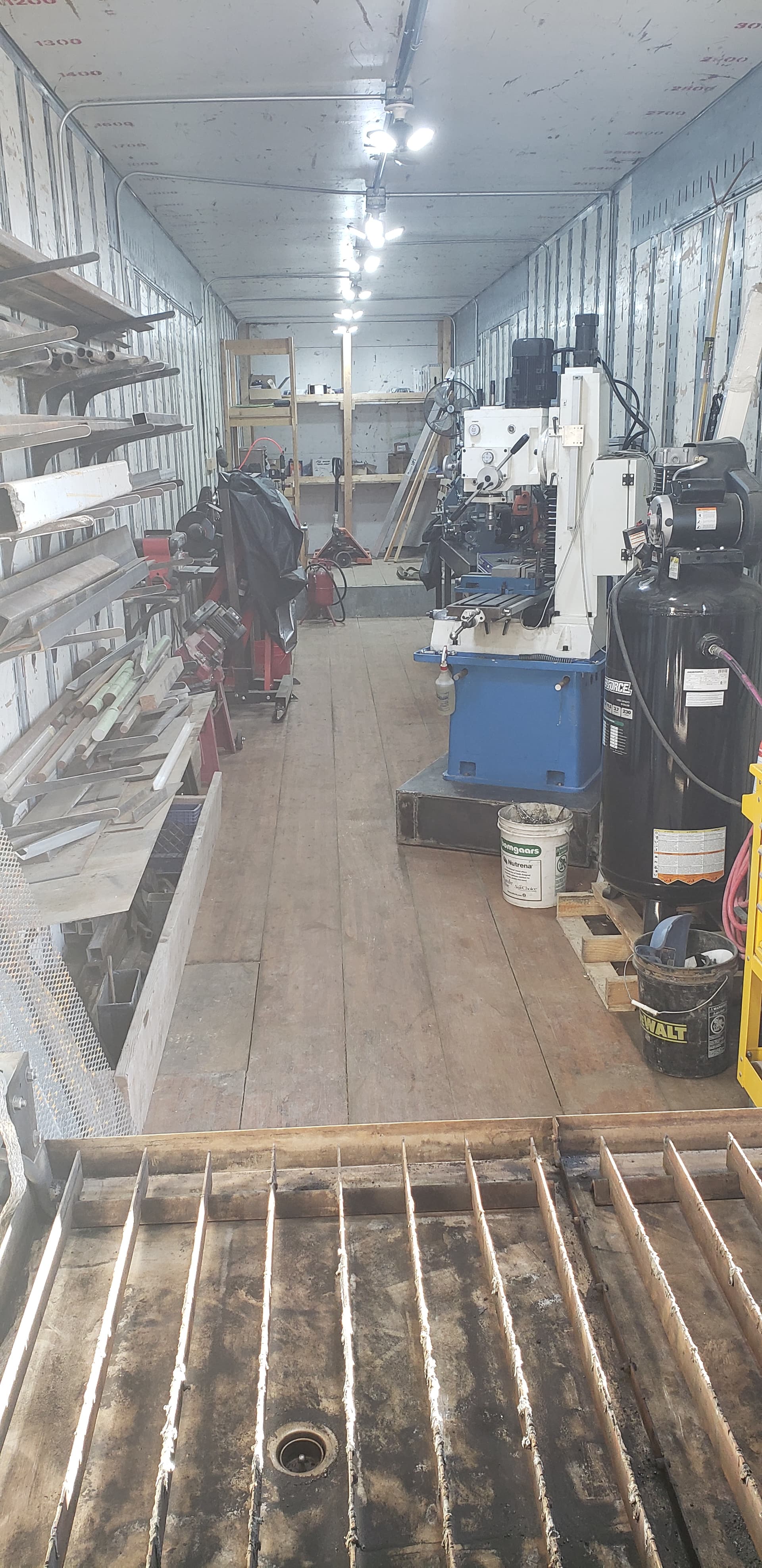

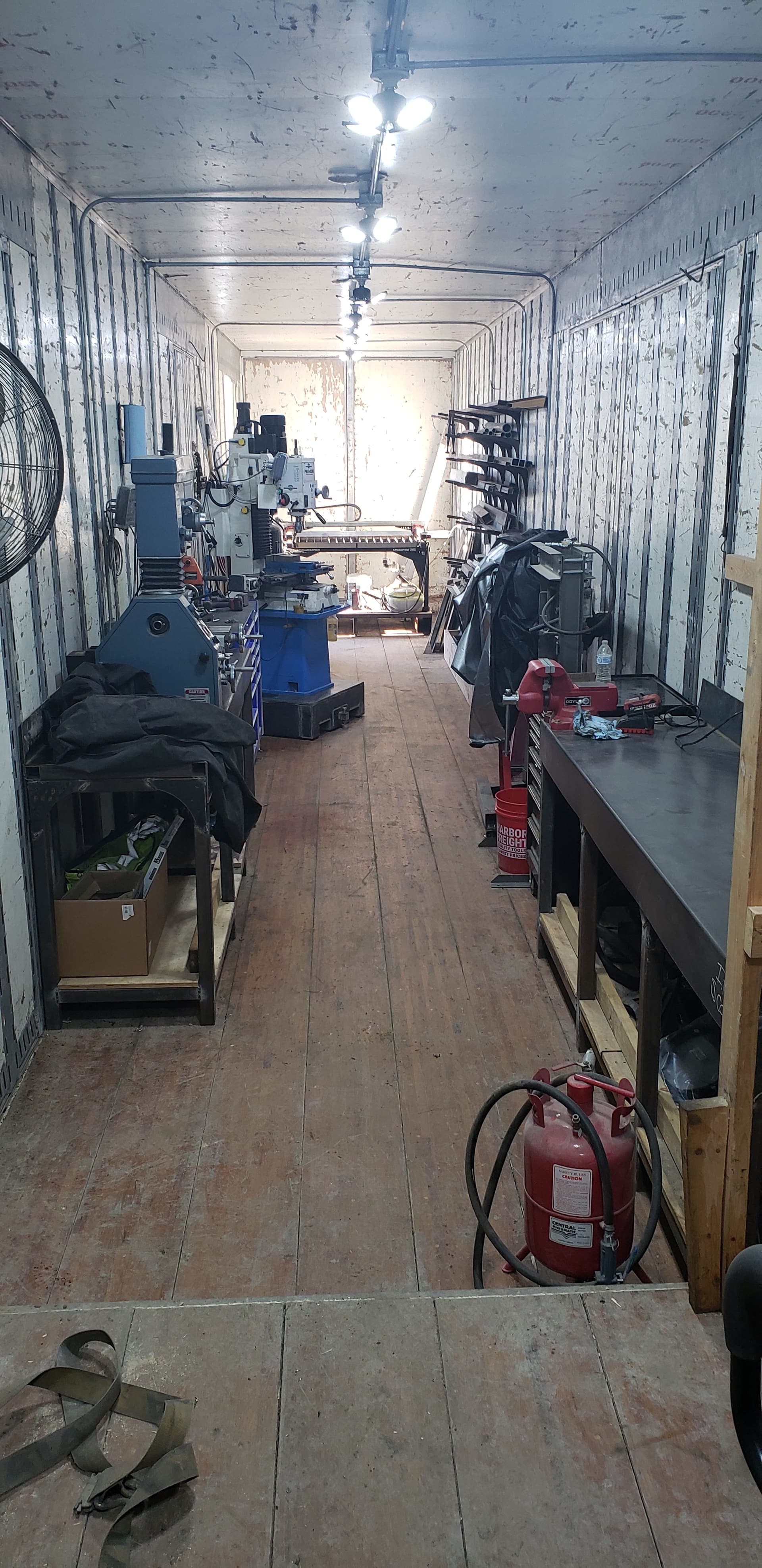

Some progress in getting it set up. Still working out the details for the overhead. I will likely be putting in some vertical posts with a cross brace along the roof every 6’.
