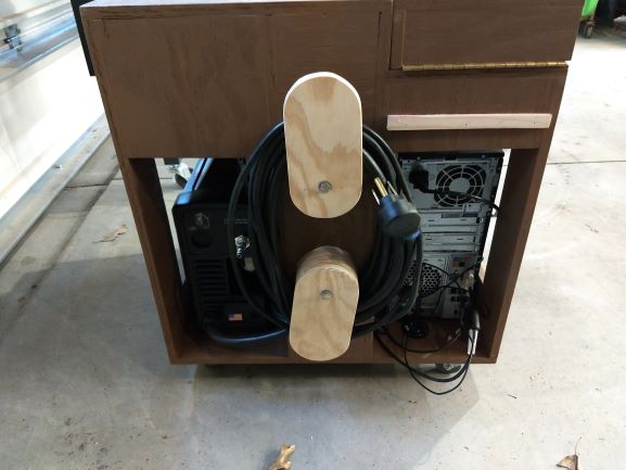

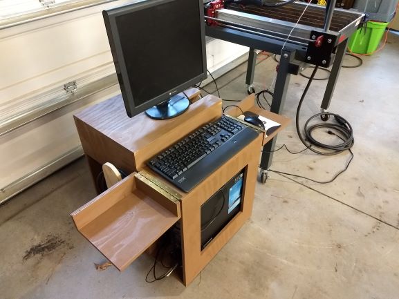

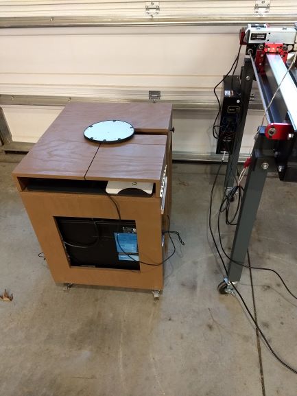

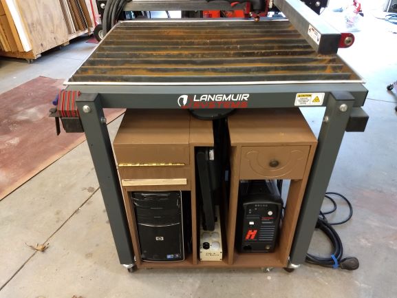

I am using an old Desktop PC rather than buy a laptop for the CrossFire. Storing all the components was a challenge. Here is the solution.
Clever solution. I like the upside down hanging monitor storage.
That’s great. Just make sure you unwind all of the power cords for every use. Machines don’t like the added inductance.
Nice compact storage unit, like how it nests with the table. Coiling a power cable, if the cable includes both the current in the hot wire, and the equal returning current in the neutral wire, does not increase the inductance.
Cables are unwound completely in order to plug them in. This is just for storage. Thanks for posting. I didn’t think to mention that .
