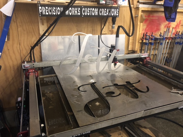

image Got 1 cut done today and went to the next job,

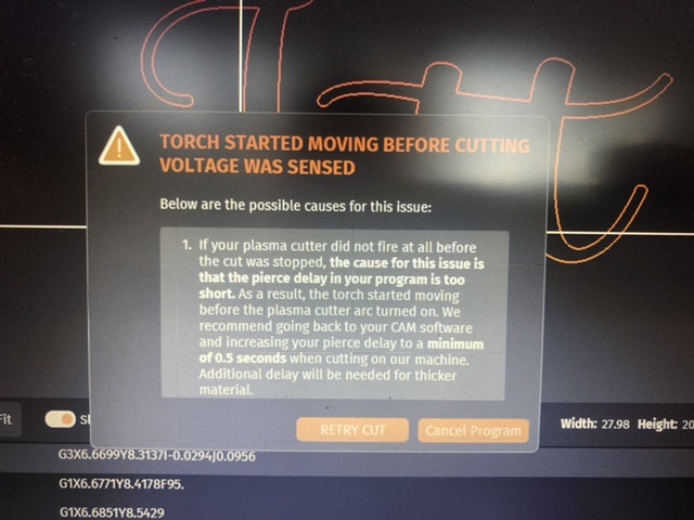

Torch fired at Pierce point moved a bit, then shuts off.

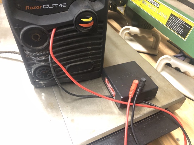

Check the THC cables and box for wear, loose connectors, metal dust buildup, or any obvious or not so obvious signs of damage or moisture.
How are you wired to your plasma cutter for the THC? If a CNC plug, verify all the pins are in good shape and making their connections properly between the plug and receptacle; if hardwired make sure splices/connections are tight and nothing is shorting in the case.

It’s Hard wired inside and there is a post on here that Langmuir links to I did of the proper wiring and pictures I posted during the wiring…

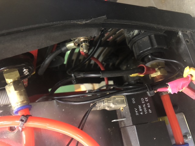

ok NTook the cutter apart today.
Ohm’d all the cables & bananas connectors to the module. Ohmd the ground cable.
Everything was :white_check_mark:
Cleaned the ground cable. All my wiring from a year ago was still perfectly fine. Reassembled
Everything. I also checked the air regulator, no leaks and I bumped up the pressure from 70-80 psi. Been running at 70 for years but I have a new torch coming that needs 80 anyway.
Also cleaned out the ground lug connector…

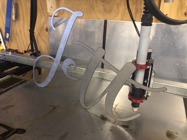

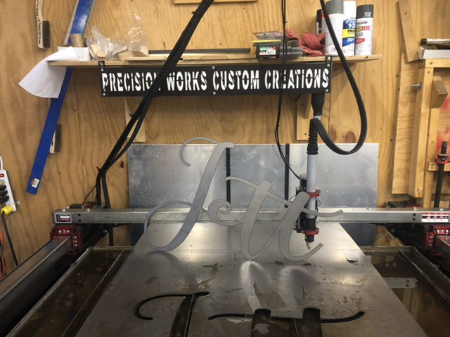

Ran the THC health check test and eveything passed this time. Cut a few handles out to check function and they went fine so I loaded on a new sheet and cut the 28” monogram out…
And it cut flawlessly!

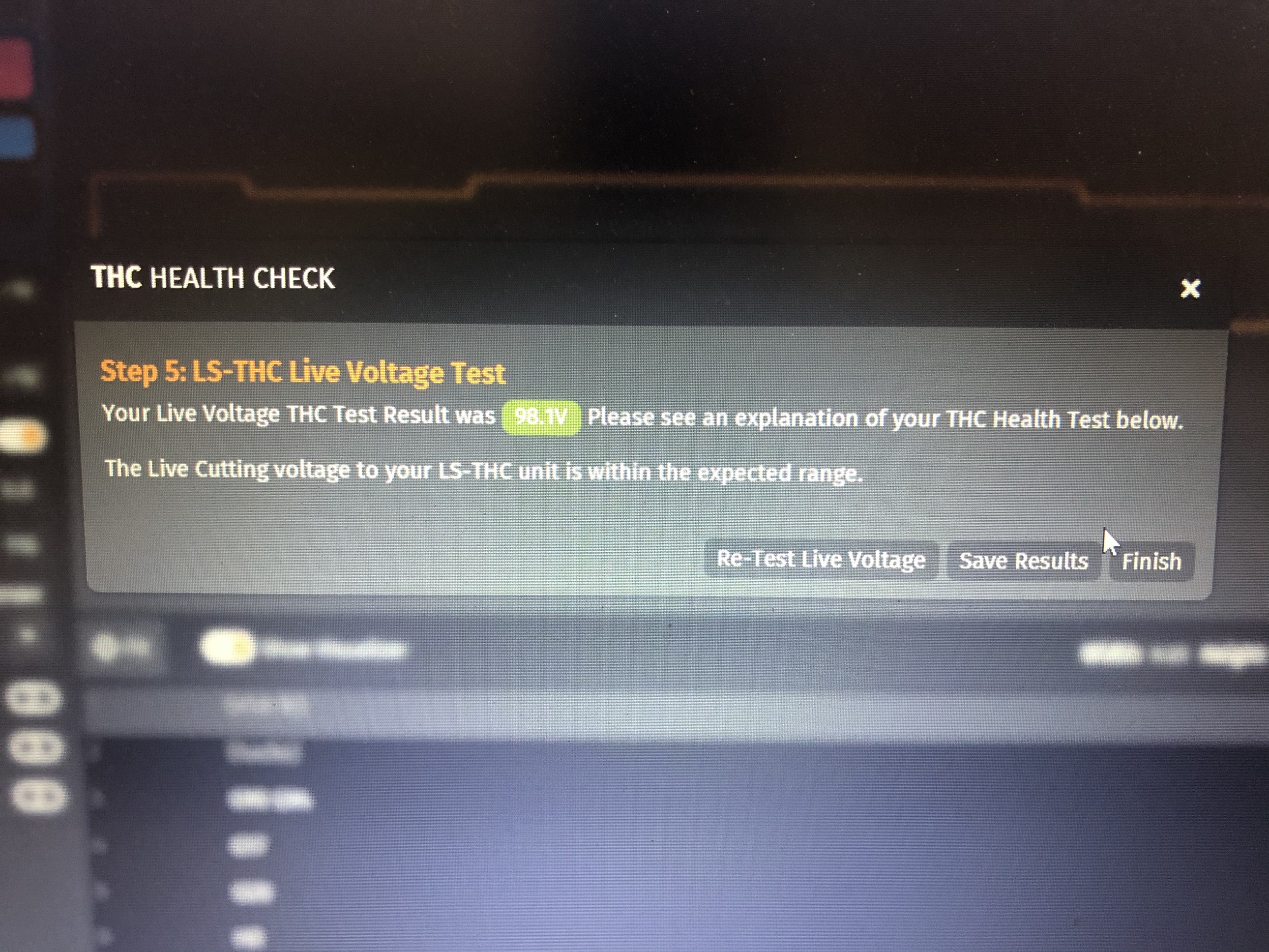

It asks you to move the Z 1” above your slat or material. Then it fired the torch and measures the voltage. As soon as you see it fire you tap the torch on button and fire control shuts it off it does it three times and it gives you the test result…
Yesterday I was only at like 7.1 V today it was measuring 98.1 V
:man_shrugging:
Thanks will look into it :beer: what should it read?
98.V. As per the result
