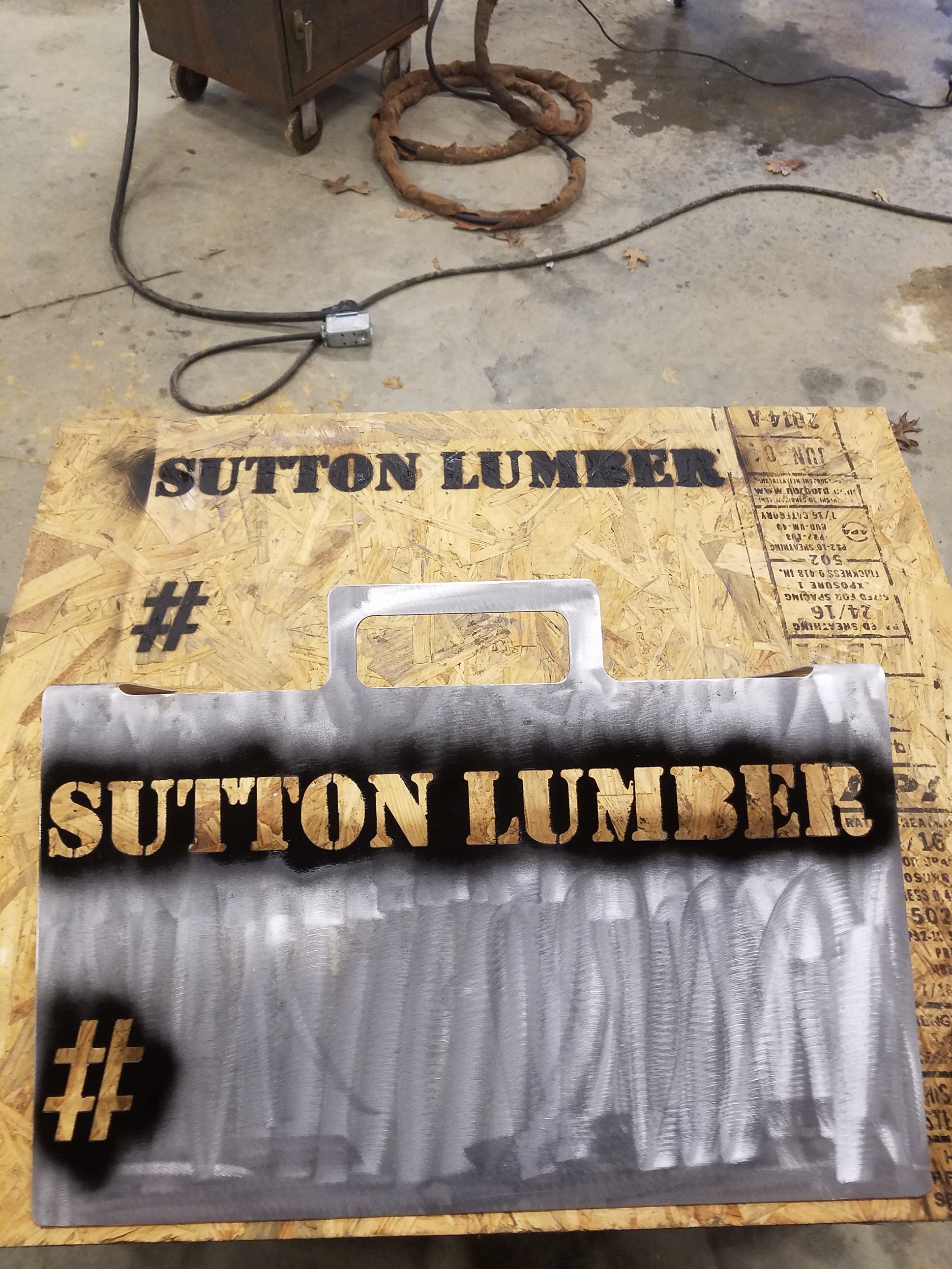

I made a stencil for a buddy of mine’s lumber yard to mark loads of banded lumber being shipped out the tabs on the letters are to fine and the centers want to break out anyone have any recommendations on stencil fonts?
I like flamante sten bold. At 3.5 inch letter height the tabs are roughly .25 inches wide.

What is the easiest way to import a new font into fusion 360?
Install it on your machine (in Windows you can use either the Font Manager or just double-click the font file - usually a ttf file). Once it’s on your machine it will be in the list of fonts in your Windows apps including Fusion. You don’t need to install anything in Fusion itself.
I have found a font that looks good but fusions not recognizing it as geometry when I try to program?
Hi, check out this thread that @langmuir-aksel put together. It should answer your question.
I done this and it says, could not retrieve the profiles of the selected text!
I’m using a font called American stencil maybe it’s just hard to work with? LOL
Hi JMM,
Are you saying that you are not able to find the font to use it to create text, or that you are able to create text using the font but cannot select it to use the ‘explode’ feature?
-Aksel
I can make text with it but It will not explode. It must just be that font cause I have changed fonts and it is working. I have been having alot of problems since fusion updated this last time, I’ve had to redraw a couple projects cause it would not recognizing plane ole lines as geometry.
That is an interesting problem. You’re probably right that it’s a problem with that specific font. Since the majority of downloadable fonts are either made on an individual basis or crowd-sourced, there isn’t really a standardization process to make sure they will be completely compatible with certain programs. I hope you are able to find a similar font you like!
-Aksel
I thought I had read somewhere about exploding text in f360. Something to do with the font file type. OTF and TTF, I think. One explodes easily because of how the splines are that make up the font and the other doesn’t explode and/or gives errors.
Might need to look more into this.
