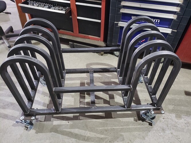

Hello! This is the small project i made today. A steel plate rack on caster wheel. There is 4 separators for differents thickness. The middle of the rack is accessible so i can use my gantry crane to lift them.
The base is made of 1-1/2" x 1/8" square tubes and the separators are made of 1-1/4" x 1/8" square tubes. The caster plate have been cut with the plasma table.
Great job on the rack, the larger radius bent tubes really make it.
Very cool design! I need to make something like this for my shop. Nice work!
