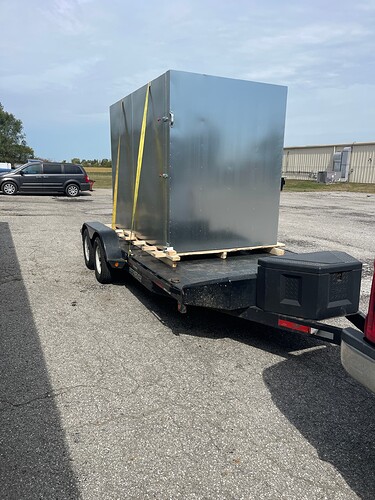

First I’ll start off by saying I bought an XR about 6 months ago. I said I was only going to cut stuff and never paint. Well that only lasted about 5 months. Here I am not only cutting stuff, but I started painting ( I hate to Paint!). Over Labor Day Weekend I built an 8’ tall 8’ wide 8’ deep DIY paint booth. Since I have the XR I cut the sides out of 16 ga and framed it with 2x4’s. I precut all the holes to mount the fans, and attach the sides to the wood framing. Although it works great for painting I was quickly over it. Last week I ordered an RC-2 Powder Coating gun with all the goodies, and I bought a 5’ wide 8’ deep 6’ tall oven. I picked the oven up Friday, and I’m working on rearranging my shop to get it moved in. Of course just like the plasma cutting, I have no clue what I’m getting myself into. I just went all in! I also ordered the harbor freight air dryer, to help with the plasma table and my new powder coating setup.

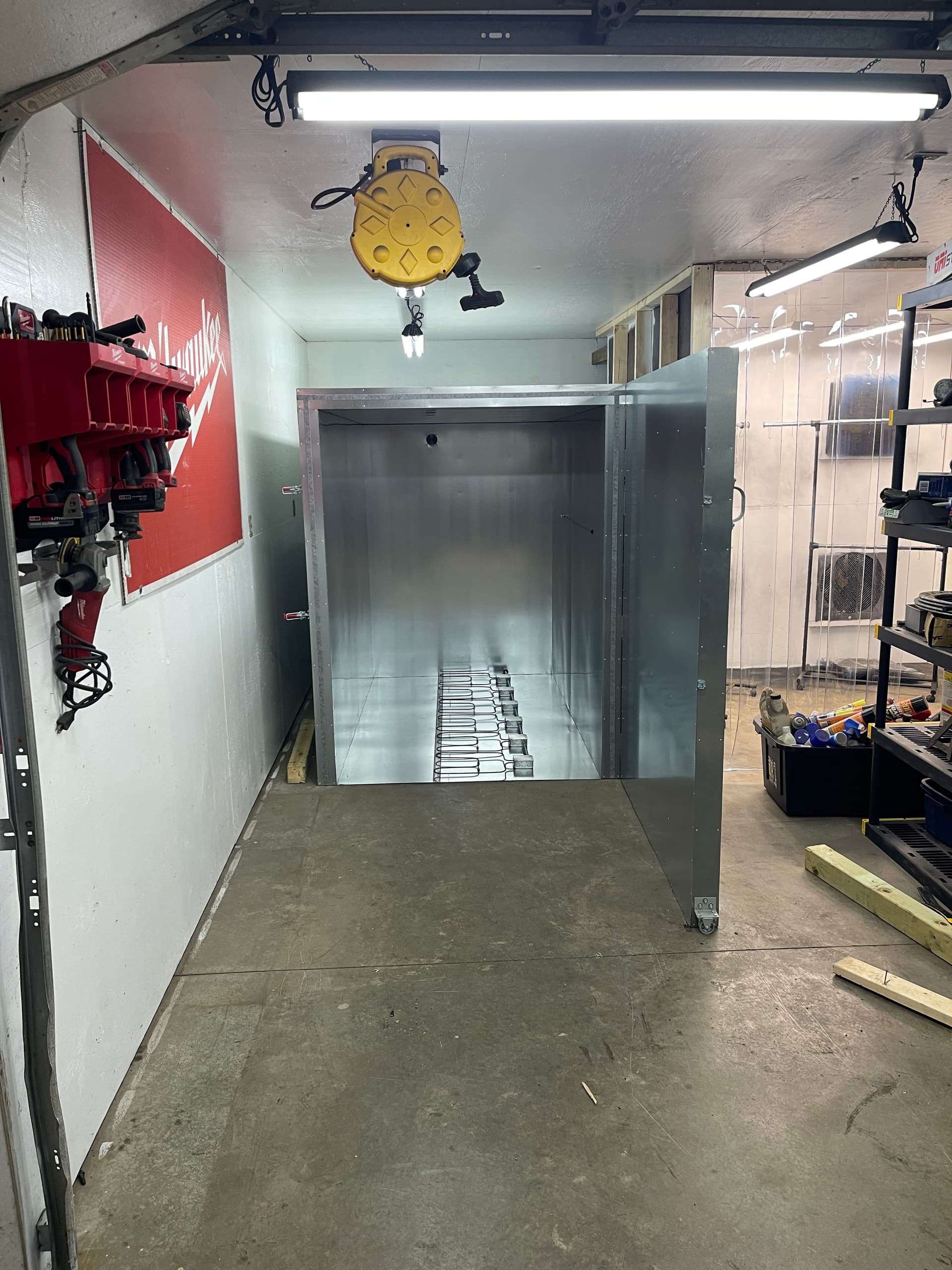

Nice set up, is that oven electric or gas?
How thick are the side walls?

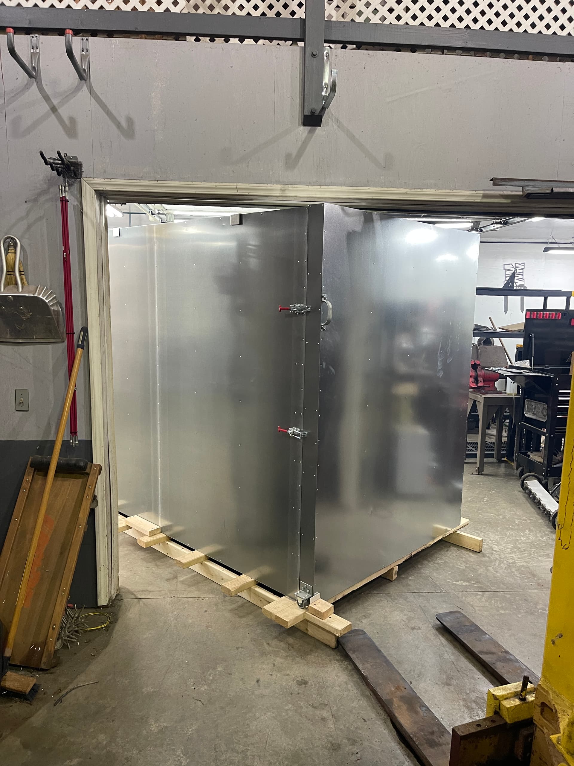

It was a tight fit, but I got it put in place.
I’ve seen right now powder coating, but I’ll go back and check them out again.
Oven is electric 240V, and has 3.75" walls

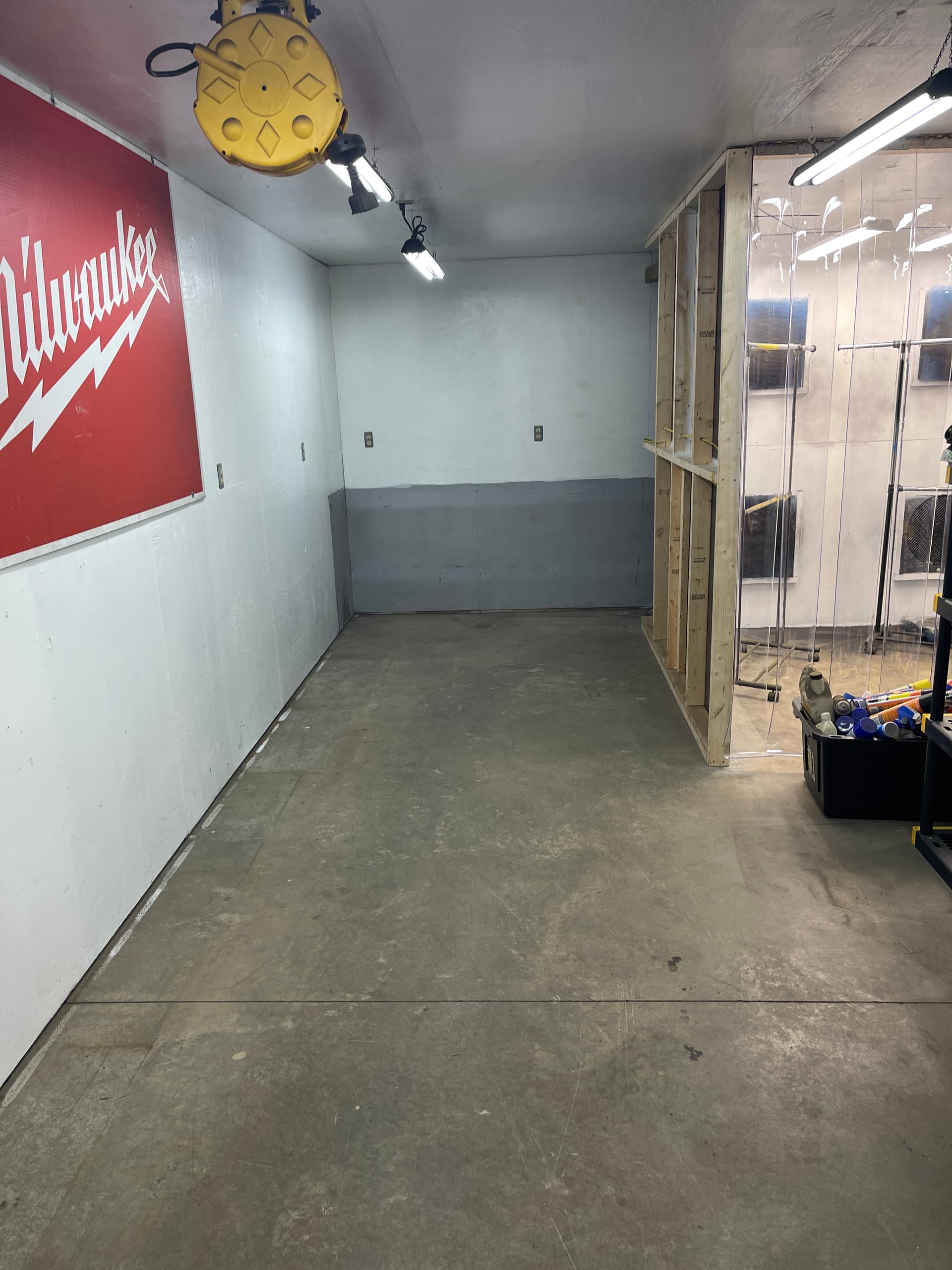

i have a 60’x60’ shop, but only part of it is temp controlled. I have a 15’x60 section that is temp controlled.

Cooper finishing made the oven. They are about 100 miles away from me. I like to shop local if I can, and it seems like good quality. The owner was really helpful as I had LOTS of questions.
Yes, building 2 racks to start off with. Once step at a time. I still need to get the oven wired, so I have a little bit of time to build the racks. Hoping to be powder coating something by this weekend.

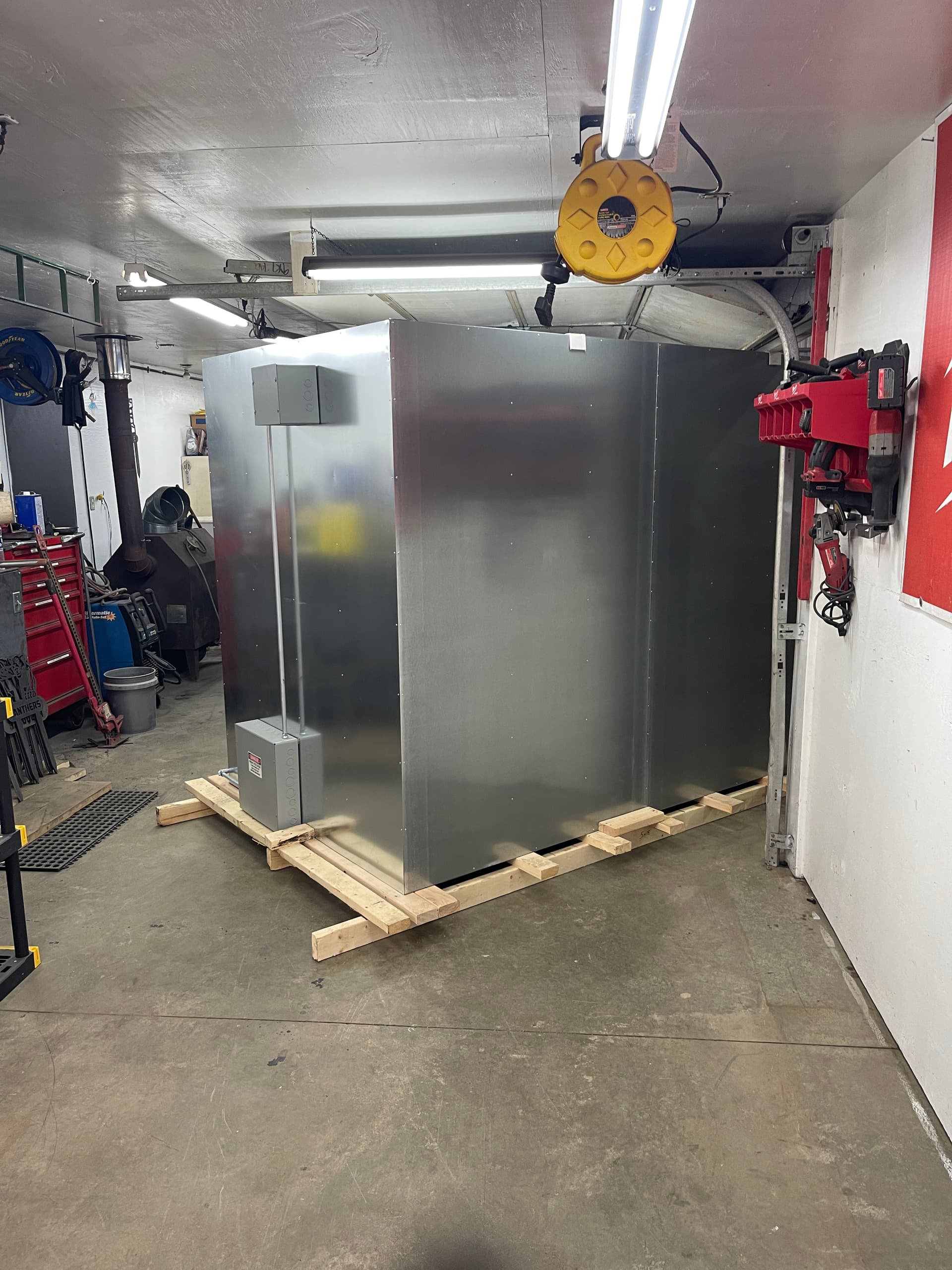

Wow what is the amp draw on that baby? 100 or more I bet
I bet close @Knick . Mine has 4 elements it is rated at 44 amps when running full throttle.
78 amps with the 6 heating elements

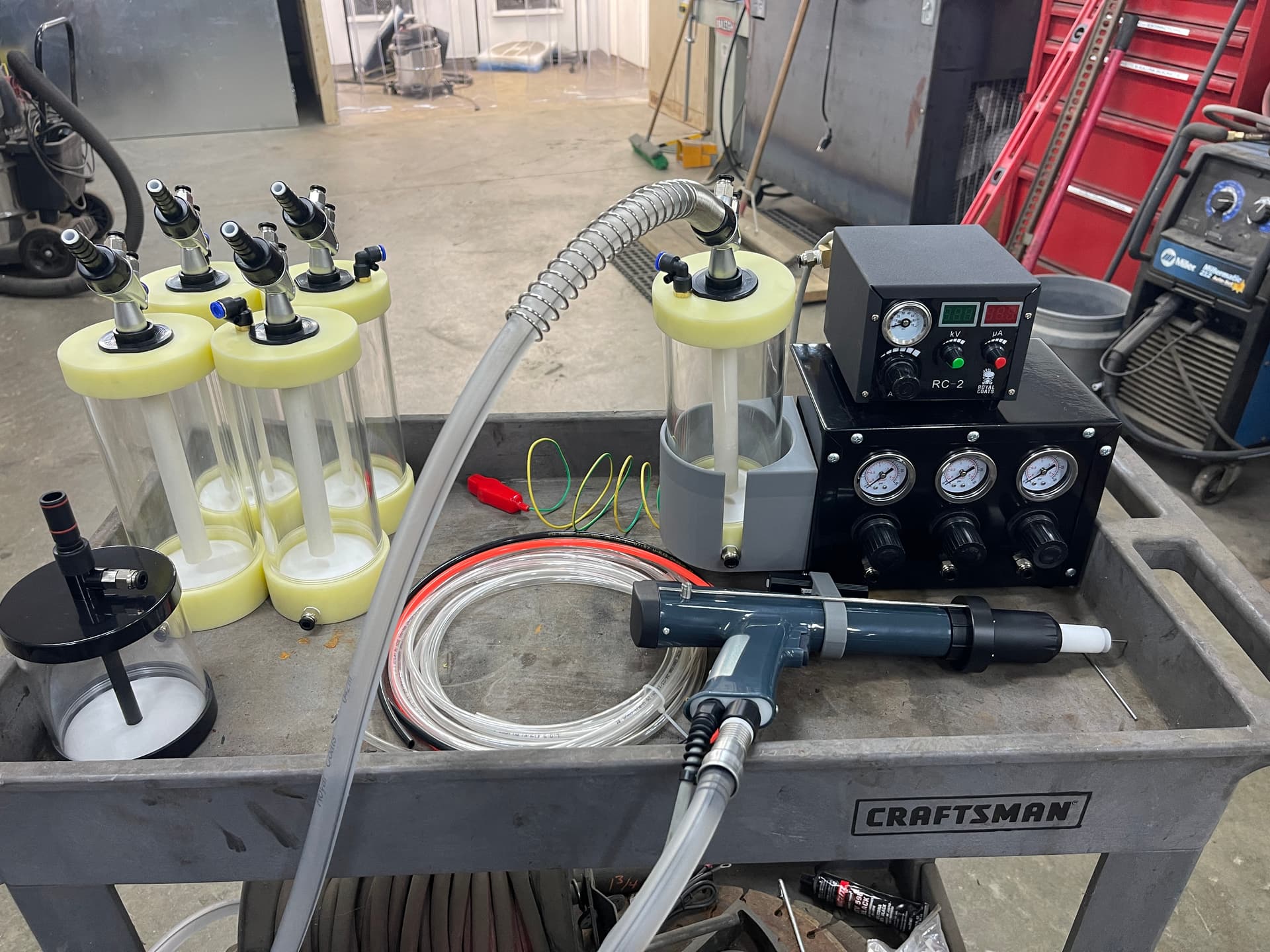

My RC-2 and all the goodies showed up yesterday, and I should be getting my first order from Prismatic Powder later today.
Just need to decide if I’m going to wire the oven, or if I’m going to call someone to come do it for me… I’m leaning on calling someone, I used to work for an electrical contractor and I think they can buy everything way cheaper than I can. I need about 100’ of 4 ga wire to power the oven. Then it needs ran in conduit, and bla bla bla might just hit the easy button and call them. I have enough other shit I need to get done so I can start my new adventure.
