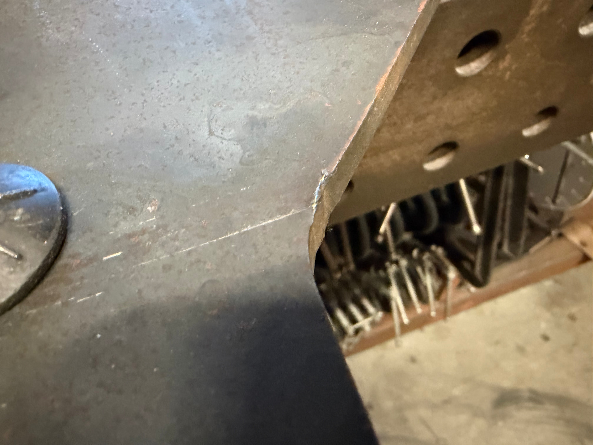

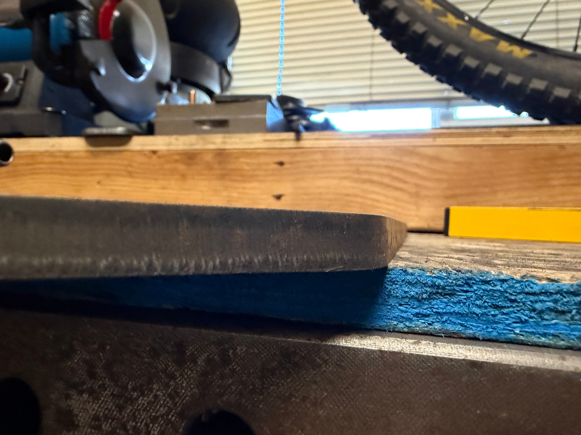

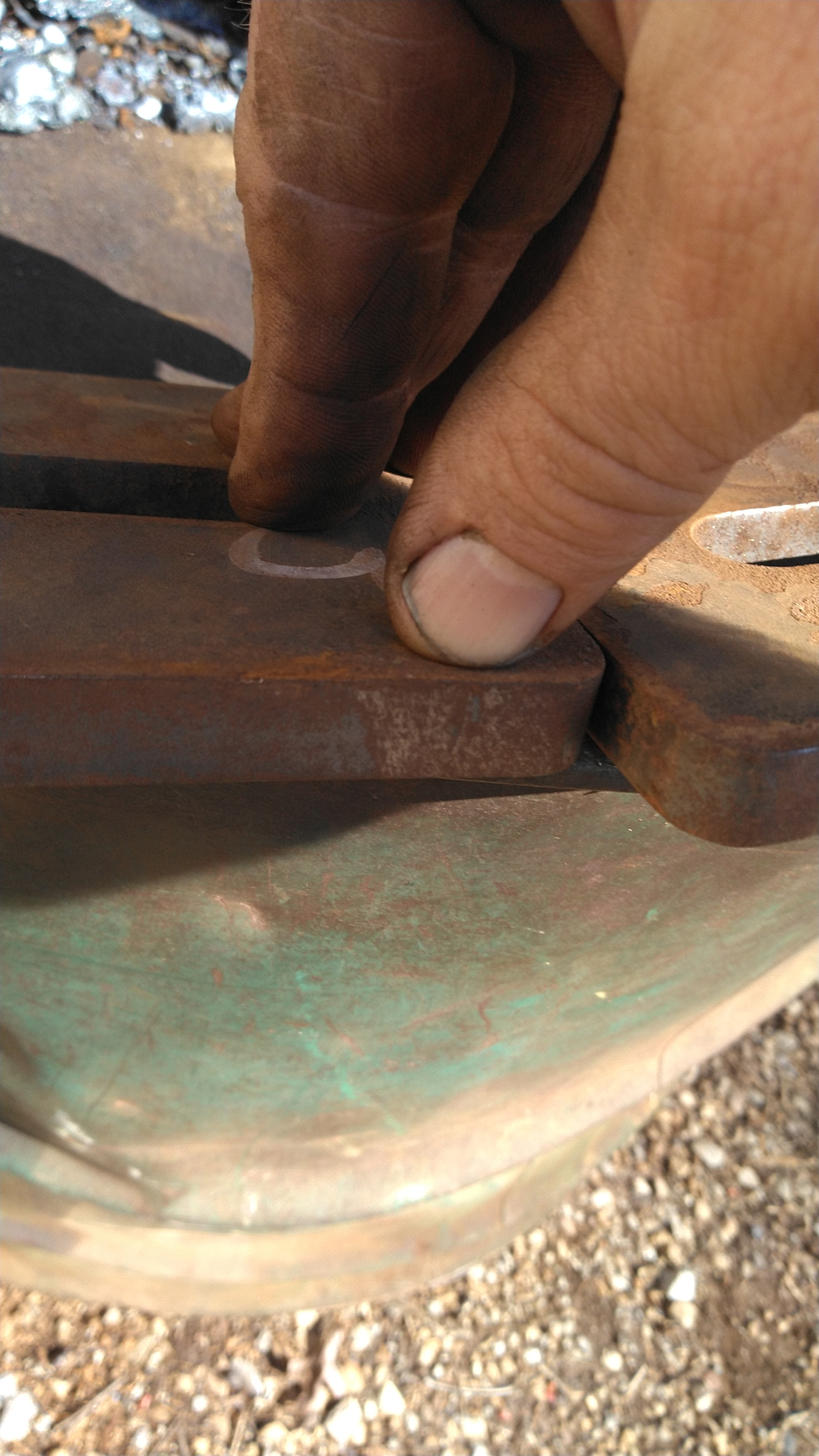

Here’s my lead in and out on 3/8 steel (AR500 but that’s not a factor). All I did was knock the dross off the back with another piece of metal, maybe wipe down the front.
Well…maybe leadin/out blemishes are inevitable in this game. As Phillip indicated, it’s nothing a grinder can’t fix.
Thanks for your help, and the pics, as they say “Misery loves company”.

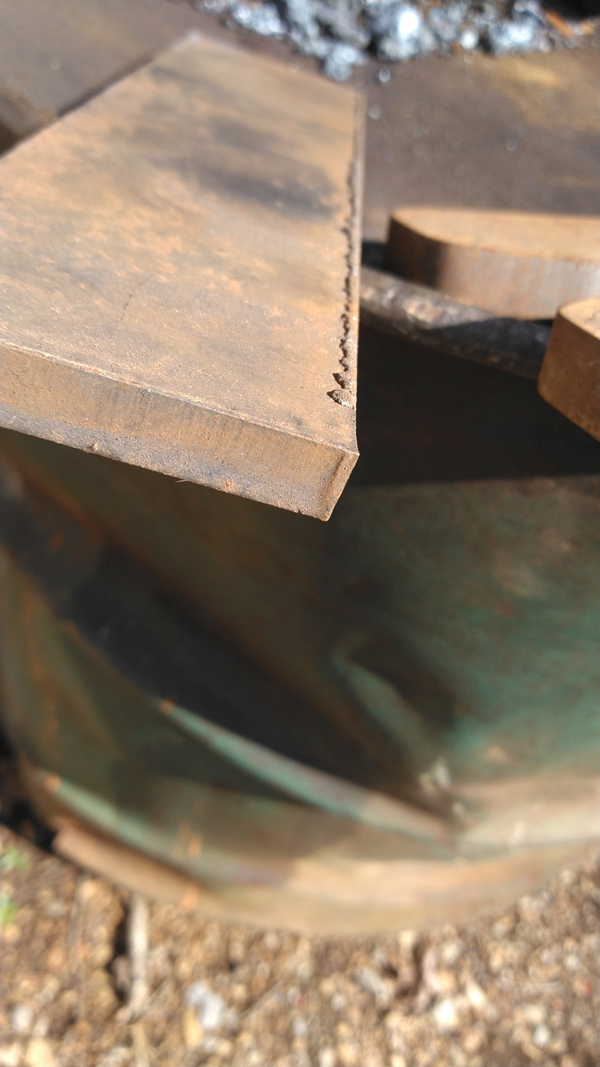

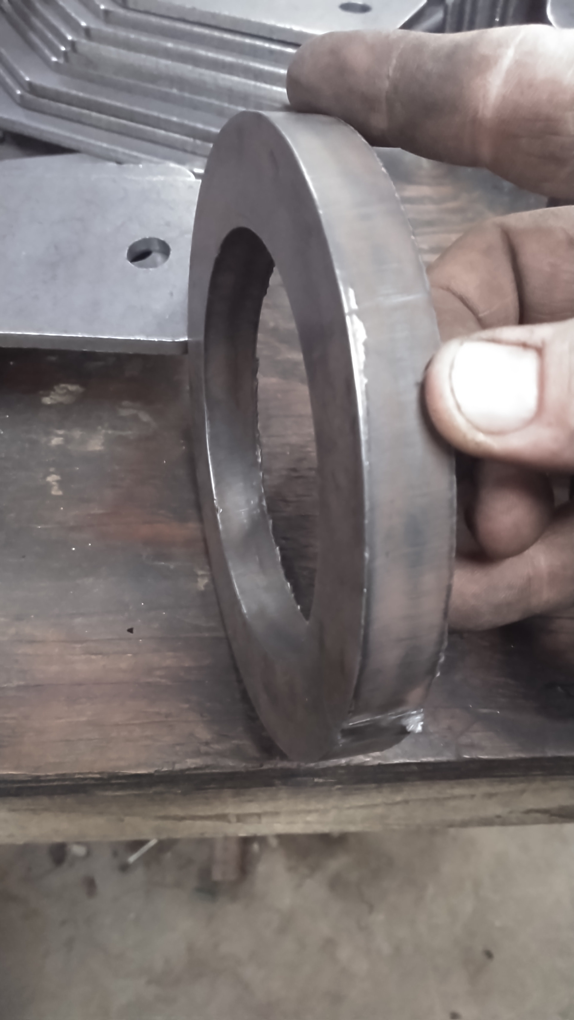

Here are some pictures for you . This one is some commercially cut 1/2 they have been around a while so it’s a little rusty.

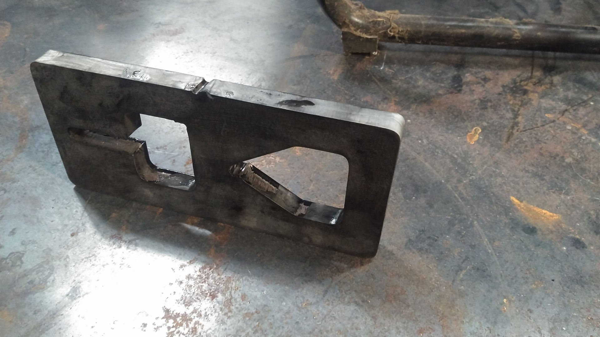

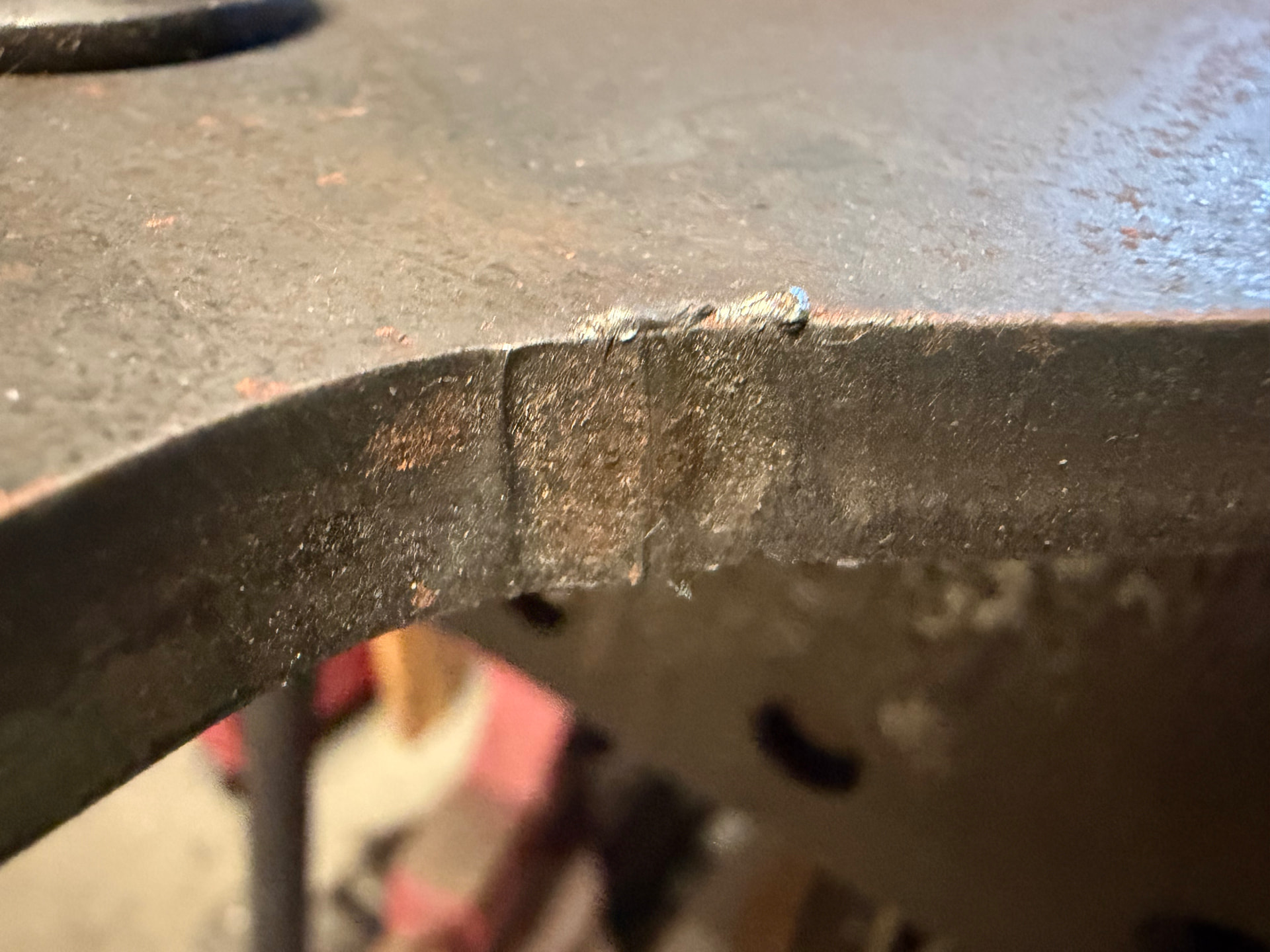

Here is some 3/8 I cut you can see sheetcam put the start in a corner.

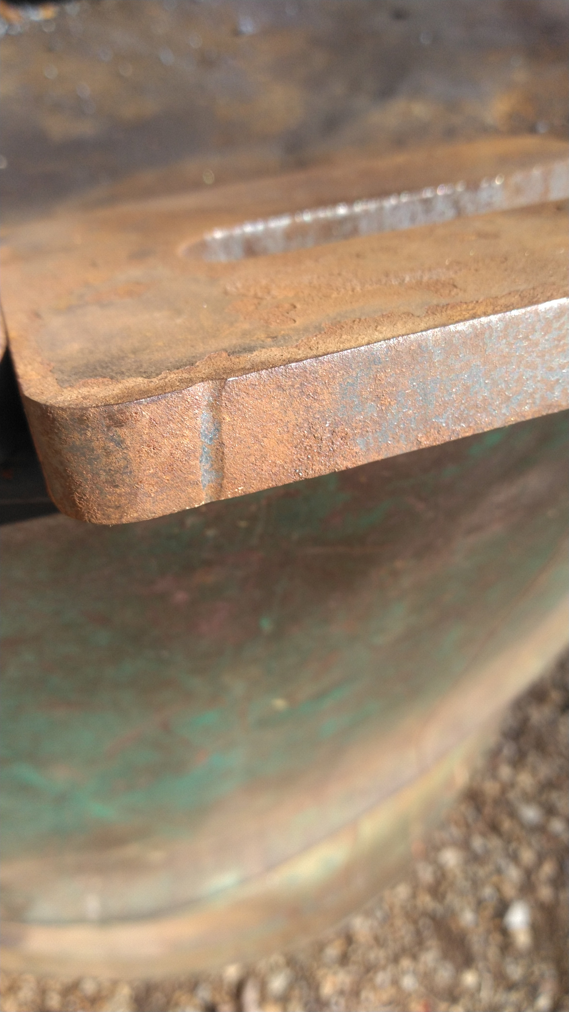

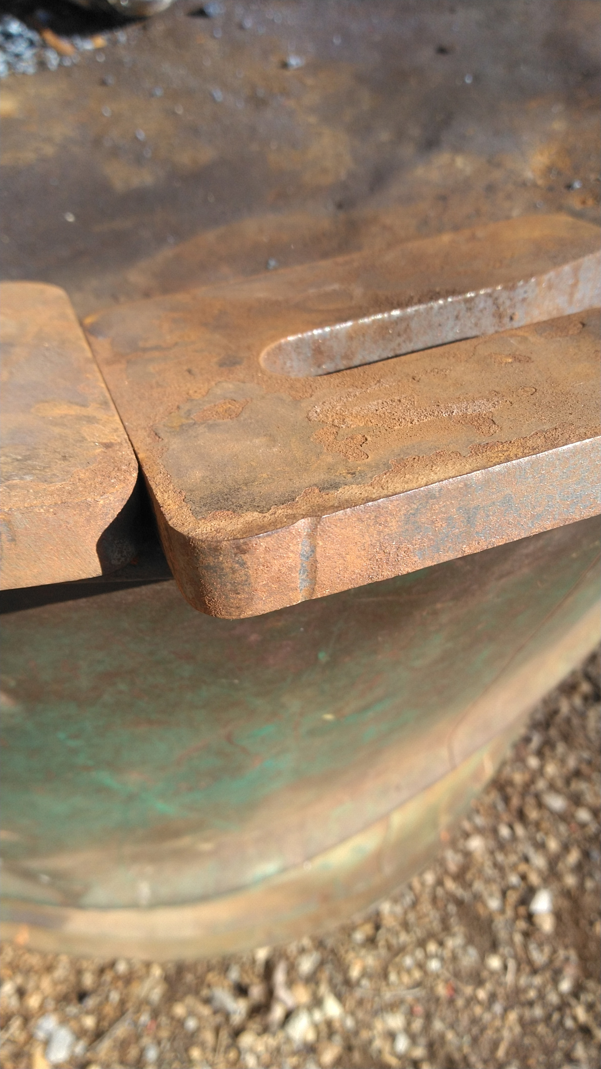

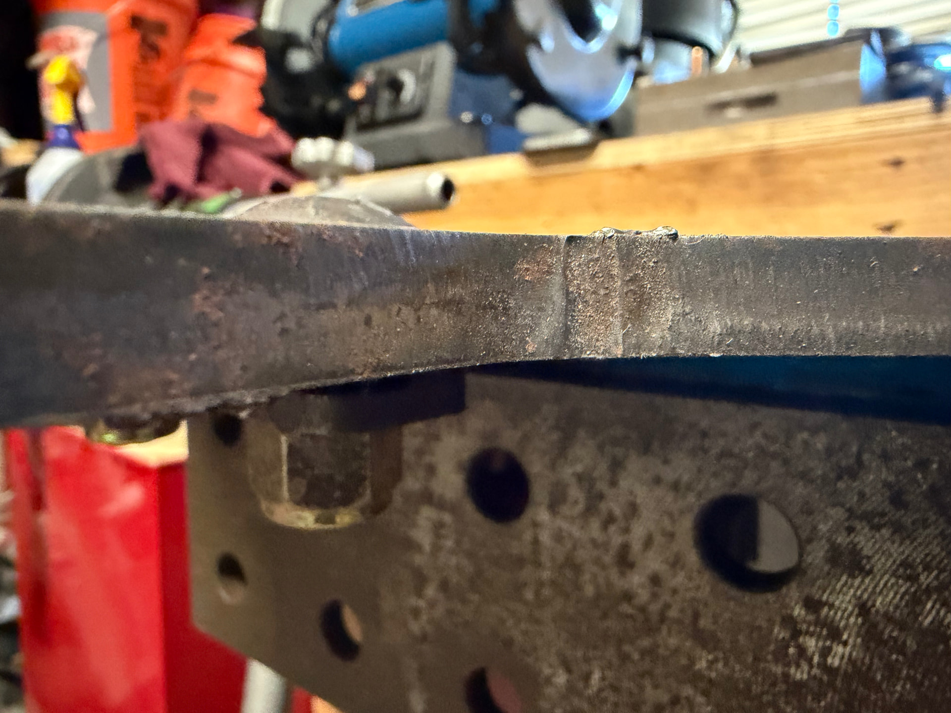

Here is a 1/2 I did with the mistake of cutting on the line. I forgot to change the settings on this one. The second is some 5/8.
