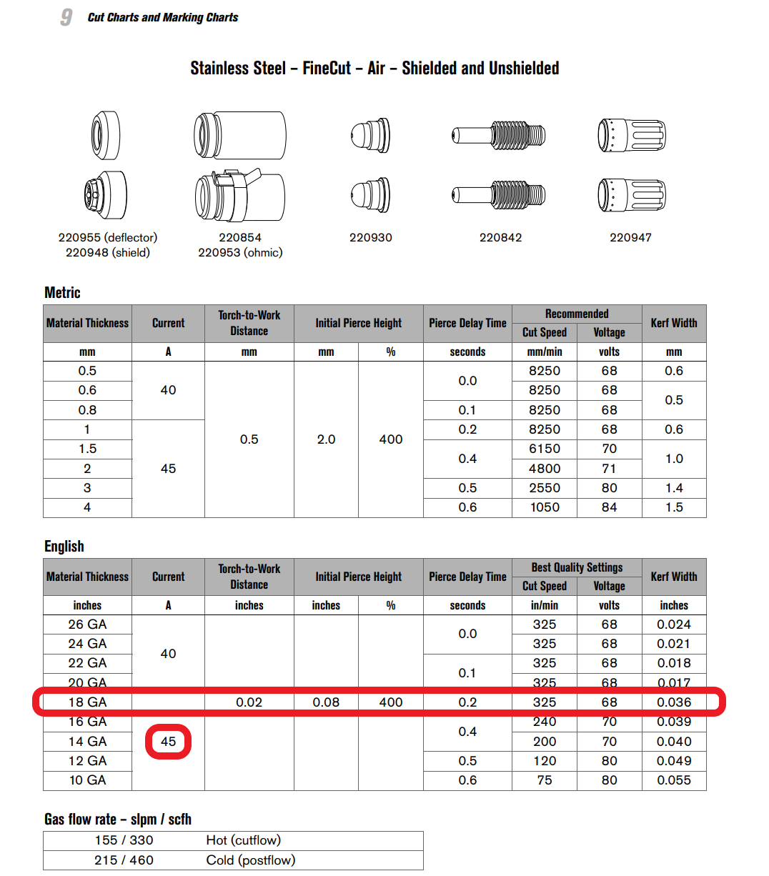

I’m using a standard Crossfire with a Hypertherm XP45, straight air, super dry (intercooler on compressor, 4 different water traps, desiccant drier right before the plasma cutter). I’m using fine cut consumables on the XP.
I’m cutting a lot of 18G 304 stainless with anywhere between 9 and 11 pierces per piece. These are small pieces with a fair amount of detail so using the fine cut consumables.
I feel I’m still getting a bit too much dross on the underside, I’d like to reduce that if possible.
I’m running 225 fpm on these parts at 40 amps.
Realistically how much run time and pierce count can I expect from an electrode and nozzle?
There is a noticeable increase in edge jags and dross when I hit about 500 pierces. Total torch time is around 23 min or so for 600 pierces .

What cut height are you running ?
Did you come up with these parameters with experimentation?

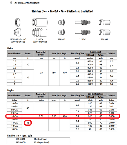

Have you tried using the cut charts in the manual?
take note that the cut height of stainless is 1/3 that of standard cut height and that the Pierce height is 1/2
running a higher then recommended cut height will always reduce consumable life.

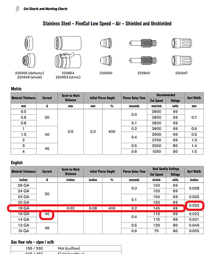

I’m running much closer to the second SS chart than the first. I think I’ll try the first set even though it’s half the speed. I’d rather that the cut time be longer than have to do all the clean up afterward. After looking at the way I have the “tool” set up in Sheetcam, it looks like somewhere along the way some of my settings got changed.
Good info on the cut and pierce height differences for SS regular mild steel.

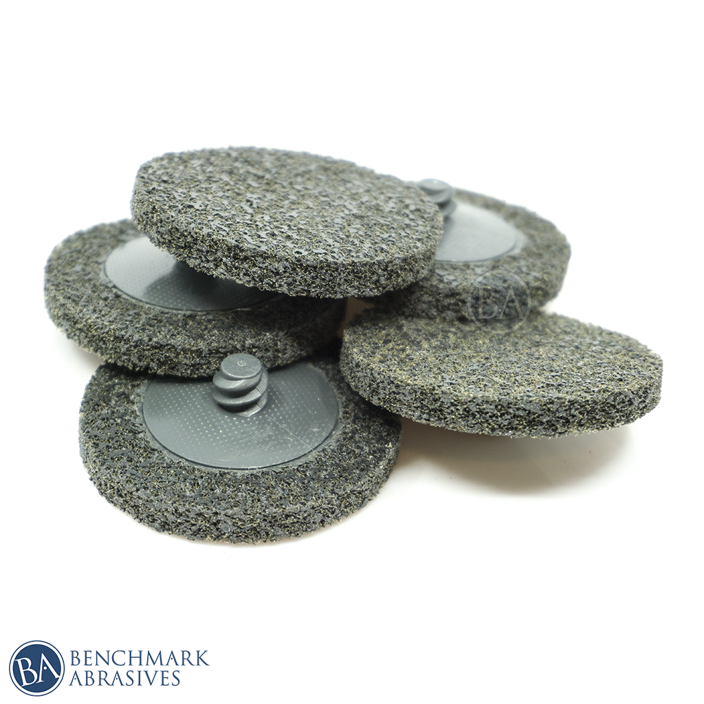

Ensure your water table is chock full and as close to submerging your work piece as possible. I’ve personally found (I cut a bunch of 10ga for the crosses I make) that the dross is just part of the game if you’re cutting with air. Get a GOOD set of files and some soft jaws for your vise for cleanup. There are some angle grinder wheels that do a good-ish job of knocking the dross off, but they burn up pretty quickly.

Thanks for the tips Tin, I redid my “tool” for 18G SS in Sheetcam using .08 for pierce and .02 for the cut. I also had to increase the pierce delay to .8 to keep from timing out.
I dropped the feed to 145 as suggested and have the torch set to 40 amps. Man what a difference that made. Even using a nozzle and electrode that have over 700 pierces on them the cut quality was better than anything I’d had before. A new electrode and nozzle made it even better. I’m using a clamping device I cobbled together and Benchmark Abrasives 60 grit ceramic flap wheels to do the final clean up and put a nice brushed finish on them.
The edges are fine right off the table, no jaggies anymore.

apynck3l, thanks for the tips, I always run the table as full as I can. Even made up some Alu shields to keep the water in the table! I’m going to check into the sanding discs from Benchmark, they look like good ones to have on hand. As mentioned above I already use their flap discs. Good company to work with.
