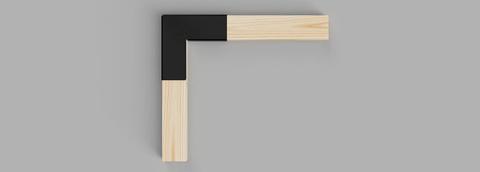

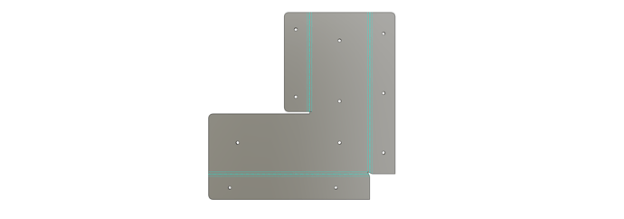

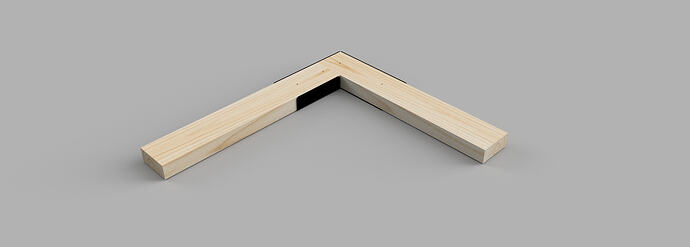

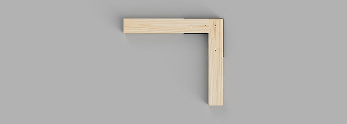

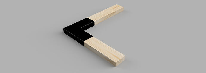

To get things started I’ll post a example project.

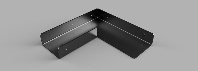

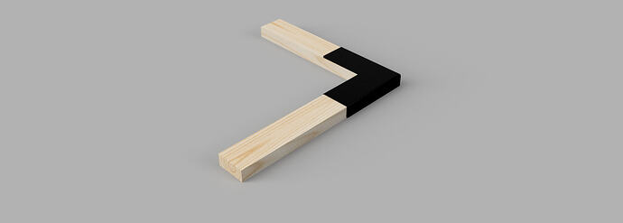

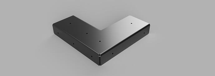

This is a eighth inch bracket to square a corner between 2 by 4 and give it a solid connection and keep it from Raking.
EXAMPLE PROJECT SPRING SUMMER 2026.f3d (331.1 KB)
EXAMPLE PROJECT SPRING SUMMER 2026 FLAT DXF.dxf (5.5 KB)
Next time I’m out cutting out the machine I’ll make one of these and then bend it on the titan to see if it actually works. That one inside bend might crash but it’s worth giving it a try.

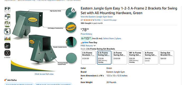

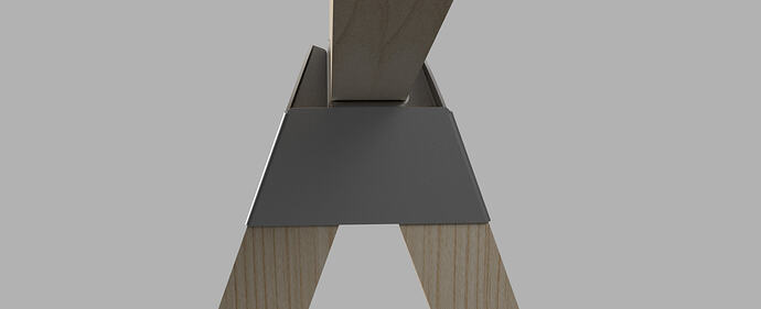

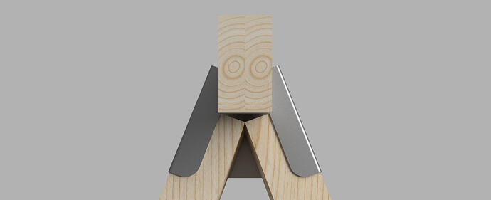

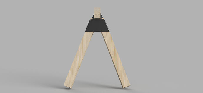

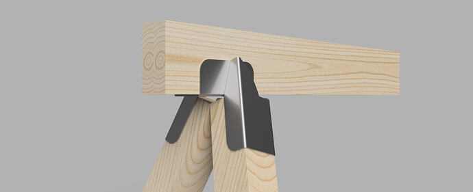

I am submitting this as a demonstration piece and not a part of this project since I used it on another contest. This is my version of a swingset bracket that is very sturdy and worked well for many years for the daughter’s children. They relocated the swings a dozen times without disassembling. Lag bolts were used vs bolts.
On my version, I plan for the use of bolts that will extend all the way thru the brackets and timbers to sandwich the timber.
You will need to bend the metal and you will need to weld the ‘gusset’ part to the ‘beam’ pieces.
Each beam bracket will require five (5) 3/8” x 4” bolts, nuts and lock washers. Double the quantity for the two ends.
Each leg will require three (3) 3/8” x 4-1/2” bolts nuts and lock washer. (Four legs will require twelve of each.)
To save money, I designed the top beam to be two 2x6’s sandwiched together. I have found that this is certainly as strong and perhaps stronger than a single 4x6 since the two pieces can correct for each other’s flaws.
One last instruction: It might be very difficult to get the gusset part to bend the final bends. Use a spare piece of 4x4, clamp securely and gently beat with a 2 pound mallet. It is not imperative that it is perfect because you will be satisfying the strength with the bolts that go thru and clamps the post between the metal. The best way to get the holes to meet up is to drill 1/2 way from one side and then the other. Once the drill finds the previous hole, that will be the path of least resistance and the bit will try to follow it.
Note: I have NOT used this bracket. I only designed it after I bought the other bracket. I designed it with 1/8” mild steel to be used but I believe 10 gauge would be fine. I believe the brackets I purchased were closer to 12 gauge.
Here is the original bracket and listing:
https://a.co/d/03trBVBa
Here is my version:
SwingSetBracket.f3d (1.4 MB)
SwingSetFlatPanels.f3z (2.1 MB)

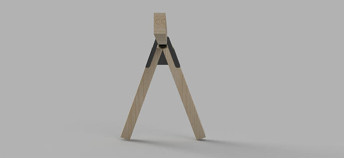

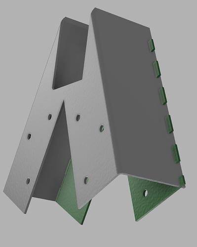

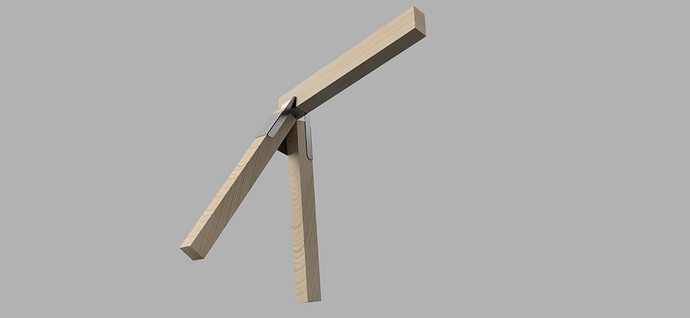

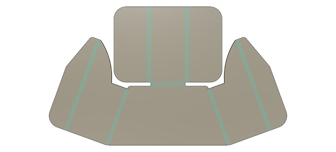

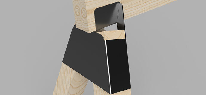

I took a stab at this swing bracket. I also tried to do it in one piece.
I’m not sure if you could actually bend it up on the Titan in reality without it crashing? but maybe.
swing bracket.f3d (680.0 KB)
Very creative making that work all in one piece. I would be interested to see one completed.
Very clever. I wonder who we know that might happen to have such a device…this “Titan" that ye refer to.
Sounds like a mythical beast! :wink:
I think you need two of them… :thinking:
looks like legs could fold outward to me. But remember its me saying this :face_with_monocle:

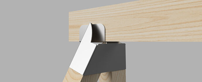

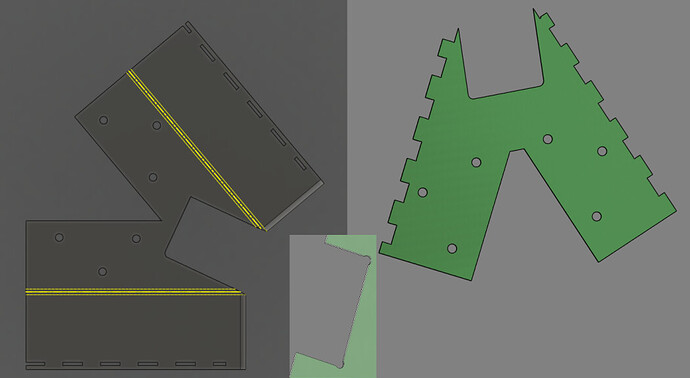

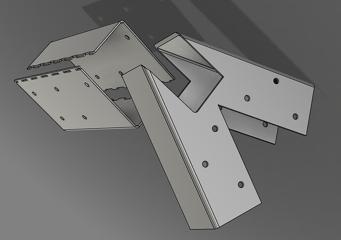

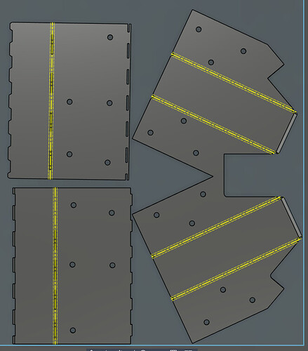

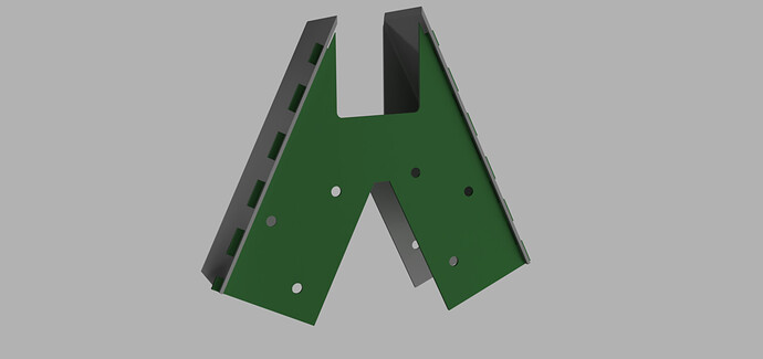

So I have revisited my bracket. I don’t like how difficult it would require for precise bending/braking.
And it doesn’t really add to the strength.
It is now in two pieces. All of the edges of the slot joints have dogbones. (Note: I did not recreate the beam pieces in this file so they would need to be grabbed from the other file. If there is any interest, I would combine them. As it is, I see this as an “exploration of ideas.”)
Swingset gusset 2 piece.f3z (2.3 MB)
Note: In this example, once installed with the timbers, you could pound down the tabs to secure the bracket pieces together for added security.

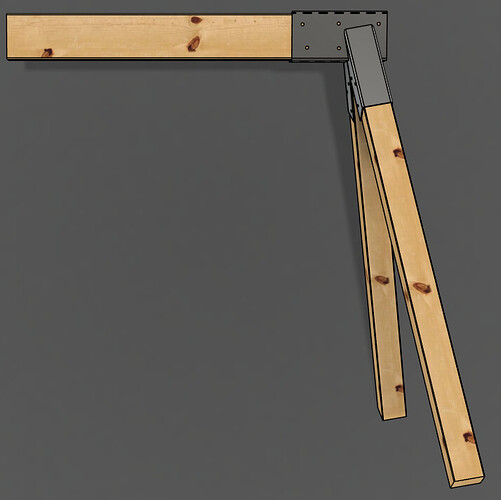

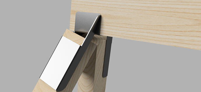

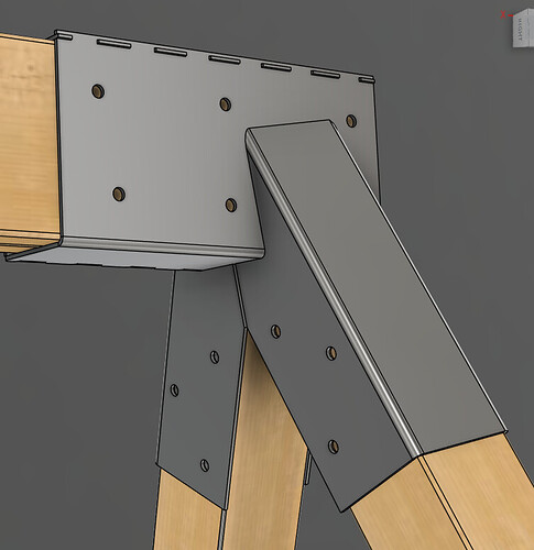

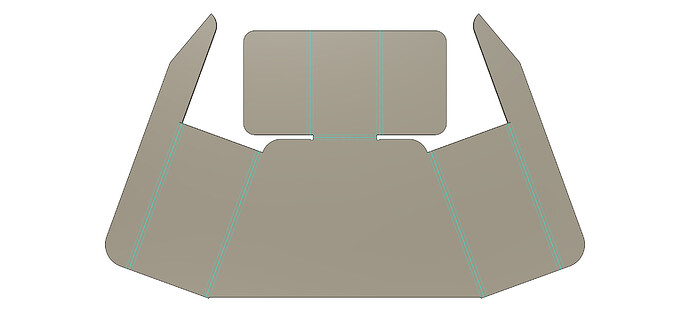

To relieve @Knick concerns I took another stab at the one piece design. :rofl: We need to get @72Pony to weigh in, he’s our structural guy.:building_construction:
Here’s one piece version 2. Depending on the bend order this may or may not be doable.
swing bracket NEW VERSION 1 PIECE.f3d (954.7 KB)
