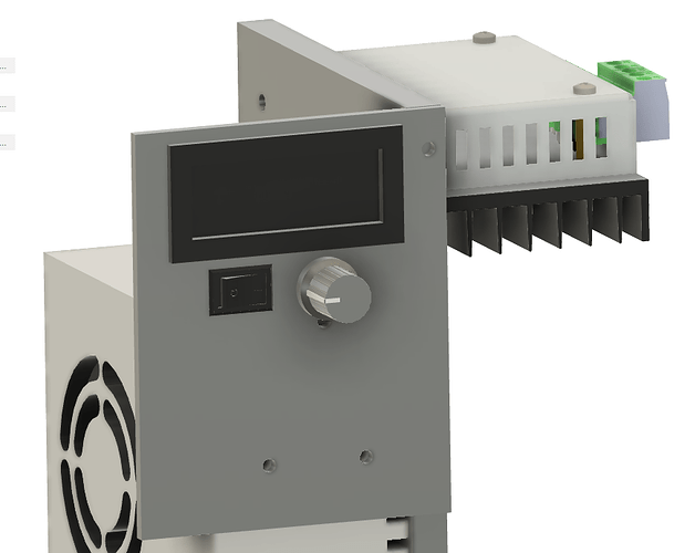

I like F360 because it is SOOOOOO easy to make assemblies where you design NEW parts to mate with existing ones. My process is to design (acquire) models for parts that I need to mate to and then build my new part around it.
Here is a simple example. I’m adding a BLDC Spindle to my CNC Router and needed to mount the parts on the frame. I was able to find most of the pieces online (GrabCad) and the rest were easy to make. I moved the existing parts around so that I could have one mounting board and one ‘panel’ for the display and speed control, shown with the blue arrows. Those were simple once I had the other pieces in place and could ‘Project’ the existing parts on to the new parts’ sketches.

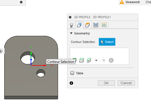

So here is an example.
I can make basic stuff and I know know a little about the “fillet” tool, and a few others.
How do I turn the "circle’ into a “hole”?
Here is a screen-shot
You need to make a body by extruding. Once you do your drawing. Press “e” for the hotkey to open the extrude dialog. Then you click on your drawing and you will see the circle now represents a “hole.”
Now I press “e”. This dialog box pops up:
When the mouse hovers over the drawing, the profile is showing itself. Left click and it will be selected:
To really see what is happening, you need to move it in 3D space. Hold down the [shift][middle mouse button], now move the mouse and you will see the arrow showing the extrusion. Pull on the arrow or type in a value for your extrusion, like “0.25”
Now you have a body with holes:

Let’s take this into Manufacturing. I click on the large menu button that has “DESIGN” showing and pick “MANUFACTURING” from the drop down list:
Now I click on Setup:
Now you make a toolpath:
I will gloss over the tool library and pick a tool (you will want to watch a video on making tools). For this demonstration I am just trying to show you how quickly you can get to a gcode for FireControl.
I pick a tool:
Now I move to the 2nd tab of the tool path:
I hover over the body and click to select.
Click:
Now in my case, I am confident of all the other tabs having what I expect to get a successful gcode so I click “OK”. You will notice how the holes are cut on the inside and the body is cut on the outside. That is the beauty of using a ‘body’ in the manufacturing environment: Fusion will automatically know what is inside and outside cuts.
I go to post processing. Again, I am simplifying so don’t get bogged down in the detail yet:
By selecting:
Now the post processing screen pops up. I verify my numbers and that my post processor is correct. I press okay. And it generates the g-code (xxx.nc) file for FireControl. Ready to go to the plasma table.
