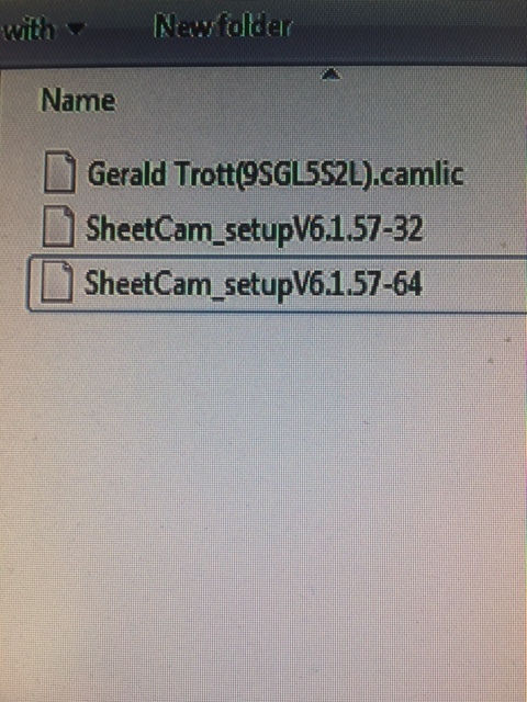

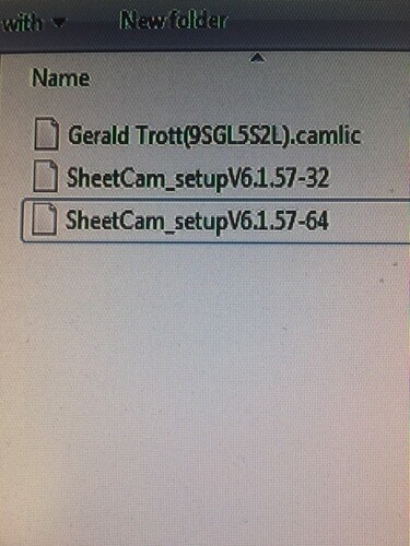

i am having a problem installing sheet cam it will not install at all it kicks out and from what i see it is not a exe program
A screen shot or more descriptive explanation would give someone the info to help you.
i get a note from the computer that says what program do you want to use to start the program
And what is the exact name of the program you are trying to run?
sheetcam_setupv6.1.57-64 and the licence number

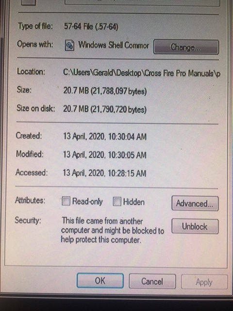

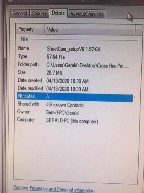

what is the file extension? Right click on it and look at properties. Also, what is the filesize?
there is none
i trying adding one but it did not work

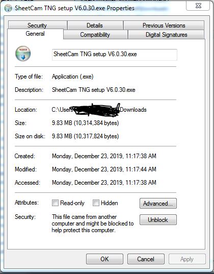

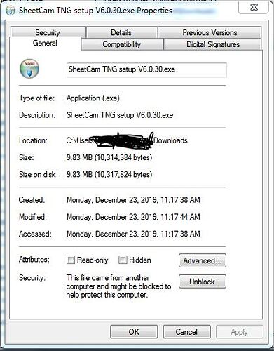

One more try… right click on the file and look at properties. It should look something like this:
are you running a windows 10 computer? if so, you need to download the version SheetCam TNG V6.0.30
the one you’re trying to install is for linux.
you got the wrong version as i stated above.
